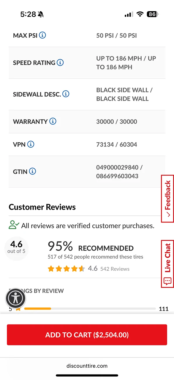

Yes, thank you for the clarification. So I decided I should look at my Cup 2s and see if they have the Michelin MPSN on them somewhere. Using the Michelin site, the list of Cup2s looks like the below. Assuming FOR means Ford, my fronts should have 49942 on them somewhere. If they do, I couldn't find it.
I looked them up on Discount Tire, try searching the VPN’s (vendor part number). The GTIN is the global numbers
awesome, thanks! I did manage to find the fronts on BJs site, I missed it in my search because I, or they have the speed rating wrong.
but I’m convinced the rears aren’t there. They are about $100 cheaper than TR with the rears they do sell, and they include installation. BUT, I haven’t looked into whether they have equipment for the job that I’m comfortable with.

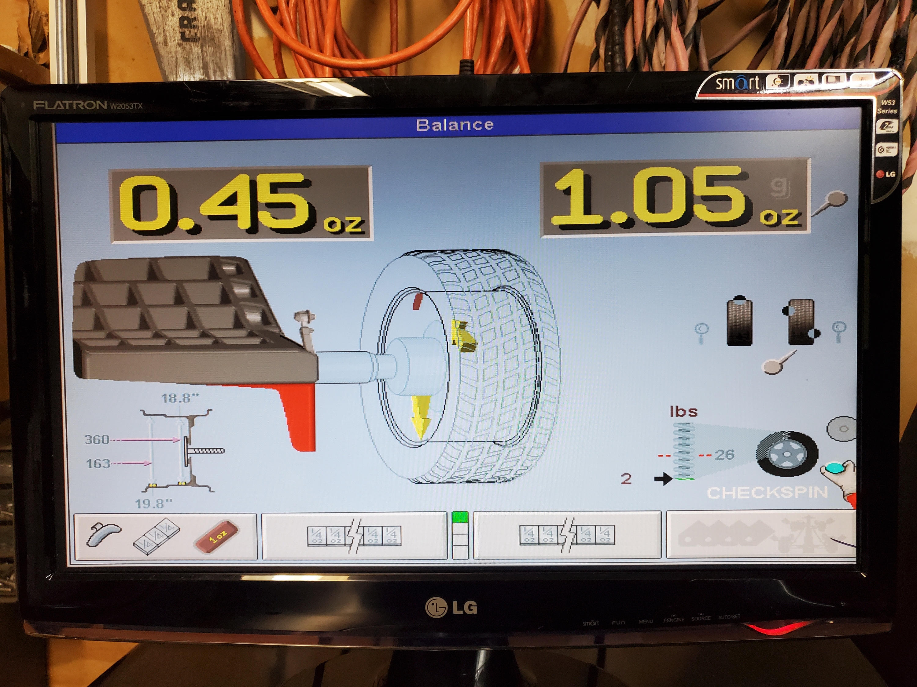

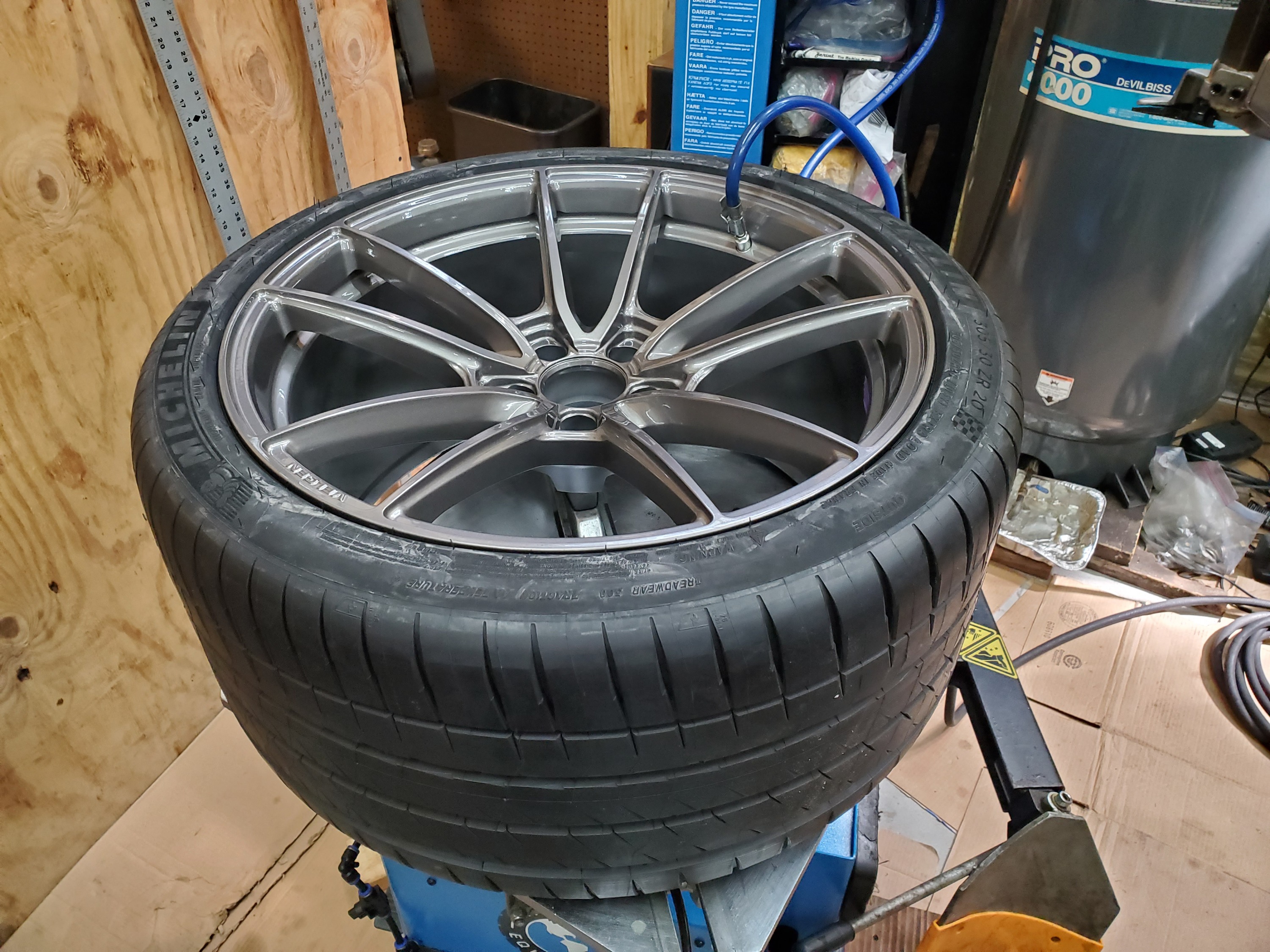

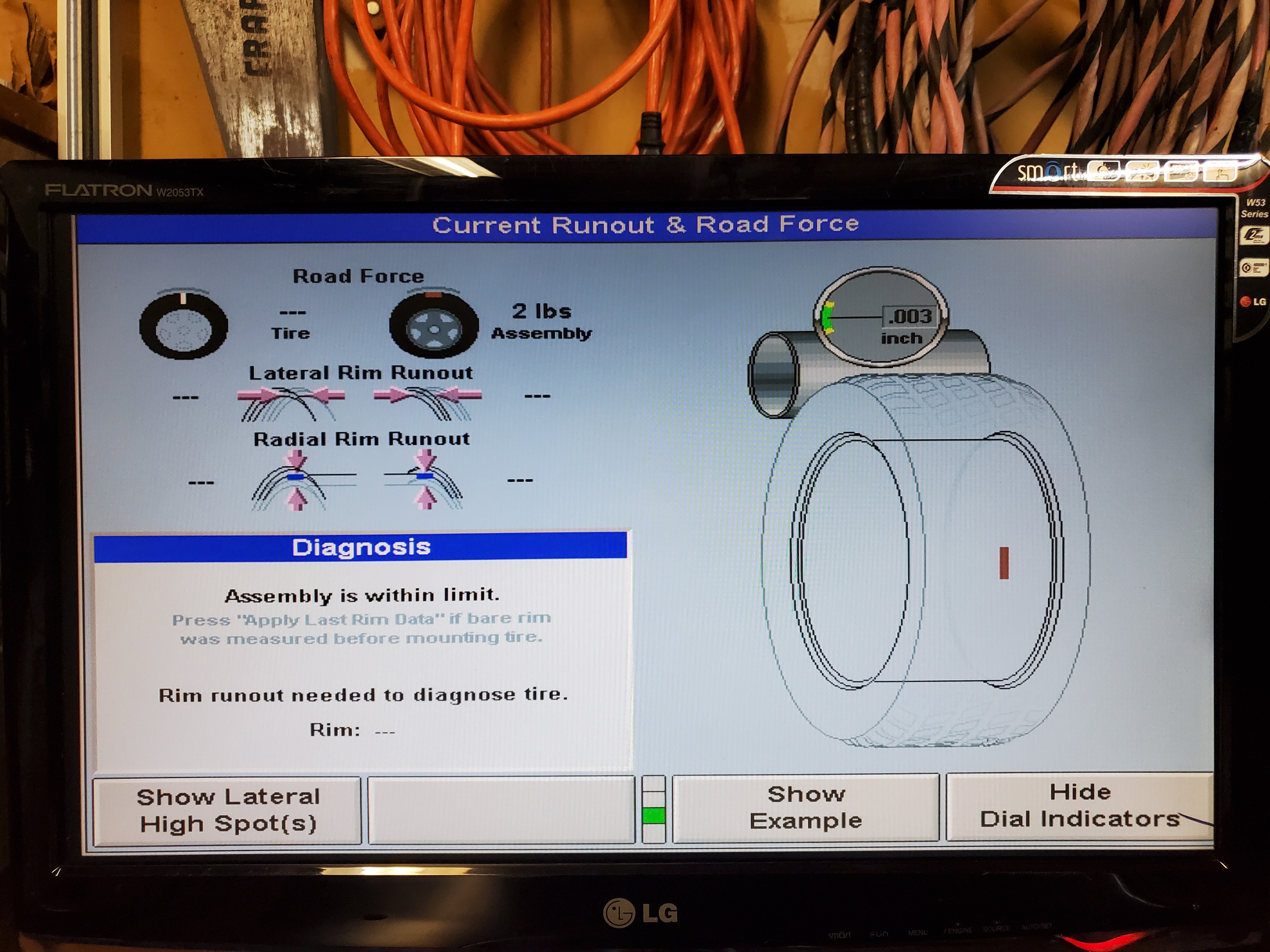

Not sure if I should start a new thread...
Is road force balancing important for 4S or Cup 2s?
BJs doesn't do it, and they don't have an appropriate machine to mount tires on CF rims.
I'm going through TR's certified installers now, only a few of those have RF balancers, and few have an appropriate mounting machine, I only found one so far that has both.
I have my own RF balancer. The 4S's that I have gotten for multiple different vehicles, have been the most perfect (construction-wise) perf tires I have ever had, in balancing and RF numbers. I'm not sure I would worry too much with those.
Here is a 305, 4S I recently put on some Velgens for the street.
2, is an ultra low number for "road force".
I like 10 or less for high perf tires and 15 max.
Even tire runout, was an insane 3 thousands.
