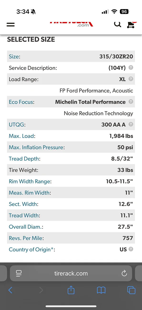

I’ll get you the P/N in a second but I have an old screenshot of the FP Michelin’s from TireRack

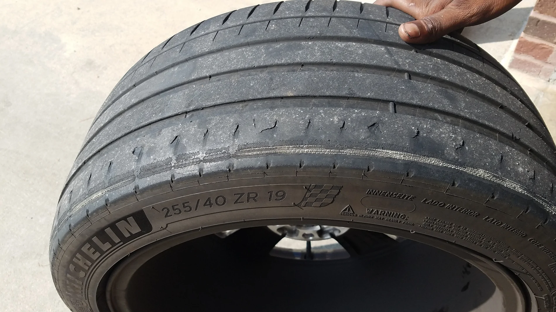

I think this explains it perfectly. I have a 2019 Bullitt which is essentially a GT w/ the PP1 package. It's seen zero track time, the suspension is completely stock and the alignment was verified to be factory specs after I got new tires. Here's what both of my font tires looked like at 19k miles.

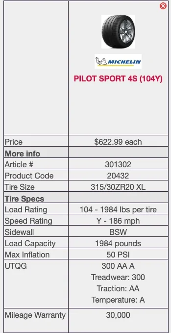

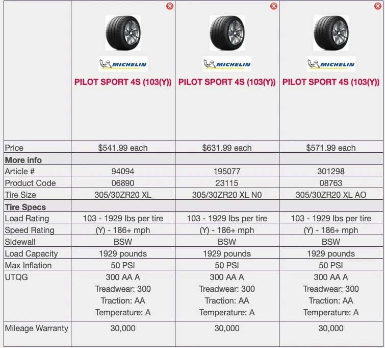

I eventually figured that out as well. But I don't see where TireRack reveals the Michelin codes for the tires. Which is good for them I guess, because I want to figure out how to shop around.
Last set of tires for my F150, BJ's actually had the best pricing. They show 3 different 4S tires (Fronts) on their website, they include the Michelin codes, but the 3 they have don't match what I think are the codes for the Ford bespoke tire.
The one rear they have doesn't match either.
Wow, that's crazy given the you had it at factory specs.

He’s trying to confirm the Michelin part number. The TireRack links I sent him don’t have the Michelin P/N’s on them. Not sure if you know them or can see them on your tires

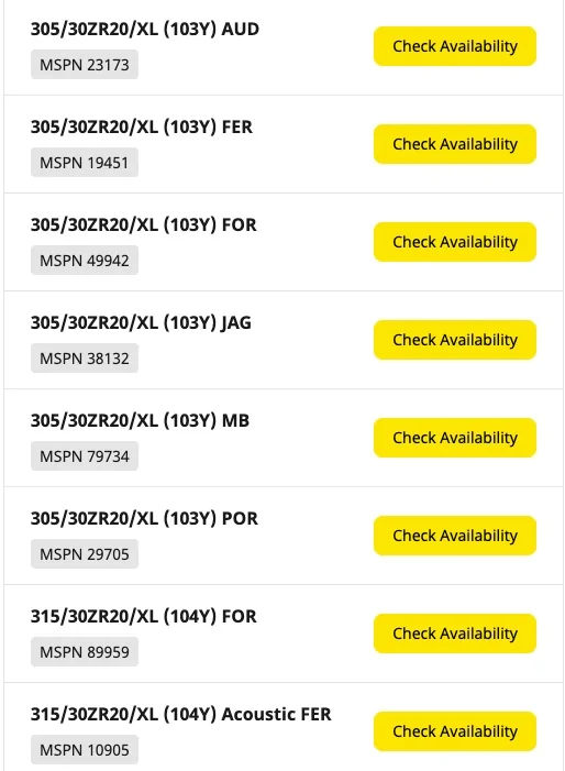

Yes, thank you for the clarification. So I decided I should look at my Cup 2s and see if they have the Michelin MPSN on them somewhere. Using the Michelin site, the list of Cup2s looks like the below. Assuming FOR means Ford, my fronts should have 49942 on them somewhere. If they do, I couldn't find it.
