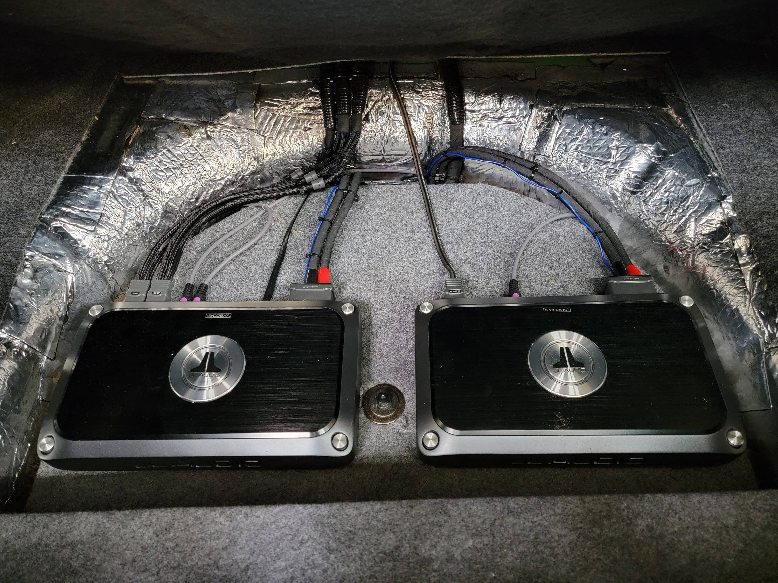

This is what happens when you start wanting the B&O system to sound great :)
Hey! Have you got a thread or some pics of your install? I’d love to see how it all turned out. Looks like those components would be excellent ingredients for an epic soun d system :muscle:

James
Hi, it is buried somewhere in the Infortainment threat. I got a lot of my ideas from Evolv, Stang, Cathul. Amps are mounted in the spare tire well. Let me see if I can find pictures.
