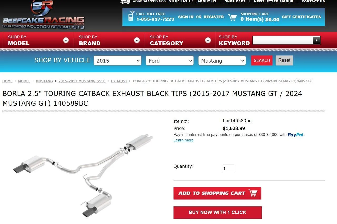

Here is a pic of the system I bought from Beefcake. I finally love the way my car sounds.
