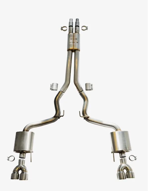

AWE or what I just installed from Thermal R&D (3" full cat-back, with 3" connection, 304 stainless, VERY DEEP TONE). I don't have headers, but people say with headers it has a much better sound than others. I was recommended the Borla S-Type, but let me tell you, that exhaust is L-O-U-D even with stock headers/cats, let alone catless headers. The S-type will blow your ears up. It's more of a resonation change with no sound suppression. The Thermal R&D actually has a 3-chamber muffler in the center, and the rears are straight-through Helholtz resonators (no packing).
