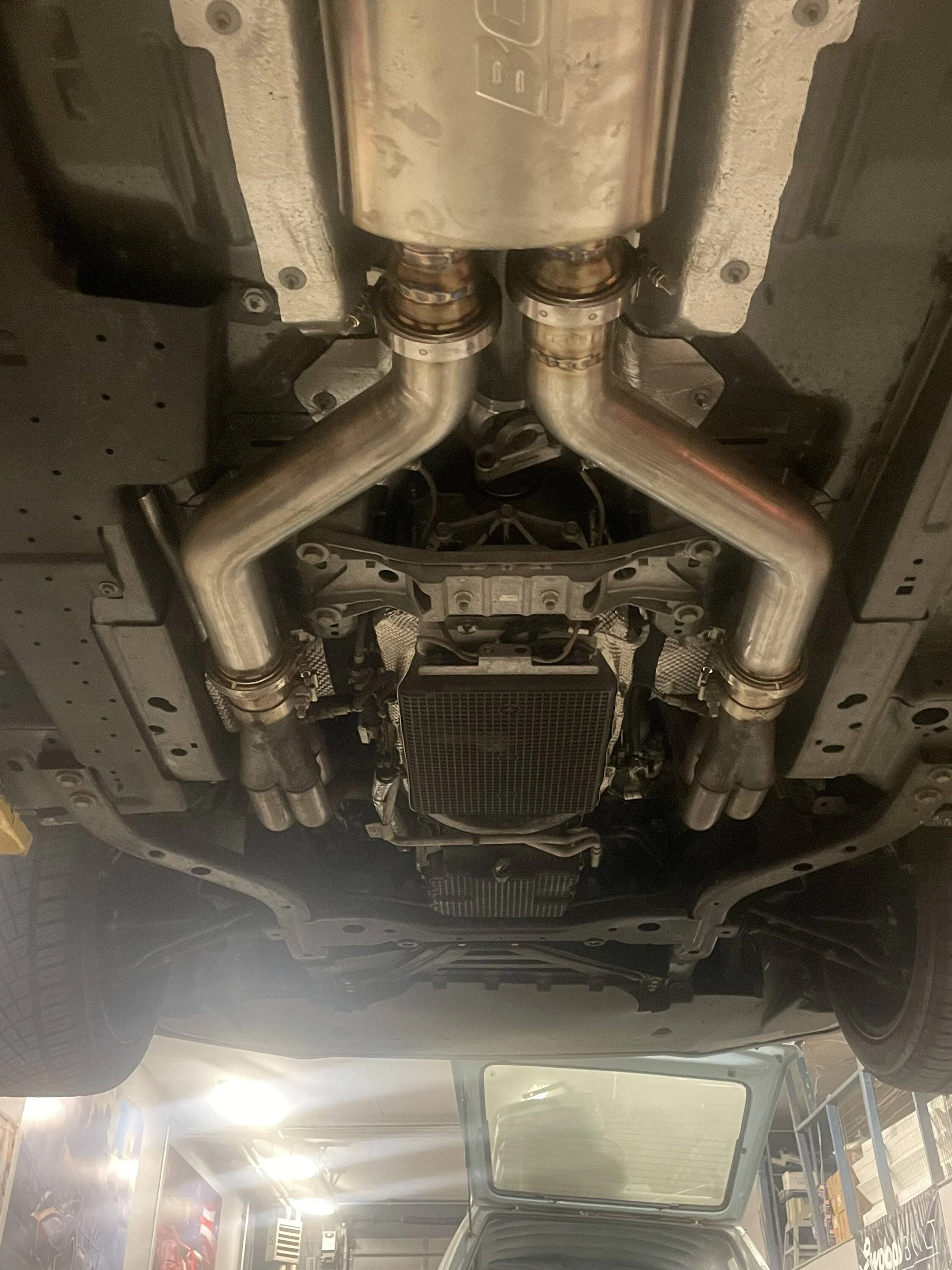

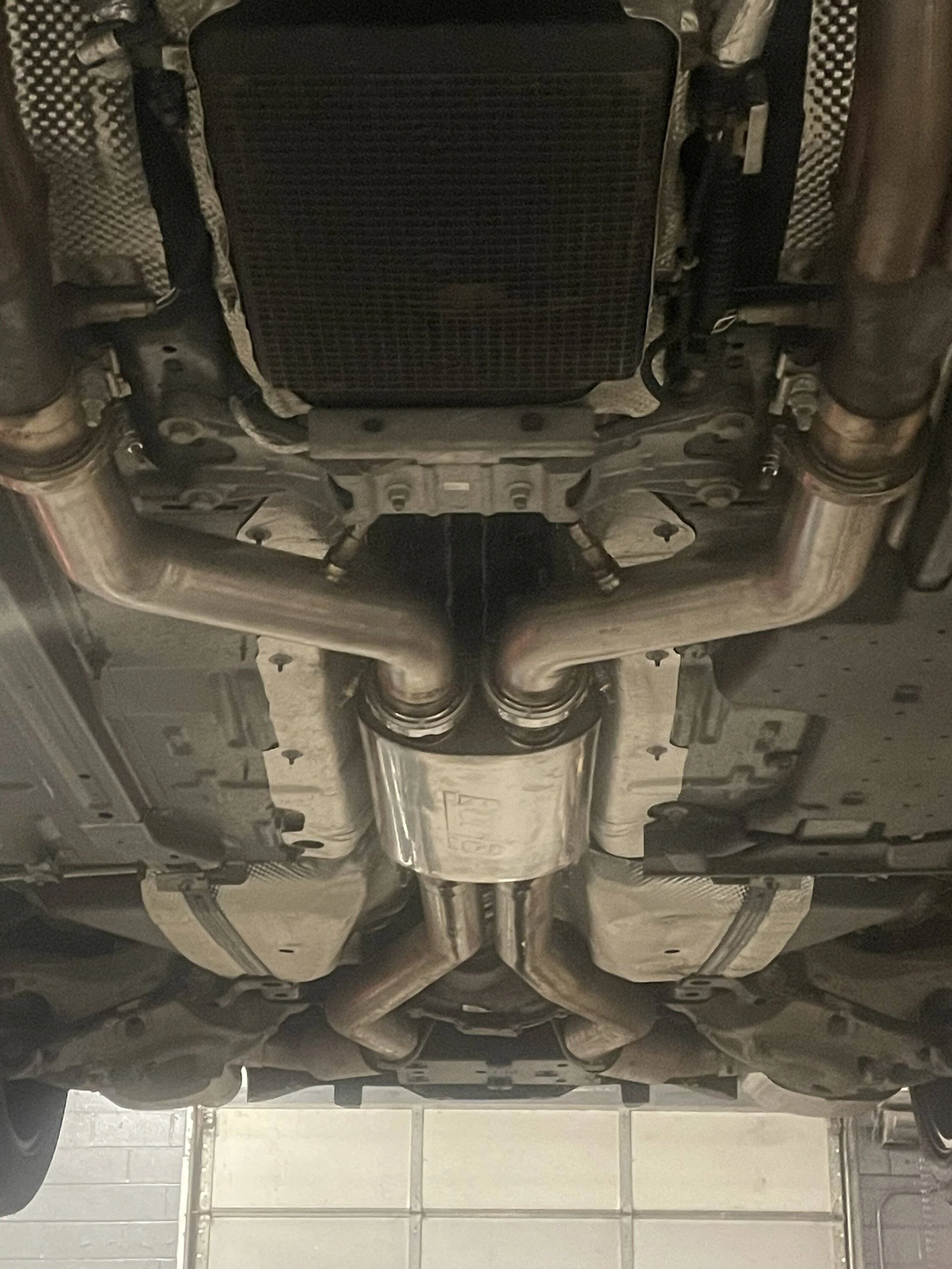

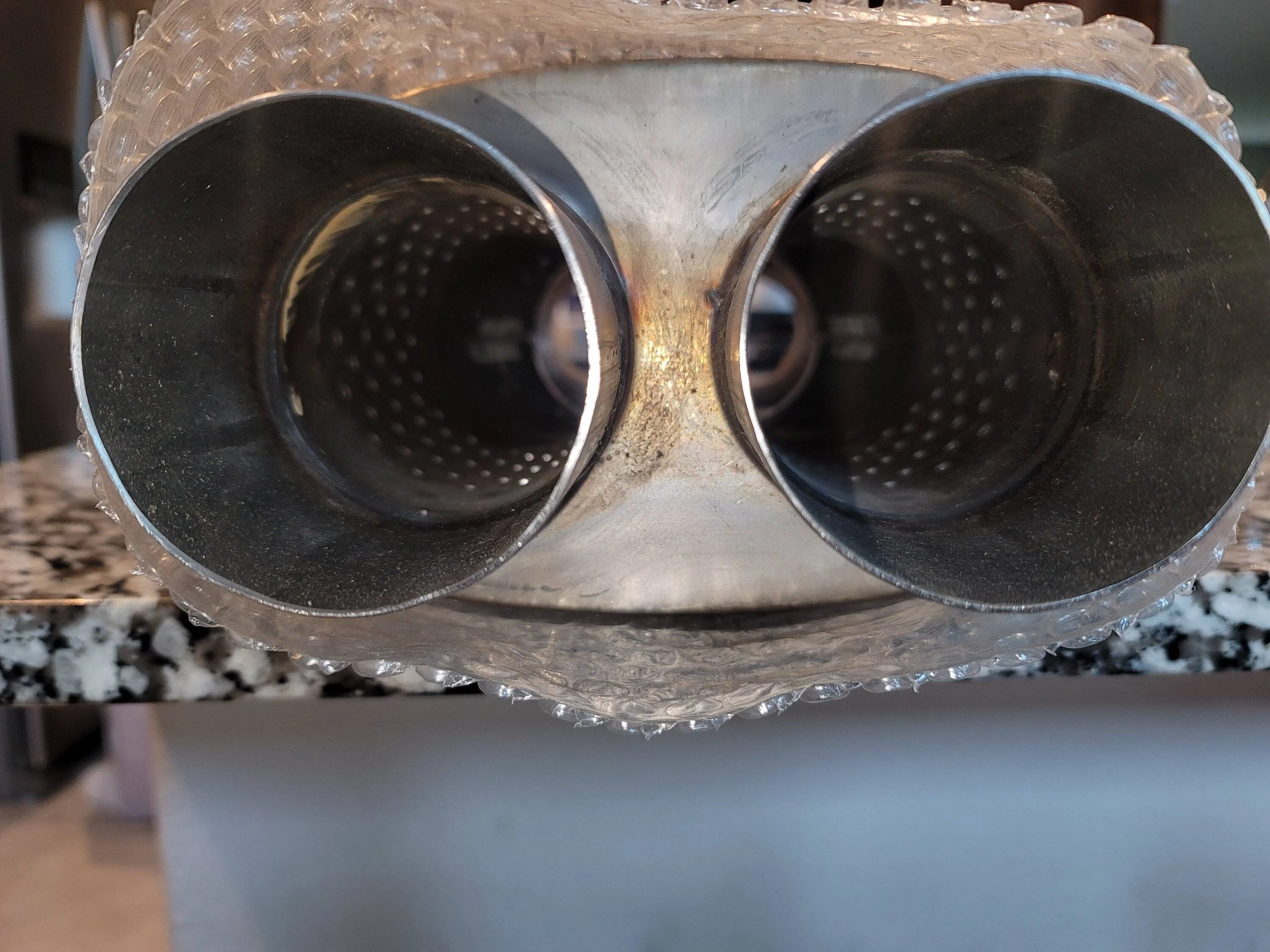

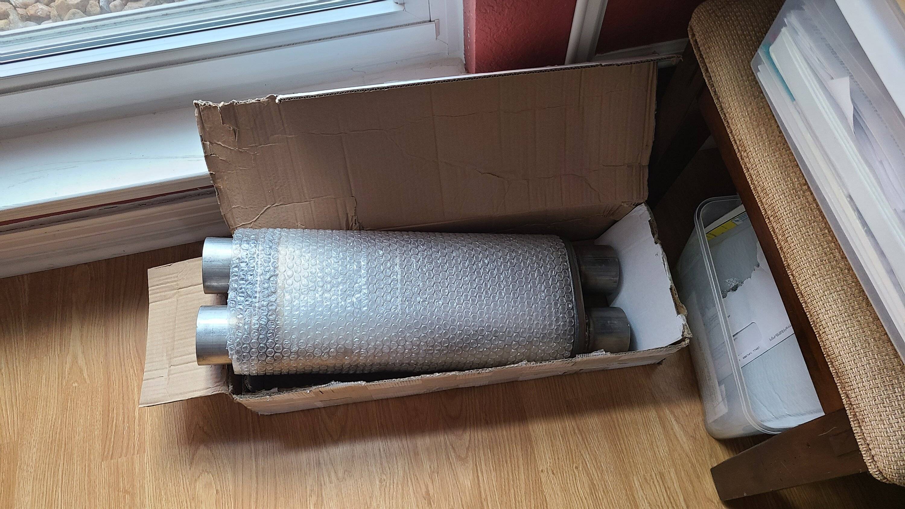

I wanted to update you here as I have found a true dual 3" resonated X-Pipe that will fit our Mustangs.
It's the Jones MF2469 which is a 5"x8" Stainless Oval muffler that has a tru 3" internal x-pipe crossover which is designed very similar to the Magnaflow 12469, but is actually dimensionally a little smaller so it seems to fit much better underneath the car. As you already know the Magnaflow 12469 is a double >-< which wasn't ideal for boosted set ups.
I recently replaced my Borla 2.5" resonated H-pipe that still necked down to the factory 2.25" connection. I run Mak-Delete Pipes and had 3" v-bands welded to the Mak's and installed the Jones resonator and connected it to my Borla 3" S-Type. Now I have a true dual 3" exhaust which actually sounds amazing. No rasp and very little cabin drone just under 2000rpm. Here's the link on Amazon to ensure that you actually get the X-Pipe version and not the >-< that they also offer.

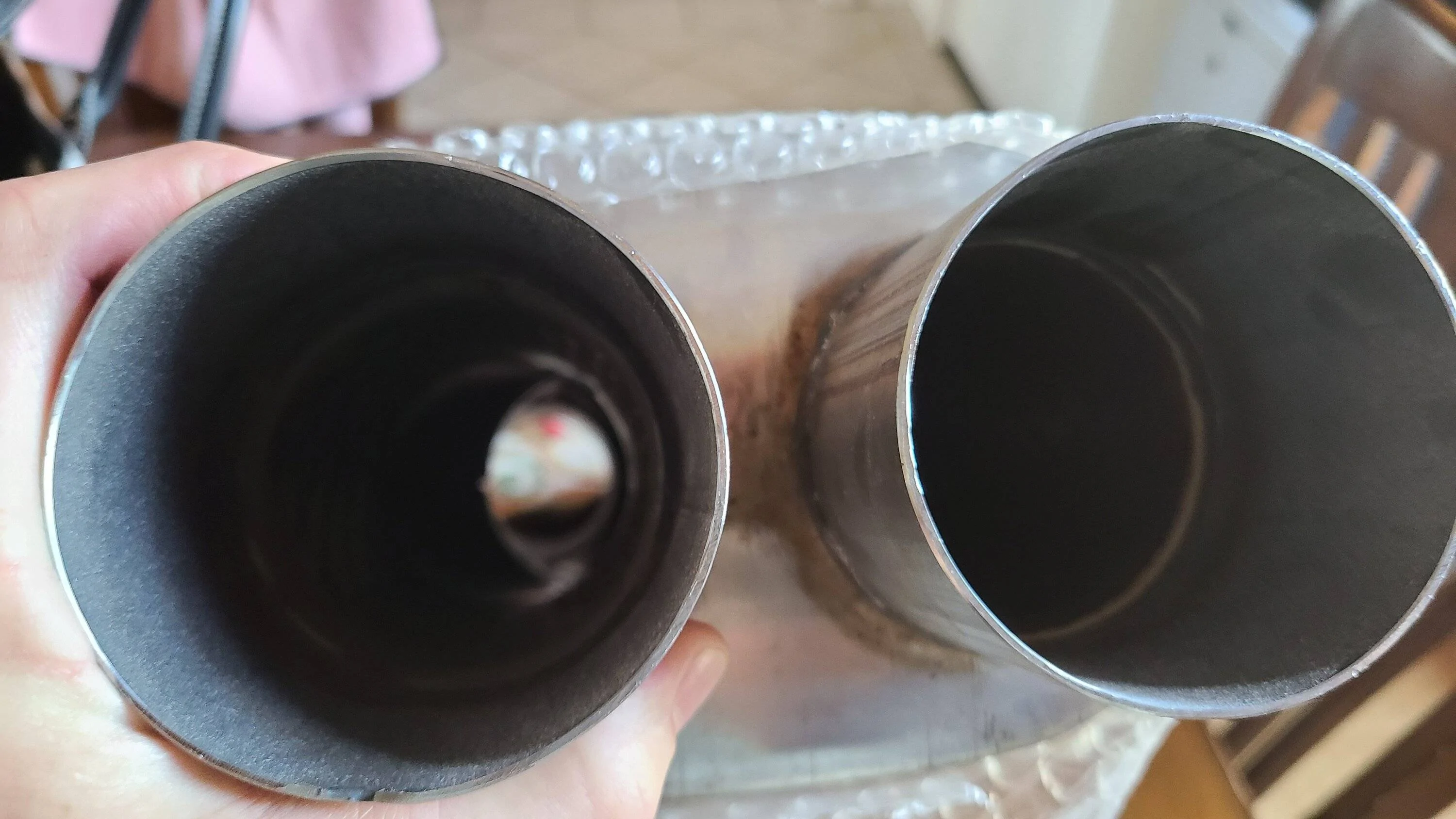

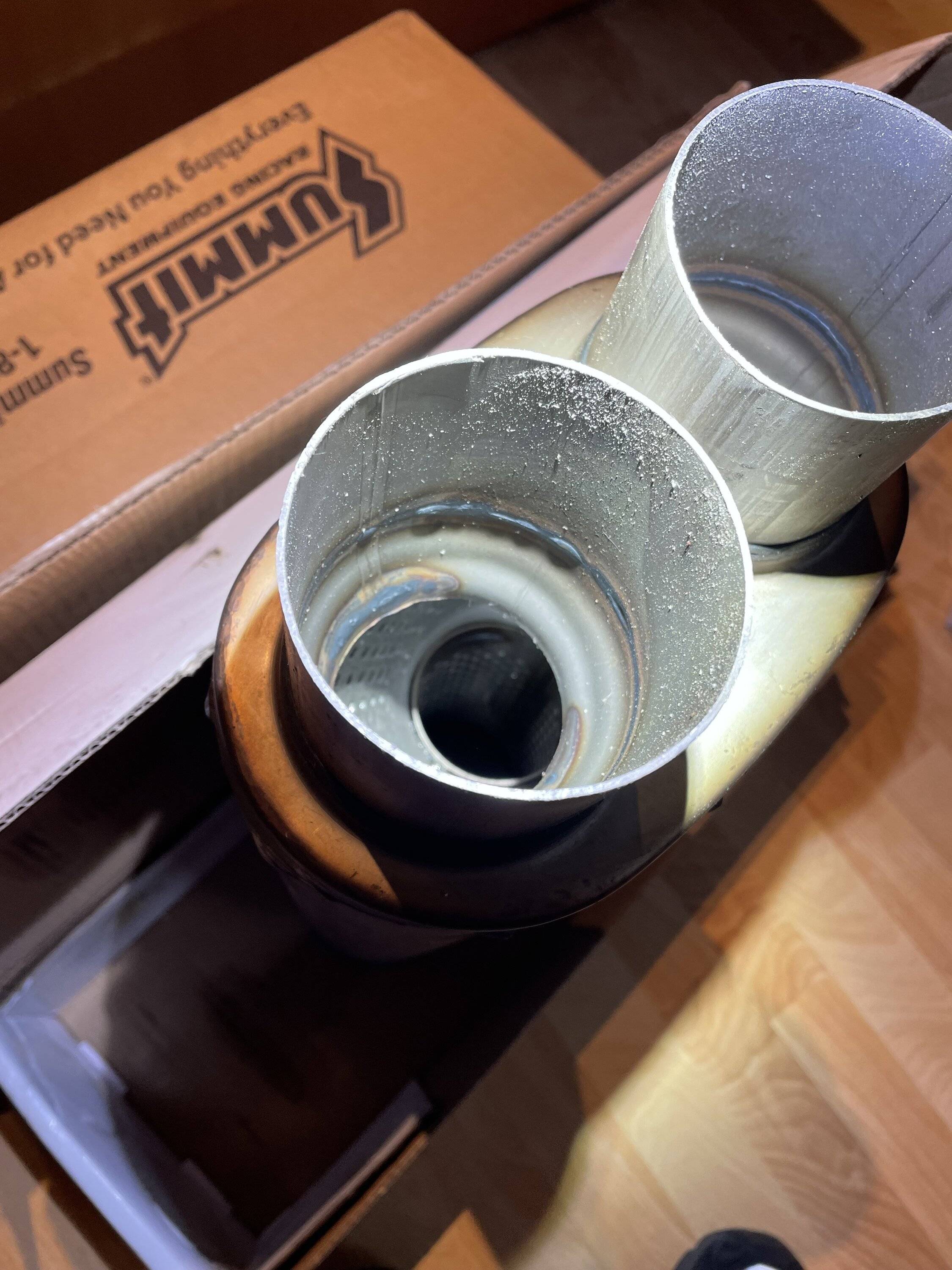

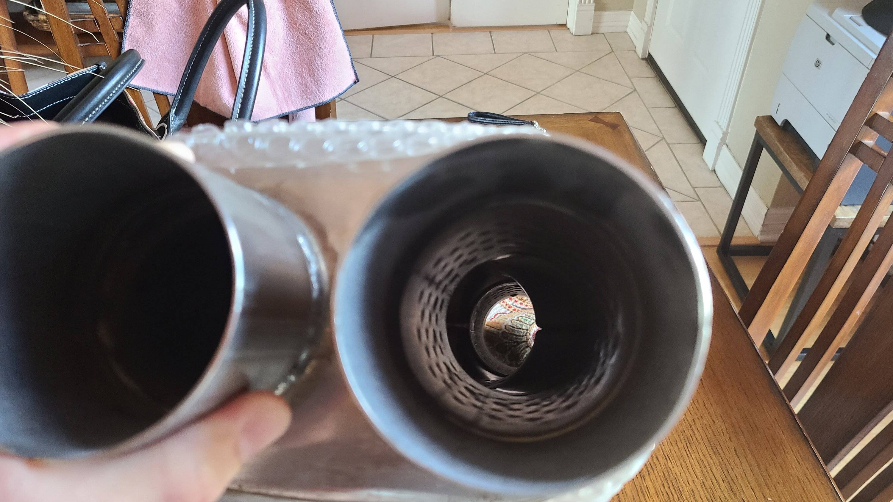

The Jones MF2469 I received from summit last year was actually a double y and it necked down to 2.5” at the inlet. Spoke to the owner of Jones and after some back and forth it was determined that his source in China changed the design without him knowing.. that is what he said… he checked a whole pallet and they were all the same… no offer for a refund…maybe he corrected the error or you may have got old stock..
I actually found a specific vendor on Amazon while searching some Camaro Forums that actually orders the mufflers straight from Jones and they're the Tru-X and not the Double-Y version. The Amazon link I provided is to the vendor that actually sells the TruX version that gets ordered directly from Jones Exhaust. Mine is definitely a Tru-X.

They all come from jones direct by way of China… I spoke with the owner several times regrading my issue… at the time he had a whole pallet that were y… guess he got the issue corrected… I’m going to call him and ask him to swap mine out…I had the Borla 60661 installed with the 2 1/4 cut off so it’s 2.5 all the way through… made same power vs the Borla 3 inch x pipe that came with my Borla s exhaust

I have the same Jones one as Texas Heat and mine looks identical to his.

Never used with factory connect.. cut off and welded on 2.5” to 3” transitions and v banded.

Thanks for the link, purchased one and can confirm mine is a true dual 3" resonated x as well.
