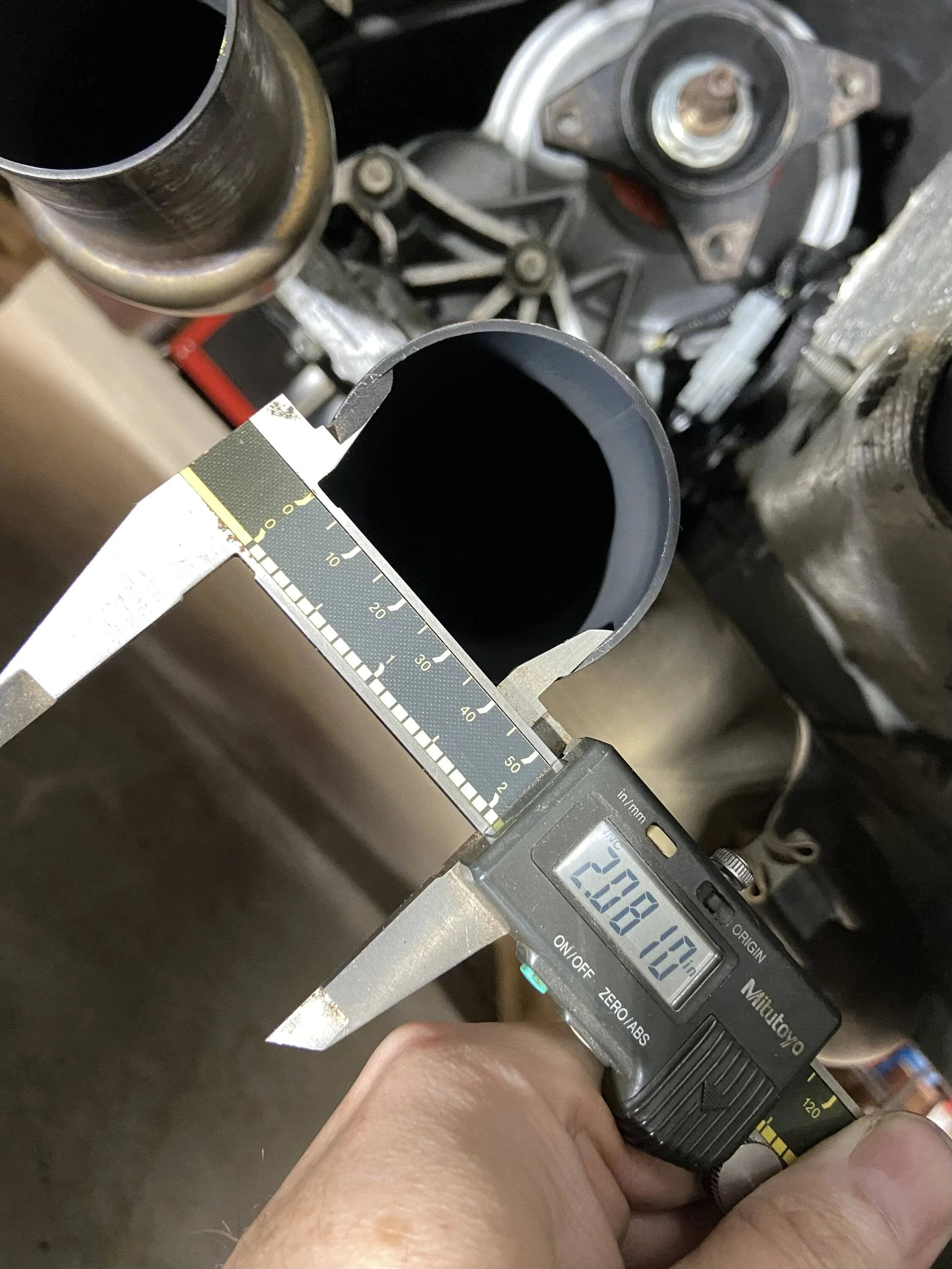

And I still make decent power and almost touching 8’s with this factory bottleneck mid pipe connection. ALIENS!!! 2.08” ID!!!!!
Probably will go faster without the bottle neck.

I mean, I’m sure it wouldn’t go slower. I hope not anyway. :). By comparing data on setups/DA/weight etc, I’m right on the money with others with giant full 2.5-3” exhaust systems. If it freed up 20-25 crank HP, I still wouldn’t bother changing any of it though.
Look at it as you are running what you should be running. The others you are making the comparison with are not running what they should.
