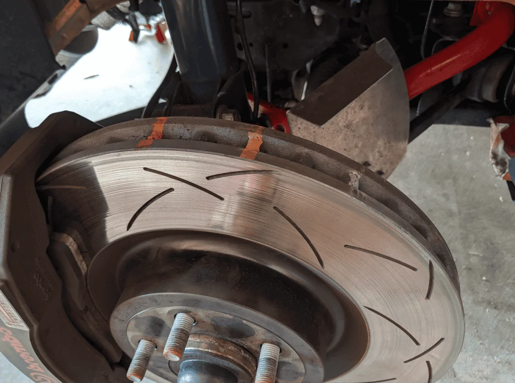

Was getting the car ready for BW this upcoming weekend (oil change, track pads/rotors, and bled the brakes) and when bedding the new rotors in, I noticed the Indy 500 tires I have on the front have pretty bad grip. Granted these are my street set of wheels/tires so I wasn't shopping for grip at the time but I was surprised how much less grip they have even compared to PS4S. They did not like hard braking.
@2morrow here's a rotor pic for you sir

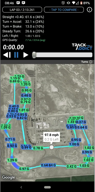

As for numbers: CHT hit 230, diff hit 241, oil never touched yellow. TrackAddicts says I got 1.3 G cornering and 1.2 G braking. I switched to 0w40 oil, I think that helped the oil temps. Diff is still a non-issue. Honestly, I have no idea how people are getting the diff to overheat. Sure, I'm slow, but I know guys who are sub 2:00 at BW and they don't have issues either.

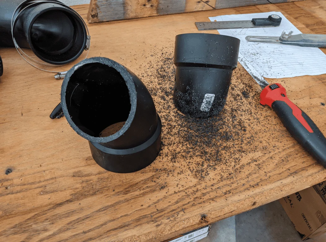

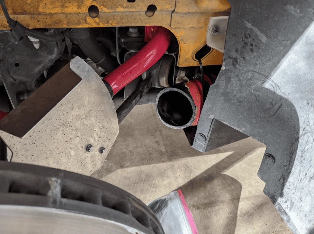

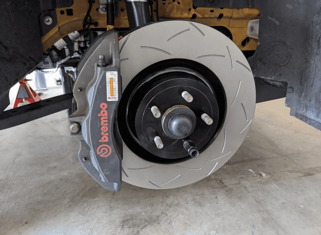

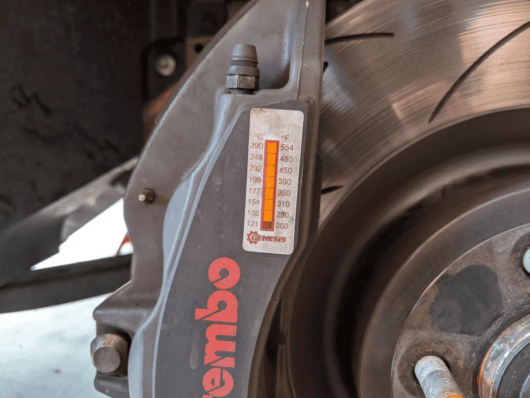

Even more brake cooling!
I needed to bleed the brakes in preparation for the next weekend so I took the time while the wheels were off to improve brake cooling a little more.
Some fun things to note...these stickers do work! I thought I had duds, turns out I had never actually gotten enough heat into them. #I'mSlow
And for the rotors, these DBA ones came with heat paint on the vanes. The various paint colors will change to a white color when they reach the designated heat range. The green changed but the orange and red were fine. So this tells me the rotors got hotter than 856 but less than 1022 degrees.
As for the additional brake cooling....I originally had Vorshlag brake ducts that ran from the front bumper to the back of the front rotors. I then later changed to their deflector plates but I left the front portion of the ducts connected, kind of similar to GT350's however mine weren't aimed at the deflector plates so the air was just dumping into the wheel wells. Well now I added some plastic elbows to better direct additional air at the deflector plates.
