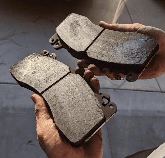

POST TRACK DAY PAD INSPECTION
While putting my street pads back on the car, I was curious as to how the Hawk pads looked after a weekend at Buttonwillow.
I'm a total newbie to all this so I have no idea what worn out or overheated brake pads look like.
They looked slightly shiny but nothing that looked overly concerning. They did, however, show lots of cracks on the surface.
After consulting more experienced individuals, it seemed these cracks are normal but is an indication that I was approaching the thermal limit of these pads. Maybe my poor attempt at sanding the rotors clean had something to do with it?
I got these Hawk HP+ pads because they were cheap and I needed something quick. Maybe now I'll make the jump to GLOCs or Ferodo pads.

I would look into what Carbotech pads others are running. I have been using them on my FR-S time trials car, and I have really liked them. I would also recommend trying out the SCCA's Time Trials program. The TT Nationals Tour events for 2020 were recently announced, and many regions and divisions are putting on one-off TT events or series. They promote a 'same team/everyone is here to have fun with cars' mentality while giving you the opportunity to race against the clock and compare yourself to others.

Thanks for the recommendation! I hear GLOCs and Carbotechs are essentially the same pads. I'm sure both will work well for my skill level. I'll look into them though.
I definitely plan to get into time trials when my skill level improves. A friend of mine has a Fox Body race car and we plan to eventually enter a junior endurance race as well.

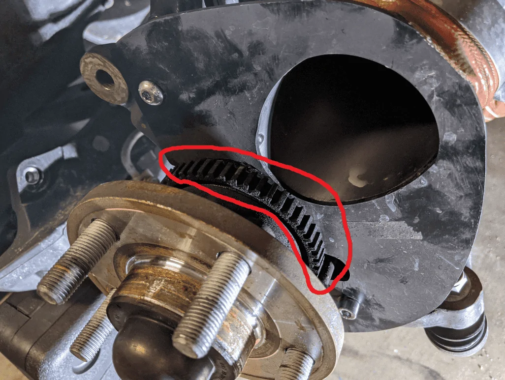

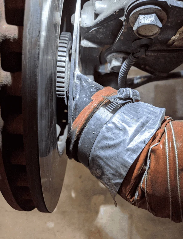

So after some research and help from others, I now know why my brake ducts are not working as well as they should be. The rotor backing plates are not close enough to the back of the rotor, creating a seal of sort.
There is far too much of a gap which allows all the incoming air to pass right by the rotor vanes. This is why I feel plenty of air coming through the hose but nothing coming through the actual rotors. I need to get the backing plate closer to the rotor.
The Specfab backing plates come with spacers and longer bolts to get the gap to a minimum. I figured I could use some washers to achieve the same thing...oh was I wrong.
The Full Tilt Boogie backing plates will not clear this portion of the hub. As I added washers to get the plate closer to the rotor, it would eventually come into contact while still leaving a gap between the rotor. Looks like the Specfab plates have a larger opening to clear this. Looks like I'll be ordering Specfab plates soon.

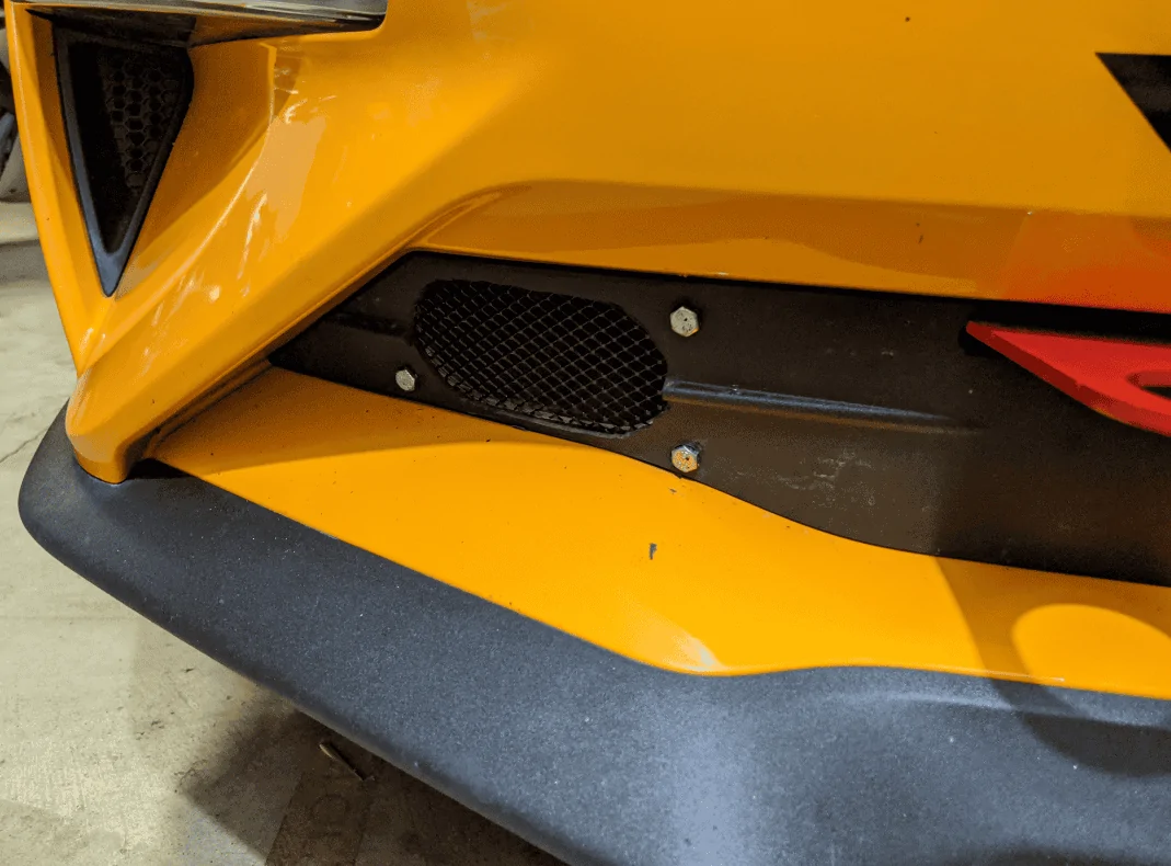

One thing that I did get accomplished and was way overdue for was mesh covers for the ducting inlets. I think it came out pretty nicely.
