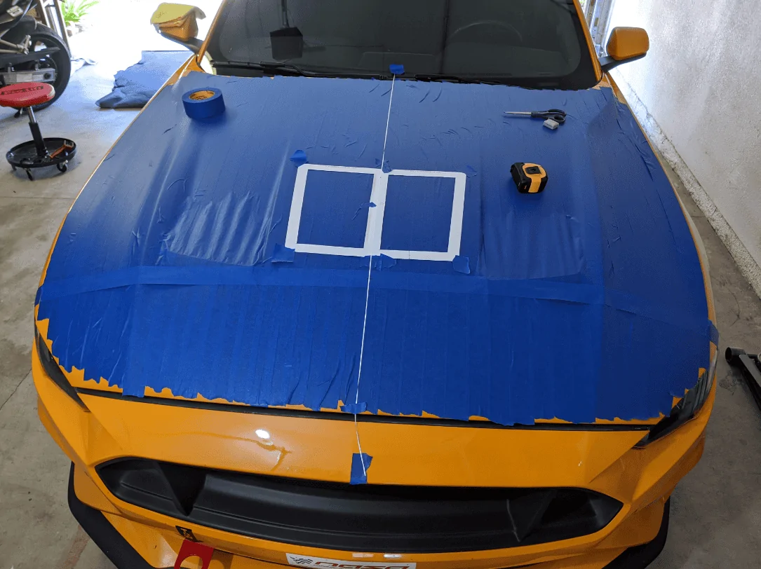

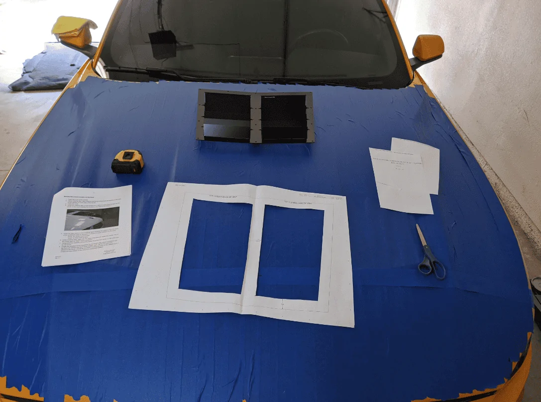

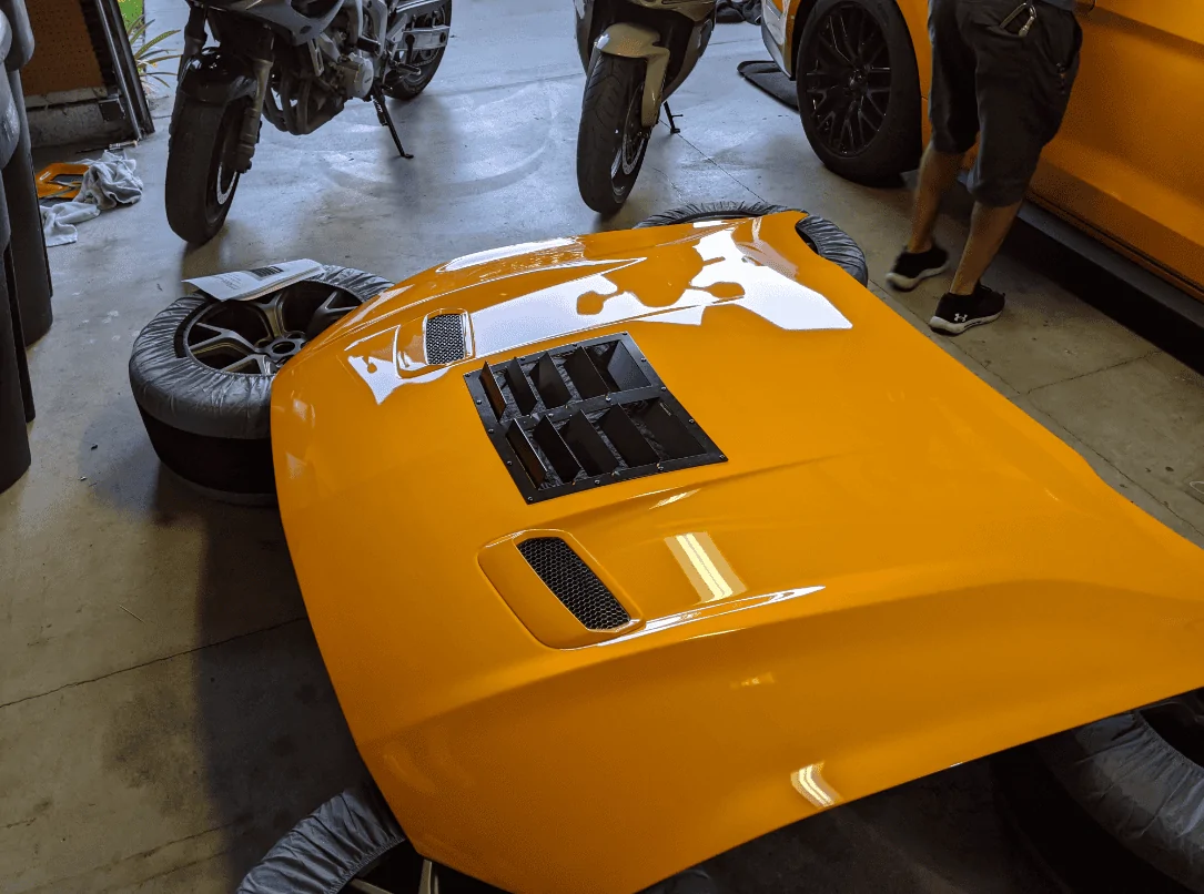

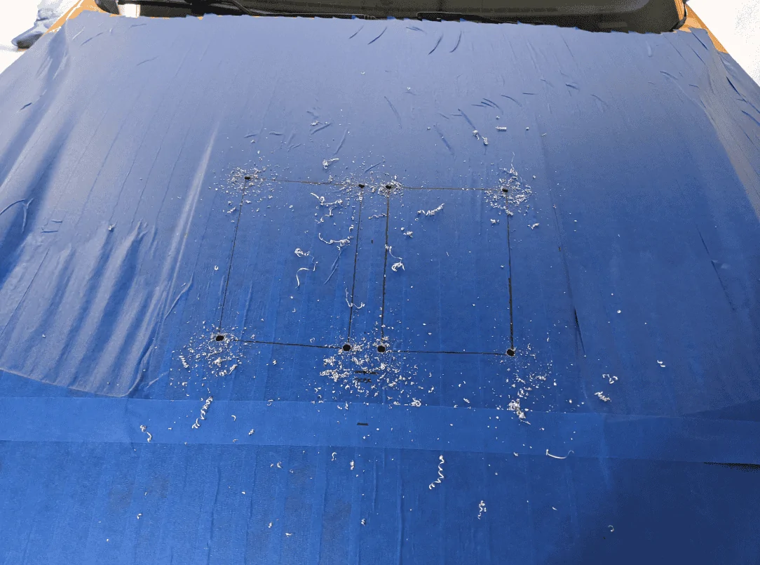

Finally getting some fun work done on the car! I've been wanting to add hood venting for awhile now and decided today was the day.
Now, I've never cut up a car before and I only have minimal metal working experience so this was quite the pucker! The instructions supplied are very clear and the template works great. I have to add, Race Louver customer support is second to none! I've been annoyingly emailing Albert for months now with various questions and he is beyond helpful. I called him halfway into cutting and he was quick to answer my questions. He even called me back later in the day to check on my progress and see if I had anymore questions before he left for the day. Albert, if you see this, THANK YOU!
The entire process was quite straight forward. Time consuming, but straight forward. I HIGHLY recommend taping the entire hood as metal shards and fragments get everywhere. I then used moving blankets to cover the engine and the windshield.
For finding dead-center, I used a long strip of floss and taped it to the center of the windshield (small decal label there perfectly in the center) and then pulled it tightly over the hood and lined it up with the crease line in the front bumper. Then simply measure about 17 different times and tape down the template.
I used a Dremel to cut the whole thing. Took 1 diamond cutting disc (or whatever the more expensive disc is made of) and 2 regular metal cutting discs. I tried to cut it all with the hood still on the car but getting the bottom layer cut correctly requires the hood off. After that, it's cut, trim, measure, and repeat till it all fits snug.

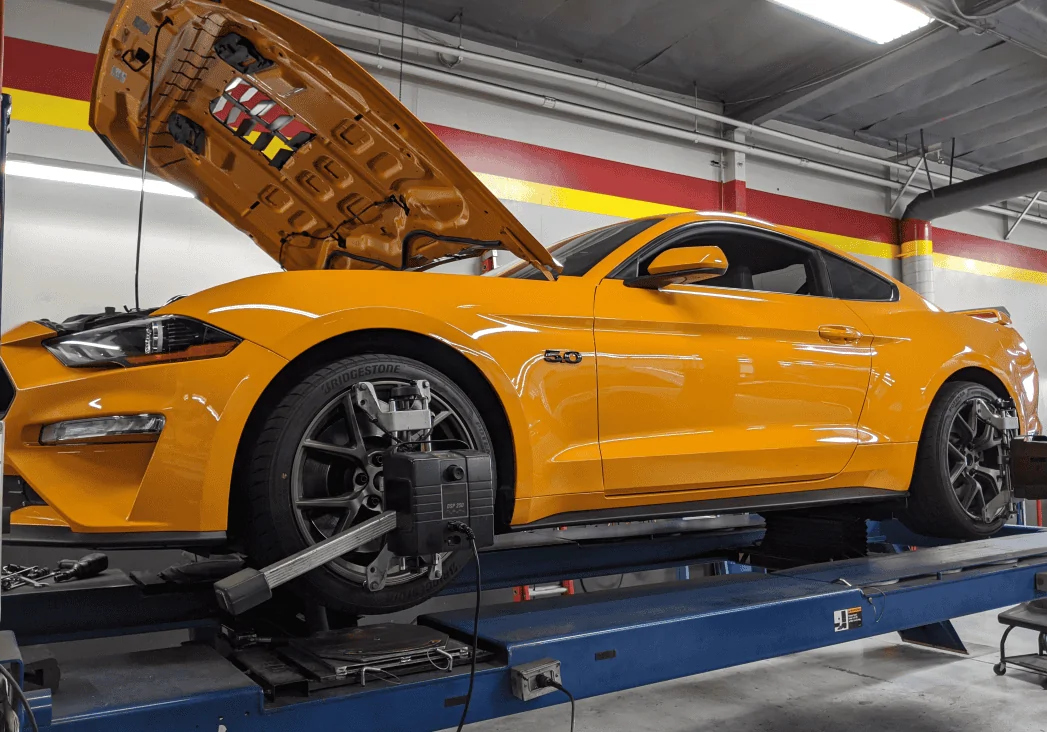

A little late to update here but suspension has finally found its way on the car! No more floaty boat feeling! There's an infinite number of suspension install write-ups and videos so I didn't feel the need to document this process.
BMR SP083 Springs (250/980#)
Ford Track Shocks
Vorshlag CC Plates
BMR Front Sway Bar (35mm?)
GT350R Rear Sway Bar
BMR CB005 IRS Lockout
As far as alignment specs, the car is currently at -2.6 front camber and -1.1 rear. The tech was having a bit of trouble getting the rear camber to where I wanted it (-1.5 desired) so we ended the day at -1.1 I'll likely go up from there but I'll try the car as-is first.
Haven't had much time to really feel out the new setup yet but it definitely feels stiffer and more responsive. I'll have to go through some canyons this weekend.

We tried loaded and unloaded. The slot design makes it difficult to hold in place. It wanted to fully slide one way or the other. Had to use a pry bar to hold the wheel in place against the alignment rack while the tech tightened down the bolt. Camber arms would definitely make this process much easier!
JustDSM
Jan 24, 2020
36
Ennis, TX
Justin
2020 Mustang GT PP1 6spd
No doubt the BMR arms are the real-deal! I'm eyeing a set myself.
However for a interim solution and a bit more on the cost effective side of things, I fitted the Steeda rear camber adjustment kit (https://www.steeda.com/rear-camber-adjustment-kit.html) It' makes dialing in the rear camber much easier than trying to manipulate the camber arm in the slot alone.
