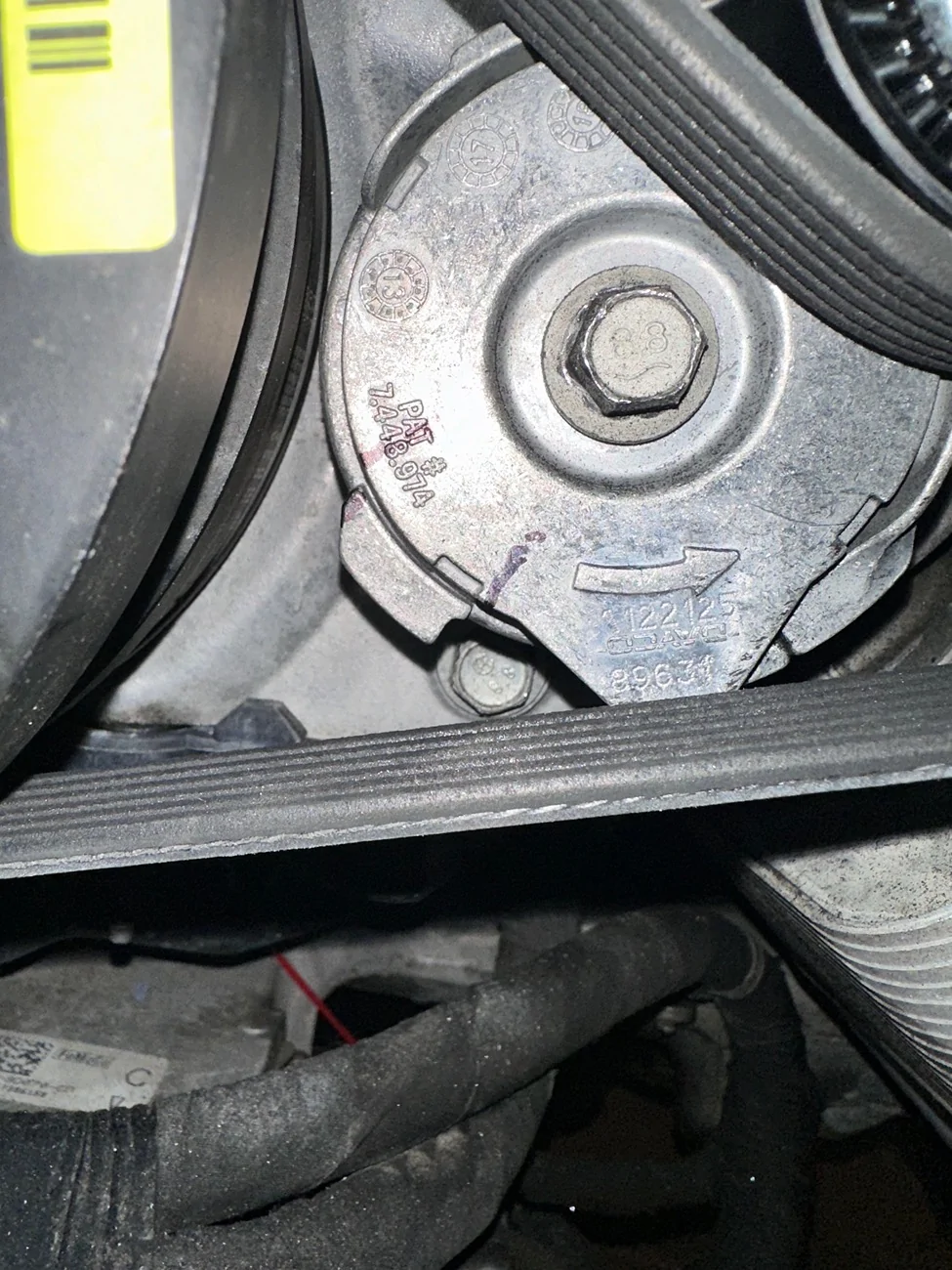

I put 3 marks on the tensioner, the mark on the very tip of the tensioner arm that moves along the outside. The top line represents where the tensioner sits unloaded and the bottom line represents where it is fully traveled. The picture shows when the belt is loaded on the tensioner. It basically has not moved away from being at rest when a belt is on it.

Since you removed the blower do what billy suggested. Put the stock injectors back in and stock file and see if it'll even run. The IMRCs locked out will affect fuel trims slightly but it should run good enough to know if the tune is the issue or not.
You said you changed the tensioner out right. Do you have the stock one still?

Yes I do have the stock one, and it’s just as bad. There’s no tension being put onto the belt. I’ve seen issues where people need to get bigger belts but haven’t seen anything for smaller yet. Still searching everywhere.

I’m gonna go buy some shorter belts to try and get that tensioner closer to 80% travel instead of 5%. Any recommendations?
Update: I bought K061020 and K061015 at the parts store. Will update how it tensions.
