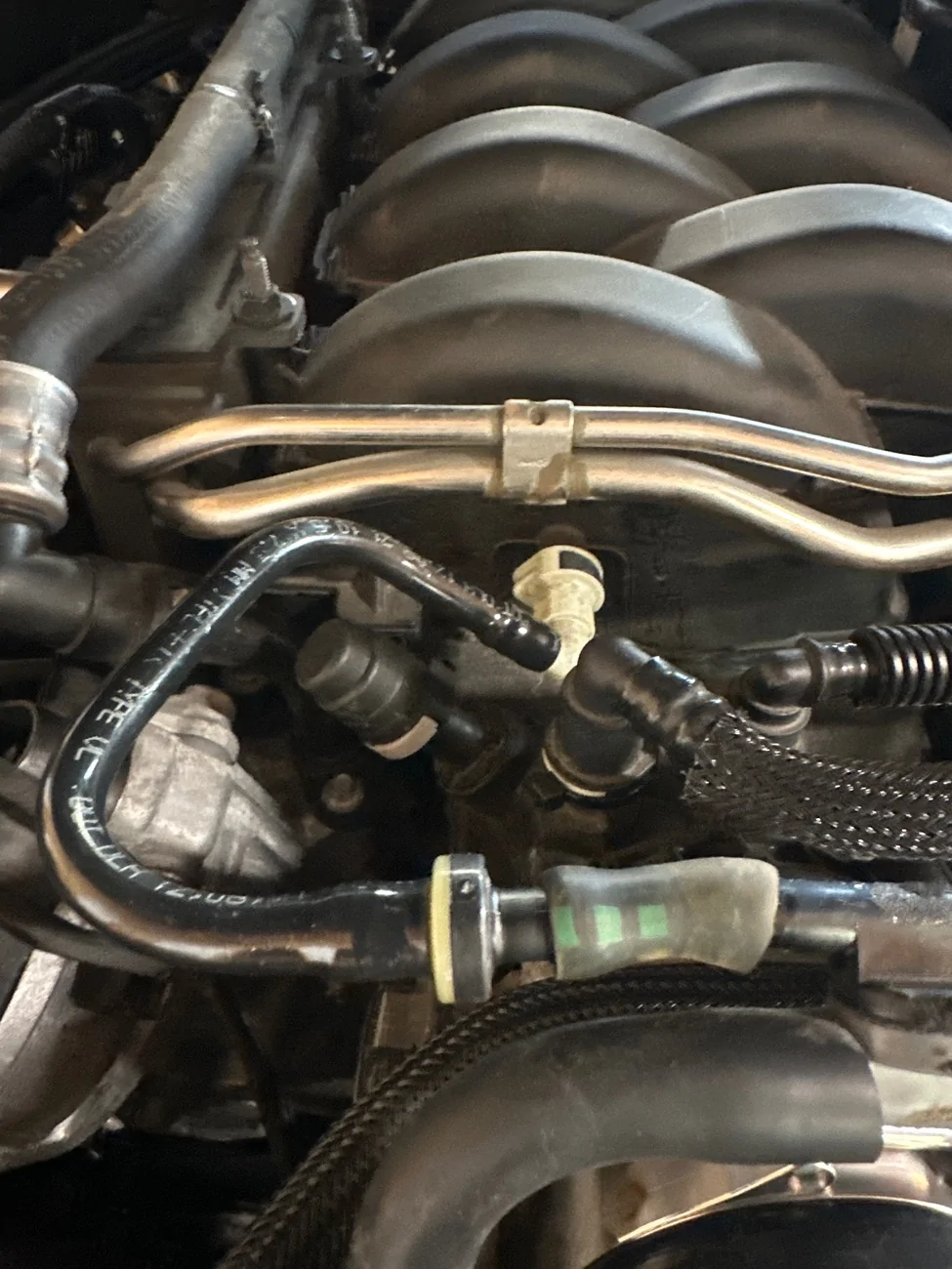

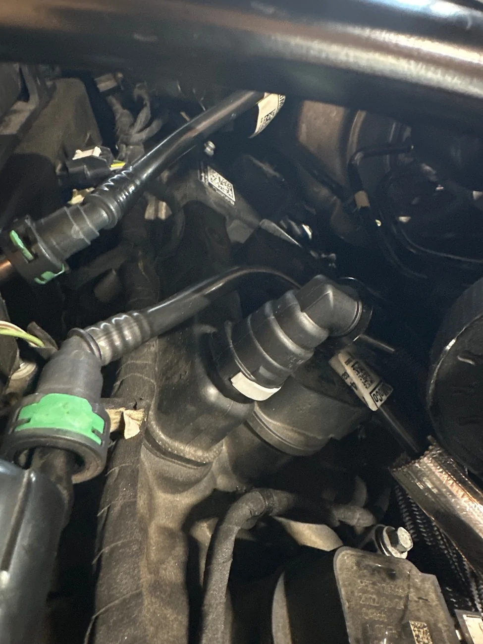

@ 6:30 the nipples he's pointing to, I have the back capped, and the front untouched like you see in my picture posted up above.
@ 8:30 he's saying you can remove that line and plug it or leave it dangling off for now until it's plugged. I'm not sure if that line is vacuum or not. If it is, you can't just leave it dangling there. Needs to be cut off and plugged or plugged back into the manifold
Sheepdog covered it on his picture. Only difference is the guy in the video is saying you don't have to cap the manifold nipple. If you're unsure I'd just cap both ends. If it's sucking in air a cap will cover it, if it's not sucking in air then a cap won't affect it. A cap is a fool proof way to make it right. Or just plug the line back into the manifold like I have and like bob lob has on his.
If it doesn't run right with the front line plugged in and the rear nipple capped, you have some other issues.
If I plug it back in the front, and cap off the rear, it won’t even want to idle and all hell breaks loose. If I leave it open in the rear, it’s happy.. I’m so confused by it would be running better with a vacuum leak?

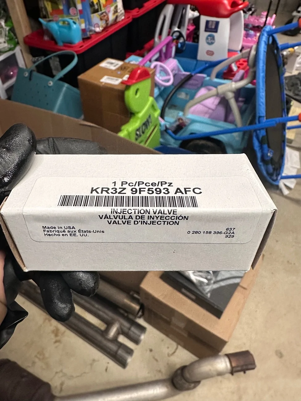

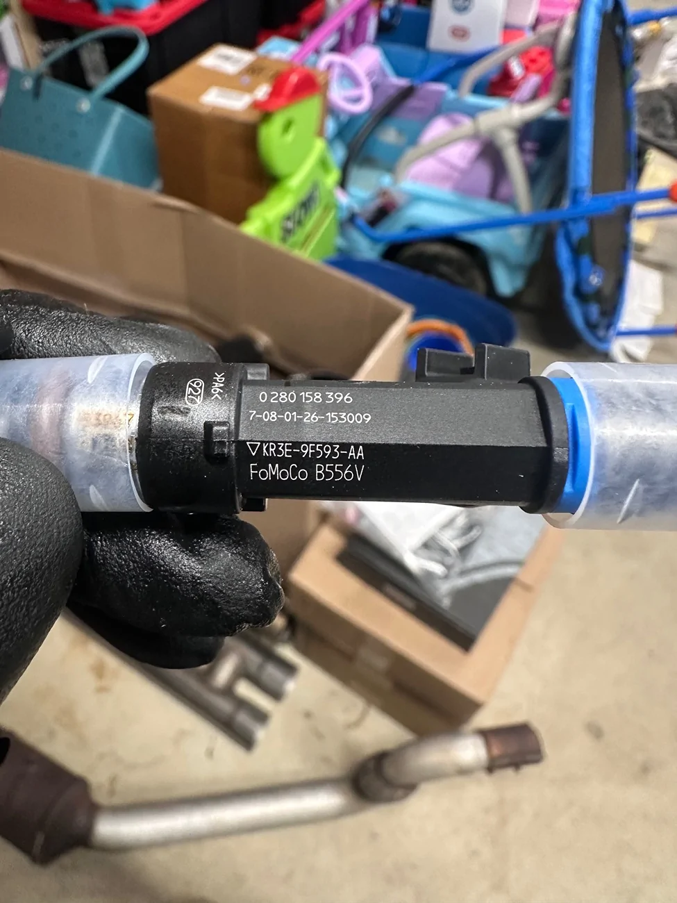

I probably missed it but what injectors are installed? Something is definitely off here. The MAF sensor is facing the correct way right?

The gt500 injectors, I’ll include photos. I’ve posted pictures of the vacuum lines setup and the belt layout prior if youd like to see them.

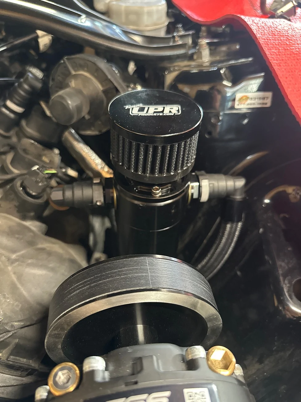

Did you happen to install a catch can with this install?

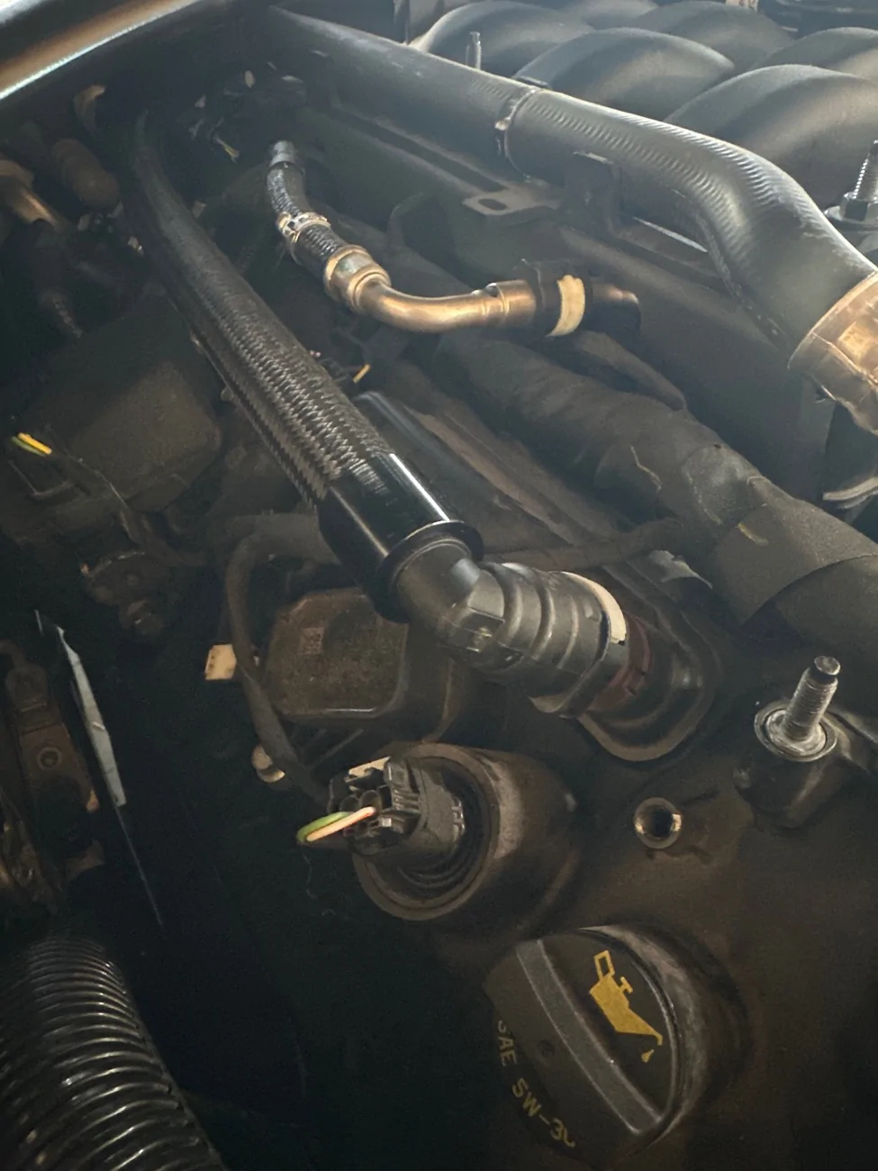

How is this routed???
Do you happen to have a plug or cap that came with that catch can?

passenger side is the passenger side of catch can, driver is on driver. the black cap is installed on the front of the intake manifold.
