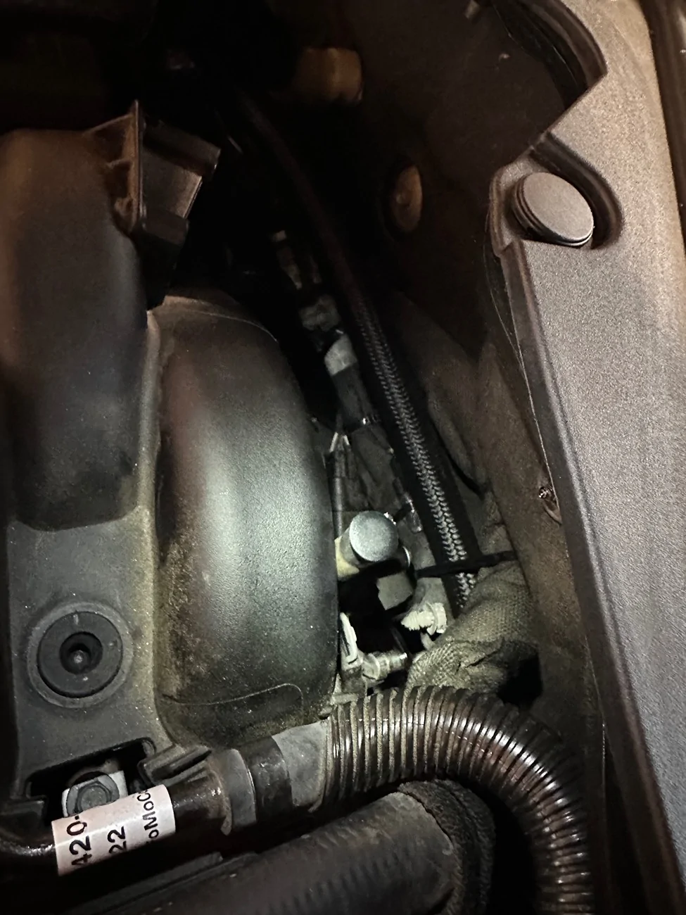

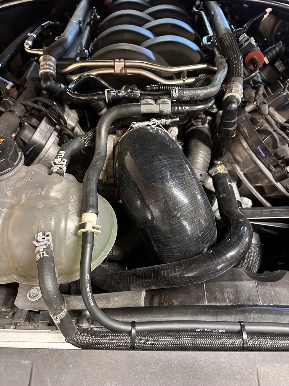

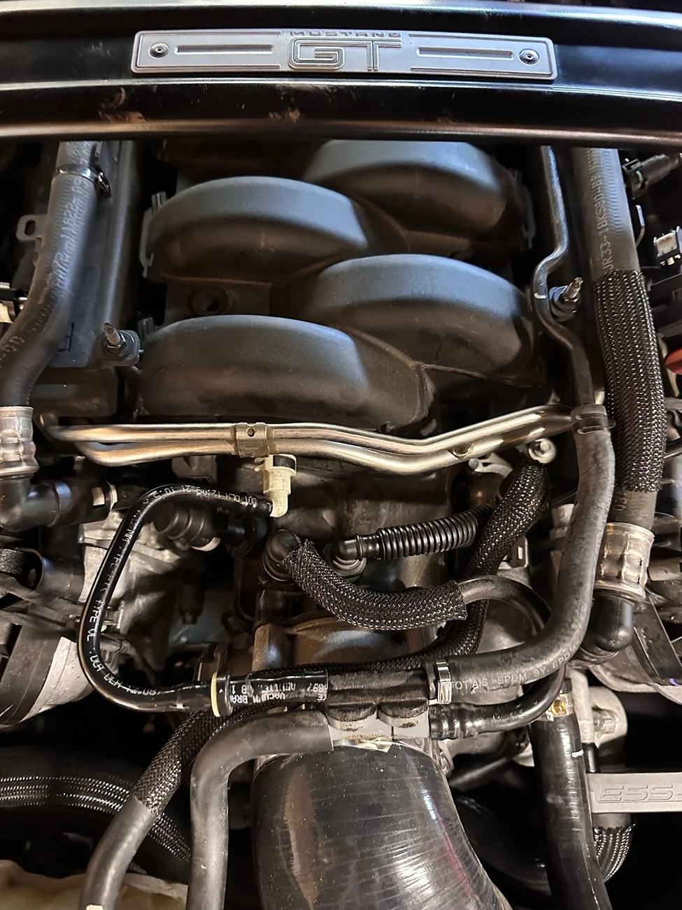

I also need help with IMRC lockout tube routing. There are plenty of videos showing the 18+ manifold conversions for 17 and under, also how to install lockouts, but nothing for 2018+ tubing. The line in the back of the manifold originally attached to the brake booster to my knowledge gets capped off. ESS also states to cap it off. But here’s the problem, it runs terrible when capped off. When it’s open and sucking in air and causing a leak, the motor runs much better.

Do you mind showing me the setup you have for your air lines? I can’t find any information on this.
I did the same thing on the vacuum line for the BOV. I didn't do anything with lines in the back of the intake manifold at all. Why is it capped? What did you hook the line up to?

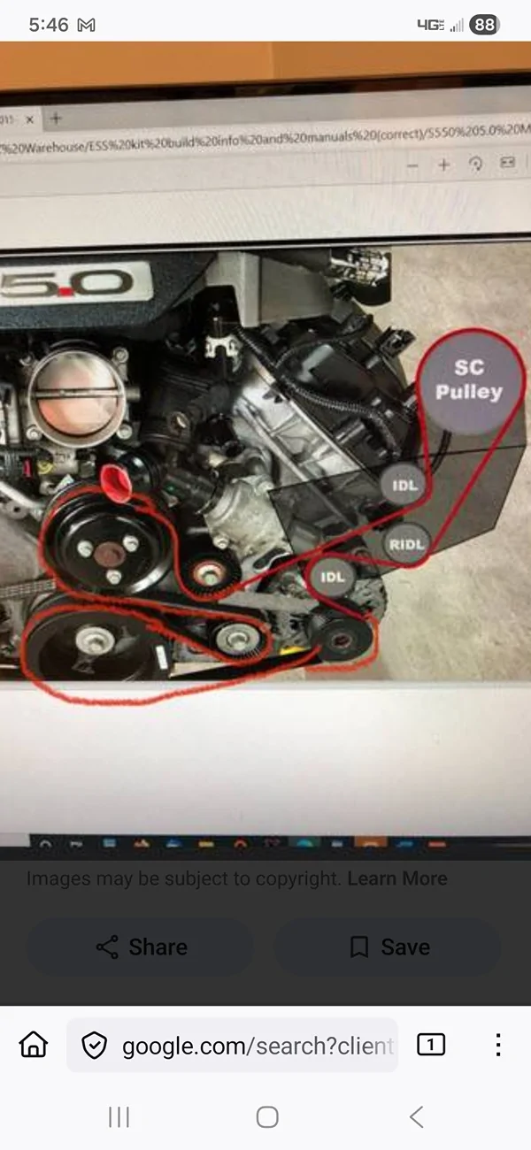

Is this the routing that you used? It shouldn't be able to jump around at all.
The IMRC was removed and capped off in the rear. Do you have lockout or no?
