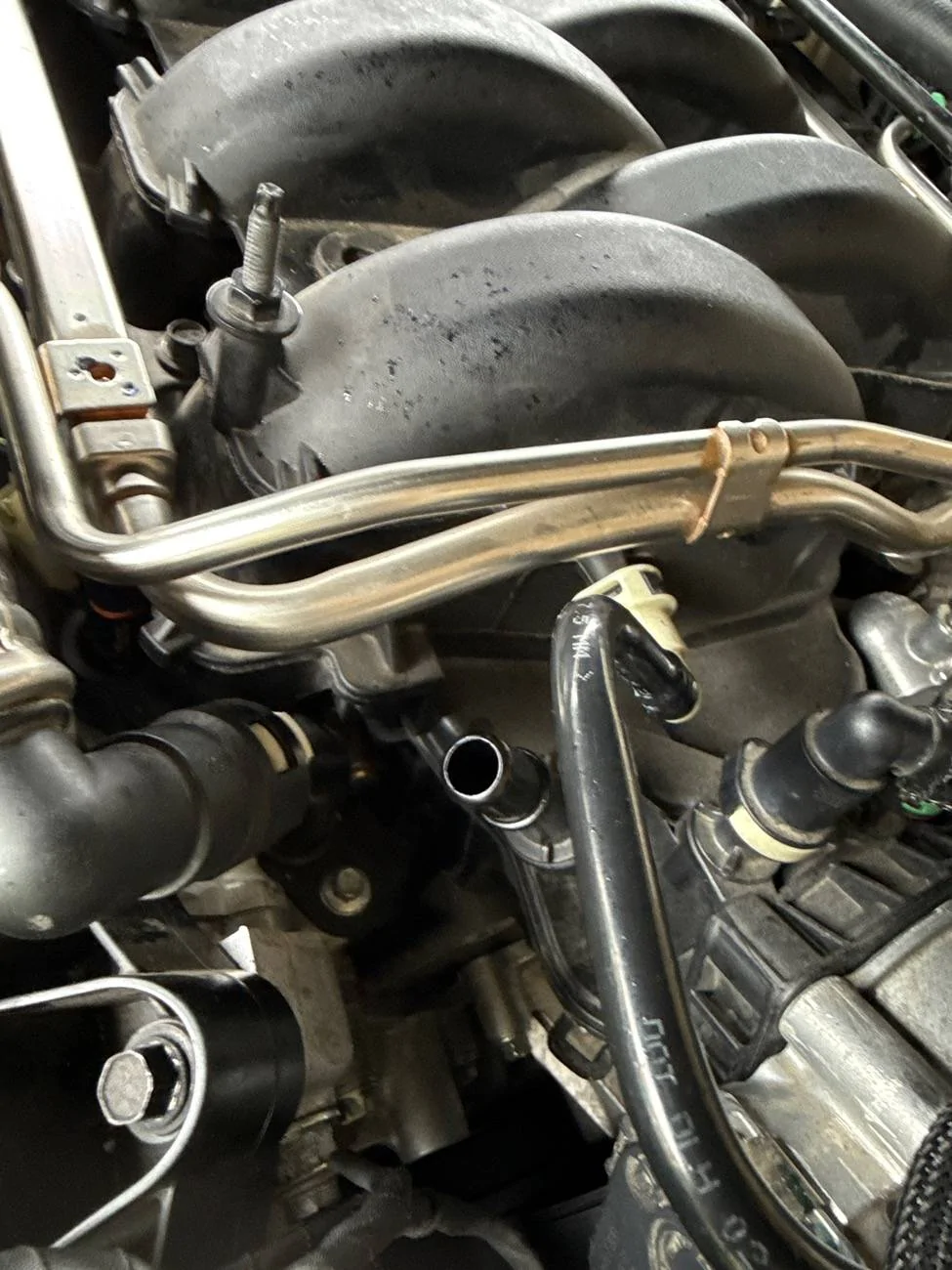

Need help with what goes into this, this is the only part im stuck on, I got this kit off a wrecked car and the car runs when I put a cap with a hole on it, but when I completely block it like I see on other people’s cars it chokes the car out, have tried looking stuff up about it and I can’t find anything, it’s something so small that I’m missing.

that goes to the passenger side pcv valve

Is your PCV catch can sealed or vent to atmosphere? Is the PCV check valve still in place? Might help if you show how everything is plumbed in the engine bay with another pic

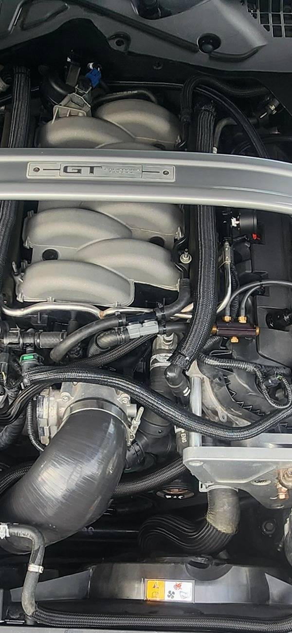

Procharged, gen3 intake,maybe this will help you.

Vent both sides of the PCV to atmosphere and plug the intake.
