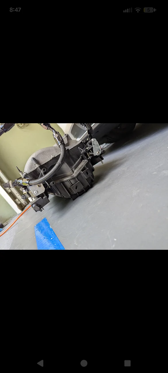

Got cha. I don't think the solenoid is the issue. Here's the back of mine when I did it awhile ago..
Kinda stumped here. Seems like it isn't in fact a vacuum leak. If it's the tune that's insane....

Yeah you have the solenoid removed and the line capped. Same as me and it won’t even try to run.. and when it does it seriously is dumping fuel out the exhaust and puddling.
