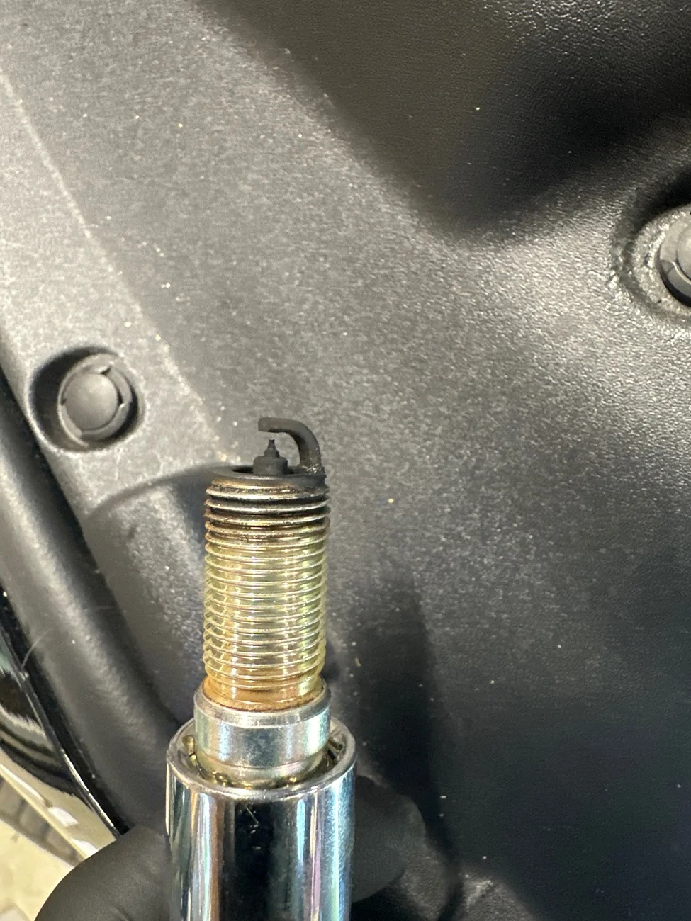

I’m reverting it back now, I’m taking the injectors out as I type this. The new plugs are gapped to 0.028 so I’ll have to change them as well

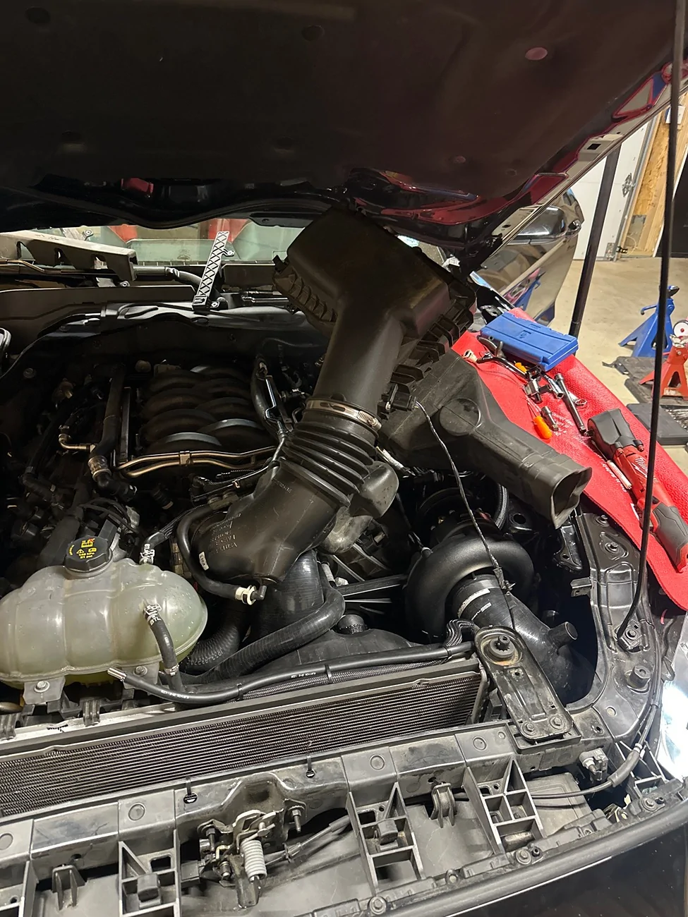

So I think you all will appreciate my ingenuity:
It starts right up and idles well, but a little choppy. Not a single engine light comes on the dash, but I am still getting the cam codes.

been following this and I REALLY feel for the OP having to go through this BUT my one call out as I get ready to go down the ess rabbithole are the GREAT people in this thread helping out a fellow car guy they don't even know...
this forum is tops...
and the pic of the factory intake back on is classic..... best pic I've seen in a minute.
Haha nice. So it runs fine but a little choppy no big deal. I'd do what others suggested with the crank relearn. You say no light on the dash so the codes showing up may be the old codes. Try to clear them all and see if they come back. Good to hear some progress. If this thing ended up being fine I'm pointing my finger at the tune file.

I completely agree, I don’t know where on earth I would be without this thread right now. I appreciate each and every one of you!
