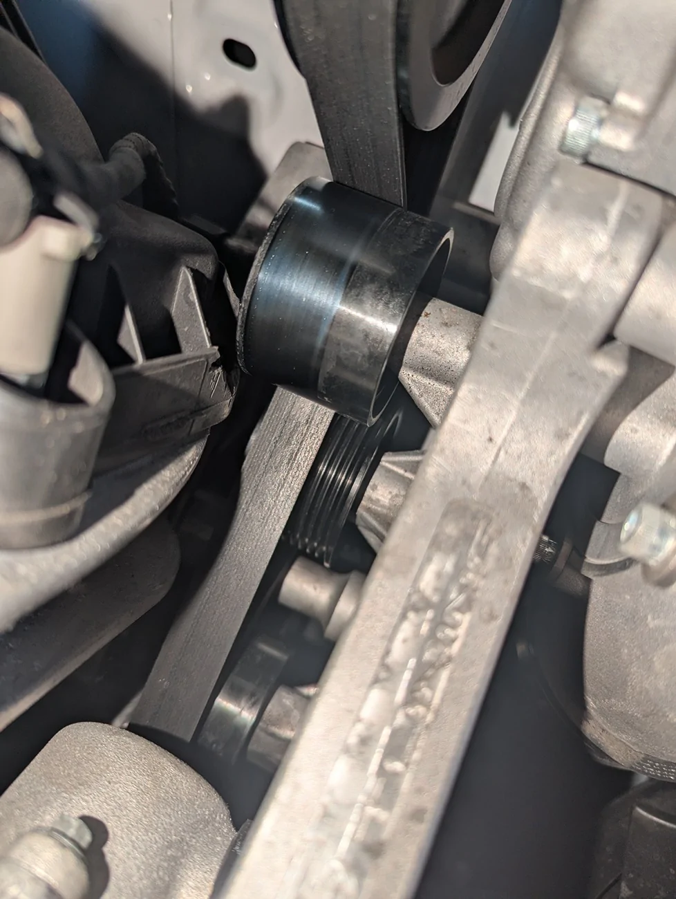

No. There is a dowel on the back side of the tensioner that fits into a hole in the timing cover
It’s in the dowel, so it’s where it should be. I’m so puzzled. It’s definitely slapping the belt around from how loose it is. And the routing seems to be in order. It’s a new tensioner and belt that’s the correct size. There doesn’t seem to be any possibility that it could be the bracket itself off a screw or something or it wouldn’t even fit.

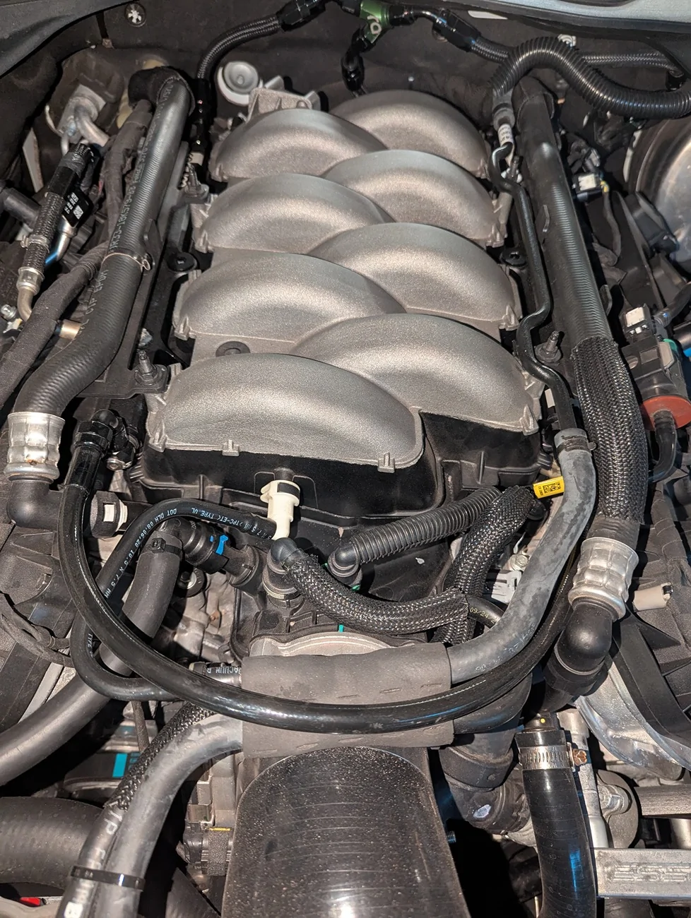

Now with the line correctly fitted and capped off. The brake booster and bov are connected to the same line that goes into the front of the intake manifold. I’ve tried starting it now and it won’t even hold it wants to die out.
Pistol_91
Oct 25, 2023
1,443
1,470
Clearwater
2020 mustang GT
Double check that the belt is as far back as possible on the pulley in the picture.
This is what mine looks like here for reference
FWIW I think one of the more relevant reasons people lock out the IMRCs is when they crank the boost up in an FI application some people were having issues from them getting sucked closed during high manifold pressures.
The belt is as far back as it will allow it.
You have the brake booster connected to the front, what do you have the back lines set up to? I have nothing back there or up front

The top one you are saying to cap is the line that goes to nowhere in the back so it wouldn’t need to be capped, I’ll go ahead and try to cap the lower one as instructed
I called the bottom one and left the top one open. Wouldn’t even run or build pressure. So I reconnected it and runs perfectly fine with minimal belt hop.
