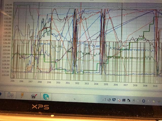

I have a 5 gallon ice tank and run 1 inch lines to my intercooler
Since switching for a Jabsco pump to the ligenfelter high flow pump IAT's were down from 165+ to 135 at the end on my last 10.1@145 pass(2.66 first gear Magnum XL ,crossing traps in 3rd with 3.31 rear end-just switched to 4.10's)
..... and that was without any ice as you can see IAT's were already up there while staging.
