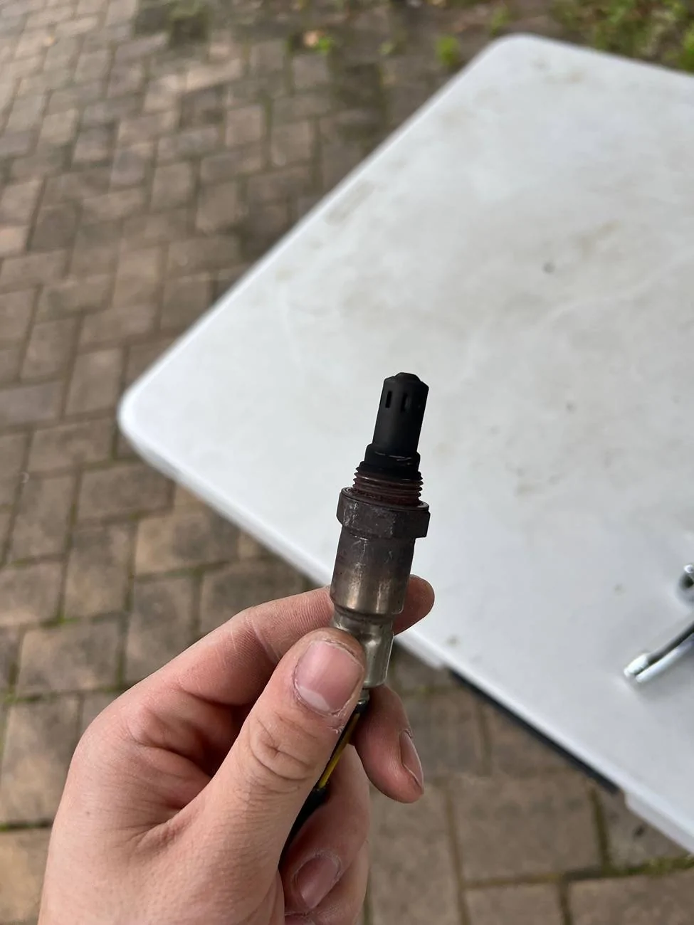

Hey !
appreciate all of the suggestions, I went with Wengerd Performance, as I triple checked everything on my end. I was competent enough to do this job myself and behold! It was the Tune. The tuner was a speed shop in long island; he was doing a remote tune for me through VCM scanner and suite. After going through 17 different tune files, he said “I gotta see this car, tow it to me” and thats a big no no. So I called the shop itself and explained the situation with a reply of “i charge $150 an hour to figure it out”
I hung up and went to Wengerd performance. The guy sent me ONE tune, the car started right up. But now, the last tunes destroyed both O2 Sensors before the cats, from running so rich. I’ve attached the O2 Sensor. A literal piece of charcoal. Note to self, buy cheap, buy twice.
THANK Y’ALL FOR ALL OF YOUR HELP!
i will update once the new O2s come in.
