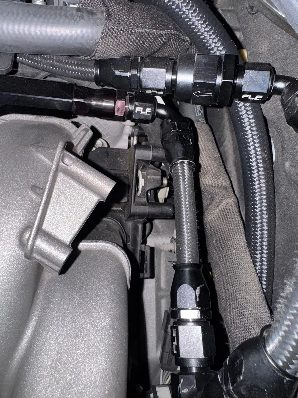

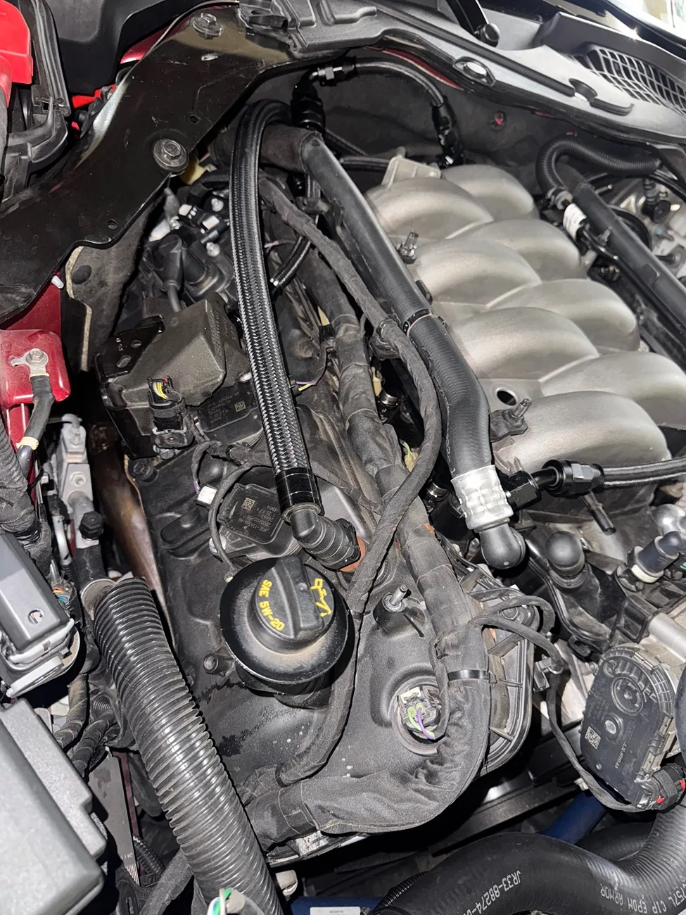

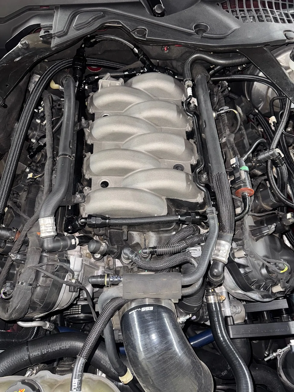

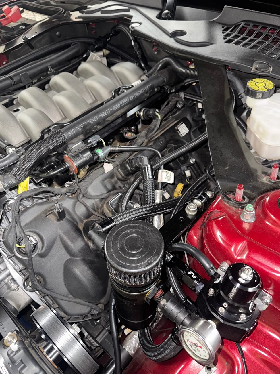

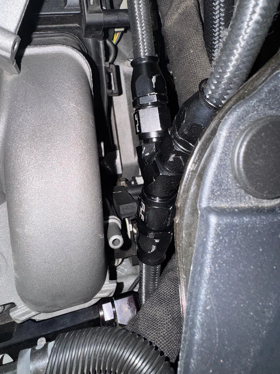

as promised, toon the cover over and got as much detail as i could off the pictures. please let me know if you see anything off.
thank you guys
