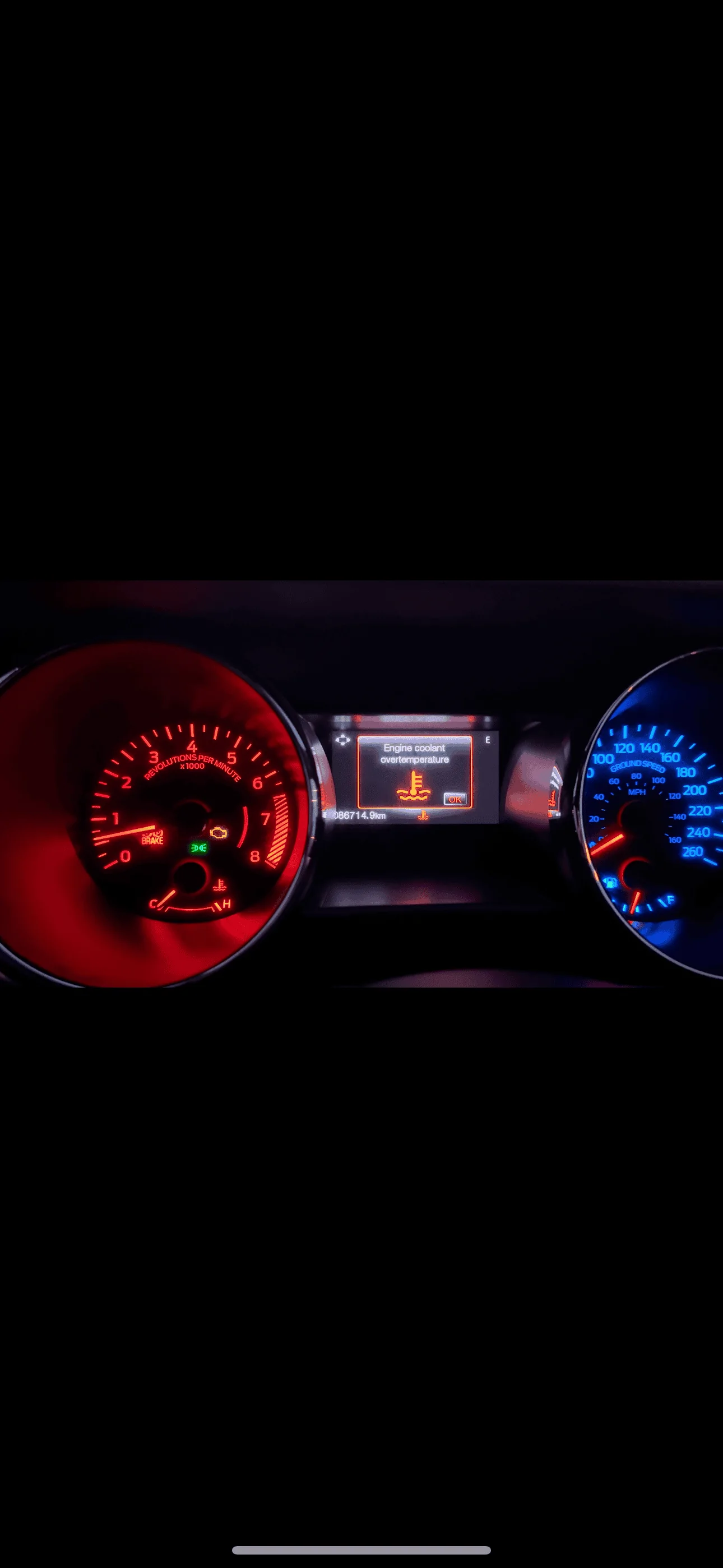

A few updates. I got the error code from Ford - PO308
Have flagged and passed on details from the group about the IMRC. I was trying to drive the car to the Ford service centre and experienced another whole range of issues which I was hoping you guys could help with, which I think is linked to the issue you described.
- Lost throttle power
- Engine light was now flashing
- Temp gauge went NUTS! like up and down several times.
- Gauge went red - Alert came up - "Engine Coolant Over Temperature"
- Engine surging
- Engine shut down
- Weird exhaust smell (when stopped and started again later)
I ended up waiting, tried starting again 30mins later. was 2mins in and the same issue. I ended up having to tow the car to Service.
What are your thoughts gang?
- Engine surging
- Engine shut down
My thoughts? They are incompetent at best or a band of thieves, if I want to think badly.
These symptoms are compatible with a blown head gasket. If they really pulled the head...
Run for your life.
