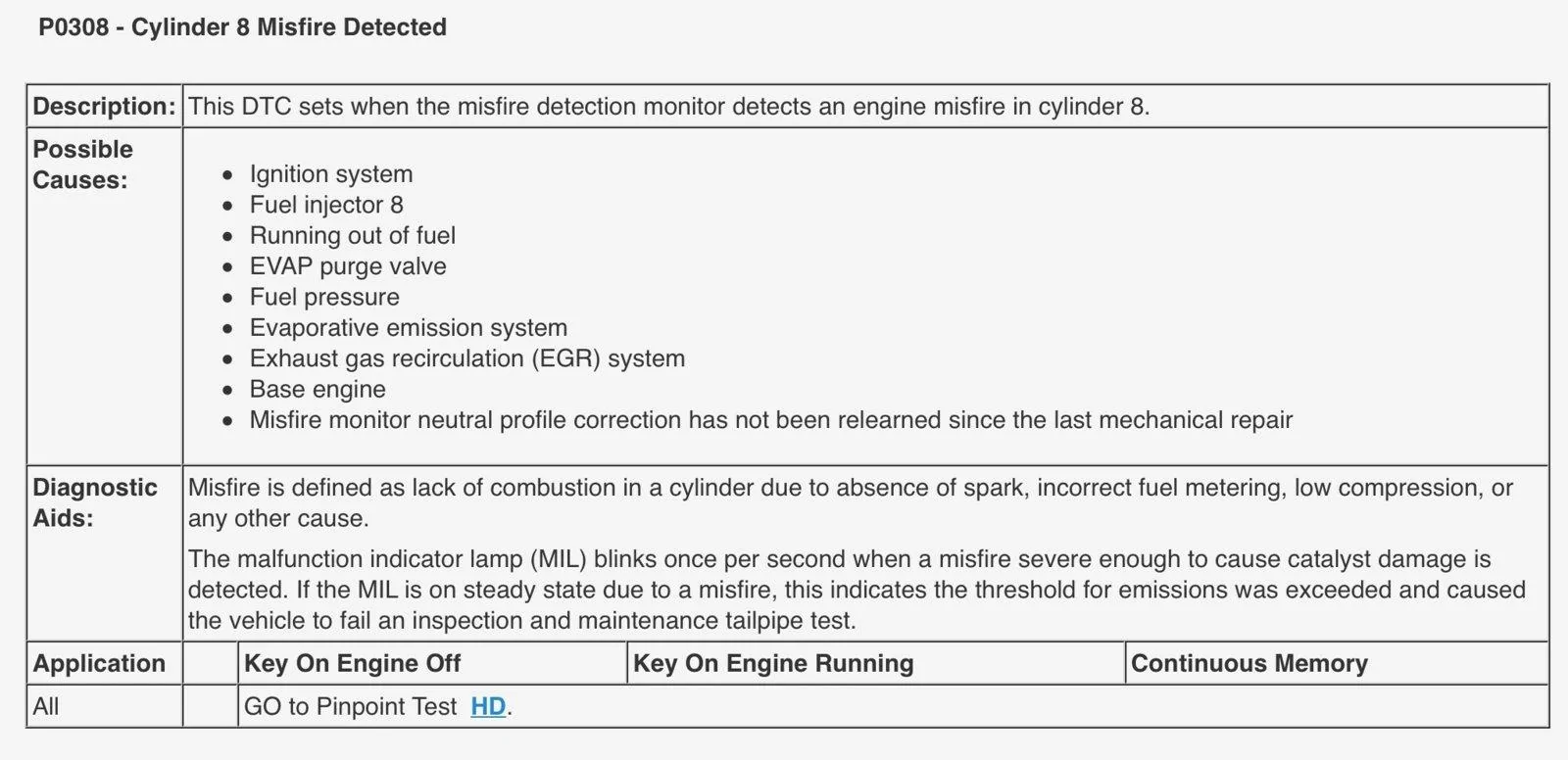

Here ya go, this should help:
Really useful link. Thanks for that. Beginning to think something was damaged like my crank position sensor when they replaced my clutch or the clutch wasn't installed properly.
Ahhhh.....! I didn’t know you had that type of work done, because.... if there is “major” work done to the transmission OR the engine such as where in either instance the trans or engine has been removed, then the shop is supposed to follow this attached SSM 45788 - which *might* explain your misfire symptoms:
You know it's funny as I had the issue you've posted there after the new clutch and fly wheel went in. The dealer tried the crank relearn twice using their system and I tried it 3 times with the naguge and it couldn't complete. I emailed Lund and got an adjustment to the tune which finally allowed the crank relearn to complete. After that it was fine for a while then started exhibiting the symptoms I mentioned above.
