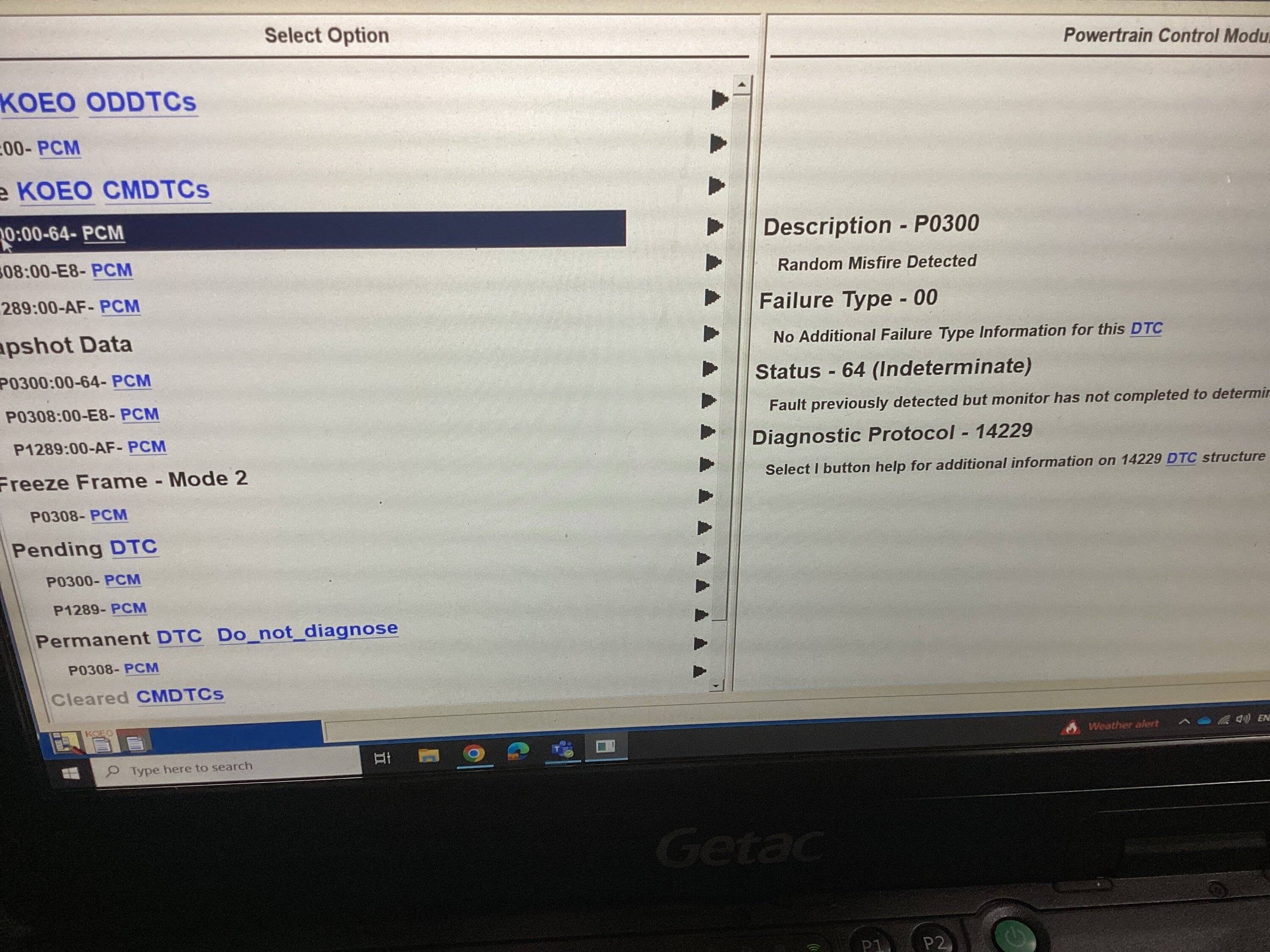

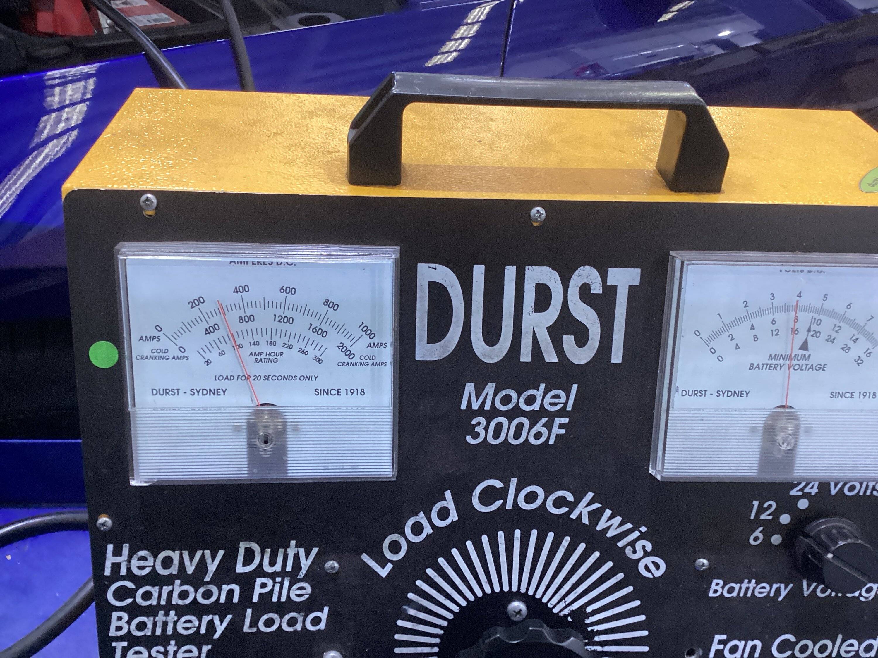

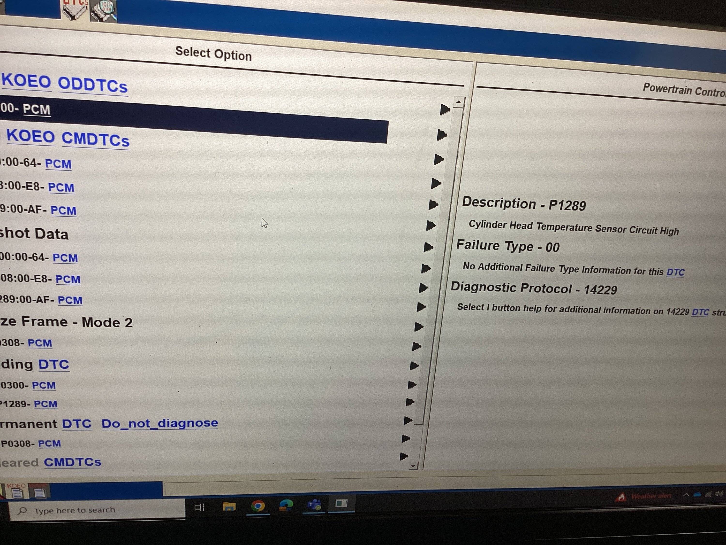

So the latest in this saga...
Been waiting all week for the inspection and plan moving forward since the PO300/P308/P1289 on the weekend.
I've given them ALL the intel they currently have (thanks to you guys and this amazing group on the other side of the world) to progress fwd, and inspecting this week they've said that they thought the car freak out with the coolant temp/gauge fluctuation/car shutting down was to the battery voltage being low/unstable - the battery is new (4months). It was around 8-10v which was surprising.
They were going to remove the intake manifold to check cylinder head temperature resistance, temperature sensor and circuit.
I made them check the IMRC/CMCV as stated by you guys and now they're saying I was correct in the assumption (which they seemed hesitant to say with 100% certainty) and that it was the rod. Now the cost seems STEAP so far. Working through it currently.

The intake is probably not related to the gauge issues you had. Newer vehicles seem to be really sensitive to voltage issues. When my battery died in my GT the dash did funny things as well, which were no longer an Issue after replacing the battery. I wouldn’t worry about that part too much. Batteries can be bad from the start.

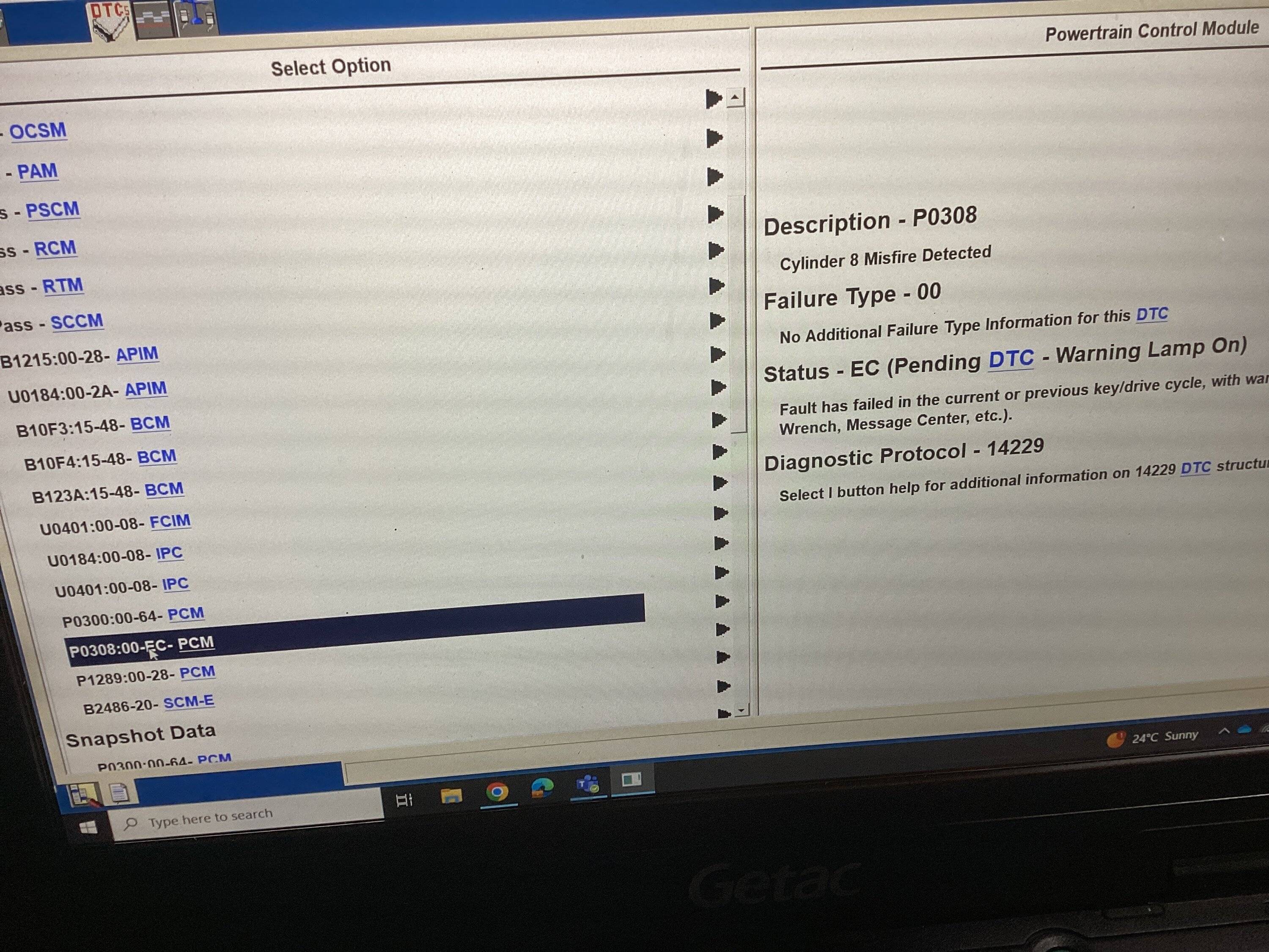

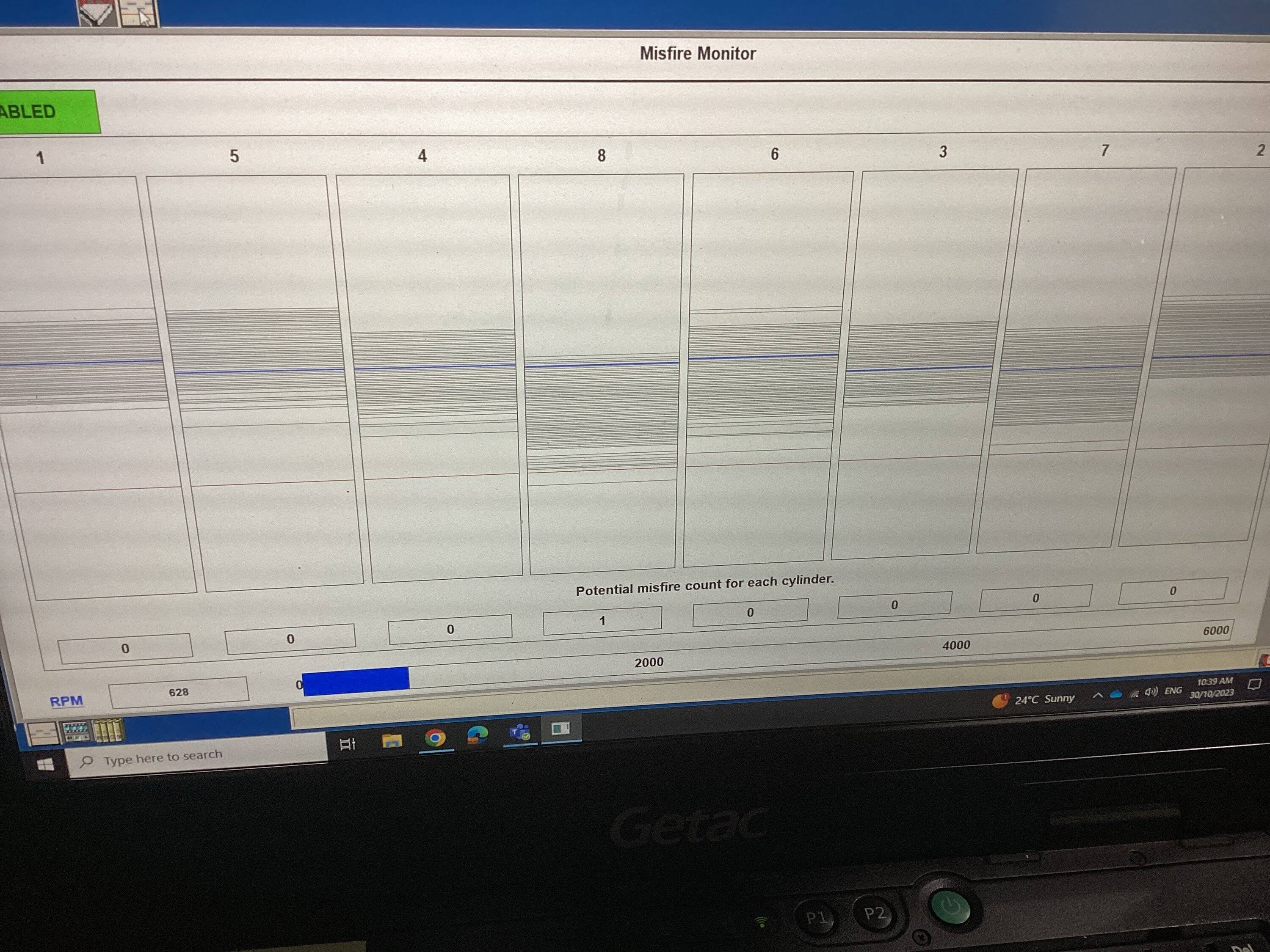

Hey Guys,
2016 GT owner here from Australia here. Just wanted a more global advice on my issue currently.
About a month ago had a 90,000k service. Car had only done 81k. Car has come back out and the engine light has come on.
So I've sent it back into Ford. They struggled to find what the reason was. So they've changed all the spark plugs and re-timed. They went out tested, the light was off.
I had it back for a day, then the engine light has come back on. Sent it back in again.
They claimed the 8th cylinder was misfiring. They took the head off, inspected. I was asked what fuel I use. I said its had nothing other than premium 98 since I first bought it. They claimed the cylinder could have carbon build up, and to service it with the BG performance service - adding additives in the engine and fuel system. They dropped the oil again, re fitted filters etc Filled up with new fuel. They had the car for a week, tried to let it run through having the dealer principle (a mustang owner) drive the the car during the week to allow it to run through. The Engine light was off again at this stage.
I've had it back 4days. Engine light was off, with a quarter of that fuel left with the added additive left. Last night the engine light came back on.
They're claiming if it were to come back on, I'd have to do a deep clean of the engine/all cylinders with the heavy duty machinery, or send off parts to head office?
Has ANYONE had this issue in the states? I don't have an endless supply of funds to keep sending it back and forth without a precise plan of attack.
If so, what was your plan of action on your car and what did you do to fix the issue?
ANY HELP would be amazing!! Thanks guys I appreciate it!
Cheers!
Broken Swirl valve/IMRC shaft. Take the intake manifold off and see if the flappers are loose
