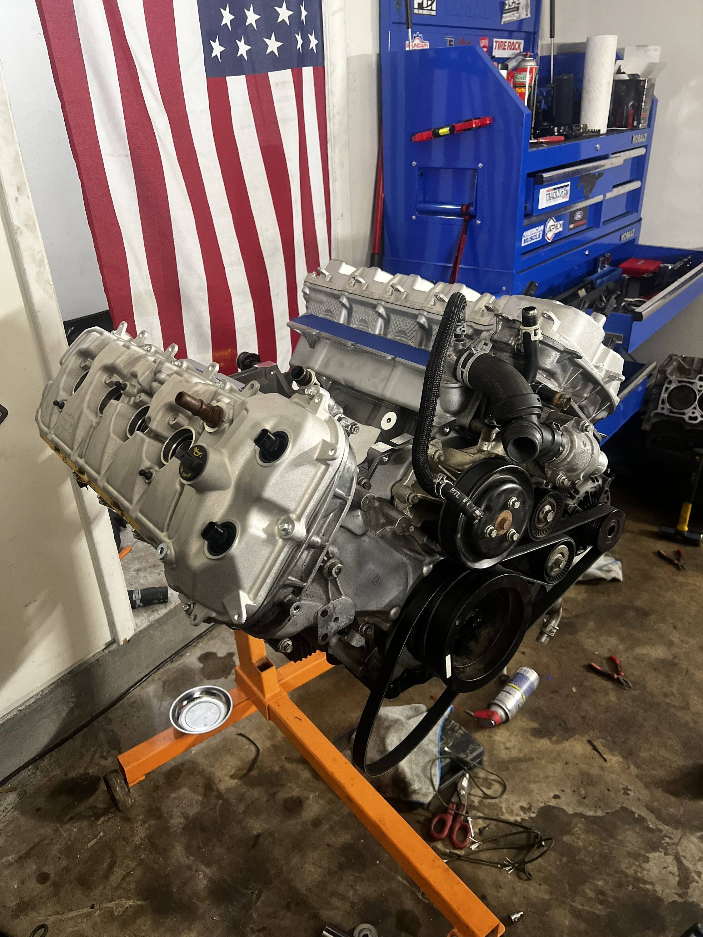

Alright, hey guys I’m pretty new around here and I’d like to show off my 2016 Ruby Red Mustang GT.
I occasionally track the car about 3 or 4 times a year and a lot of road trips. I Recently built my 2016 5.0 coyote because of bad rings on the original motor.
So i went with a brand new Gen 3 block still the same heads and upgrades as follows.
-Boundary OPG and crank sprocket
-Boss 302r exhaust cams and valve springs
-Ford Performance chain
-ARP cam cap bolts and crank bolt
-Apex Torque head studs
-High RPM Competition Pulse Ring
-All new seals
-GT500 valve covers
-MMR Valve Seals
Other then new seals and stuff that’s all that’s been upgraded. The only things that stayed the same are the valves themselves and the same gen 2 heads but resurfaced and cleaned.
Finished product came out perfect and i really took my time with this to do everything right. So far 8k miles on the build with no hiccups or problems BUT…

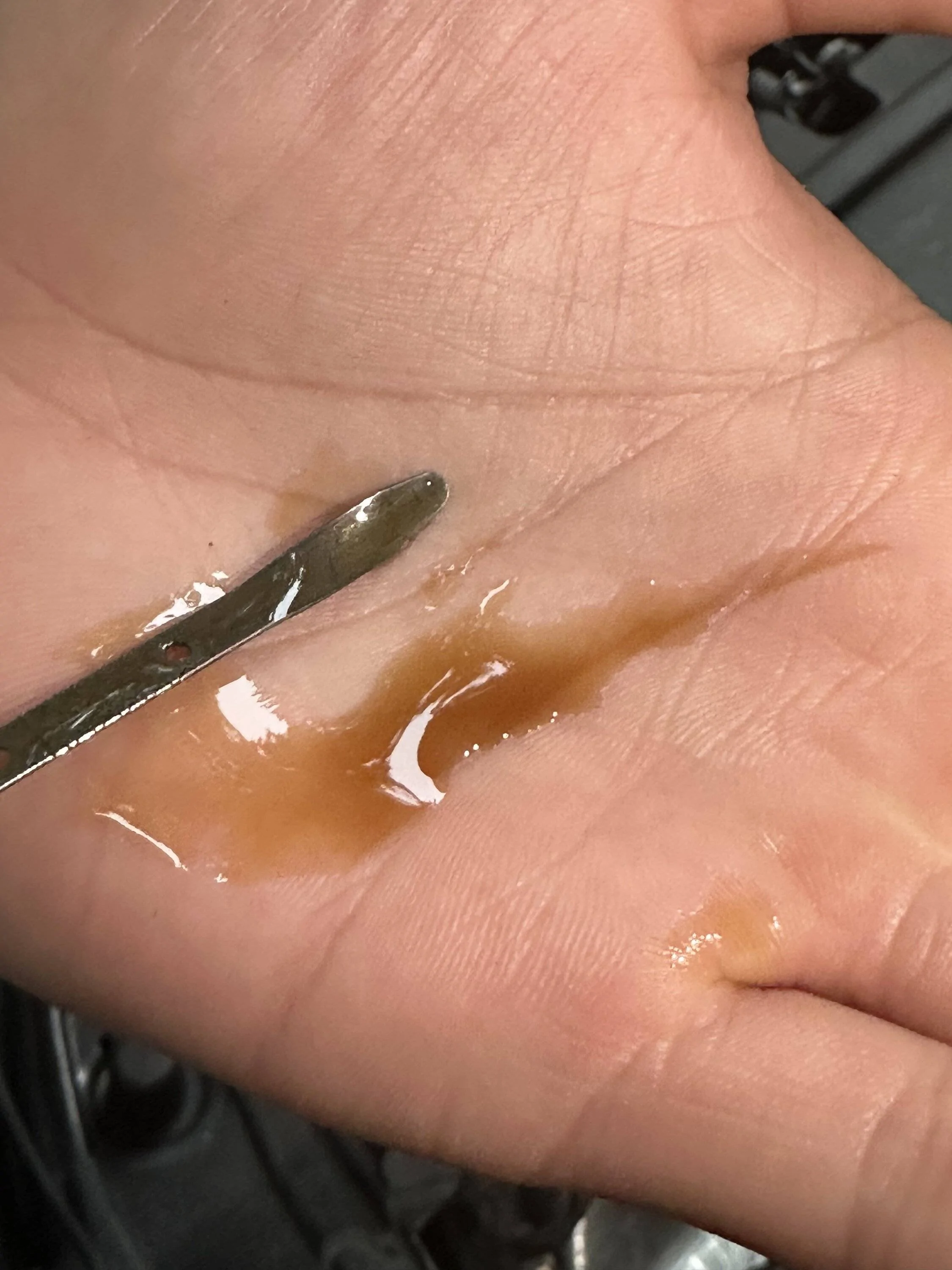

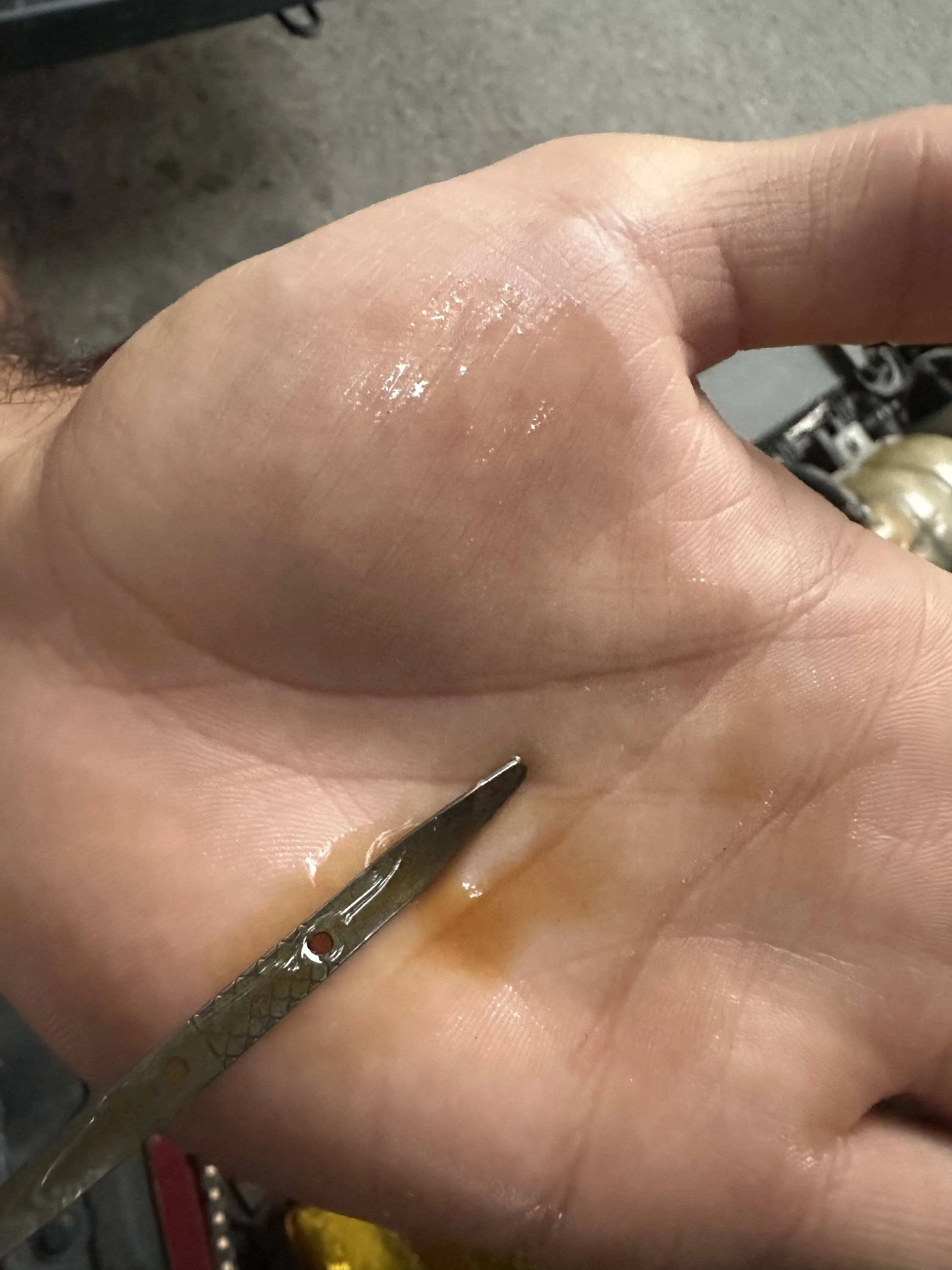

So the car hasnt been running for 2 days and this was the oil so far, i think it is a head gasket because this oil only has 1k miles, if this is that “milky” texture everyone is talking about then you are right, thing is when i drove the car back home after it over heated, it was about an hour away of just limping it home. The oil looked exactly like this as well before when i brought it back and checked right after. My nose isn’t very good but i was told it smelled similar to coolant.

Ouu that looks very bad, shit I’d probably have to wait to drain it then because I’m honestly lost on what it is because my oil looks nothing like that.
A head gasket failure doesn’t always allow coolant to contaminate the oil. Depends where the gasket blows out.
