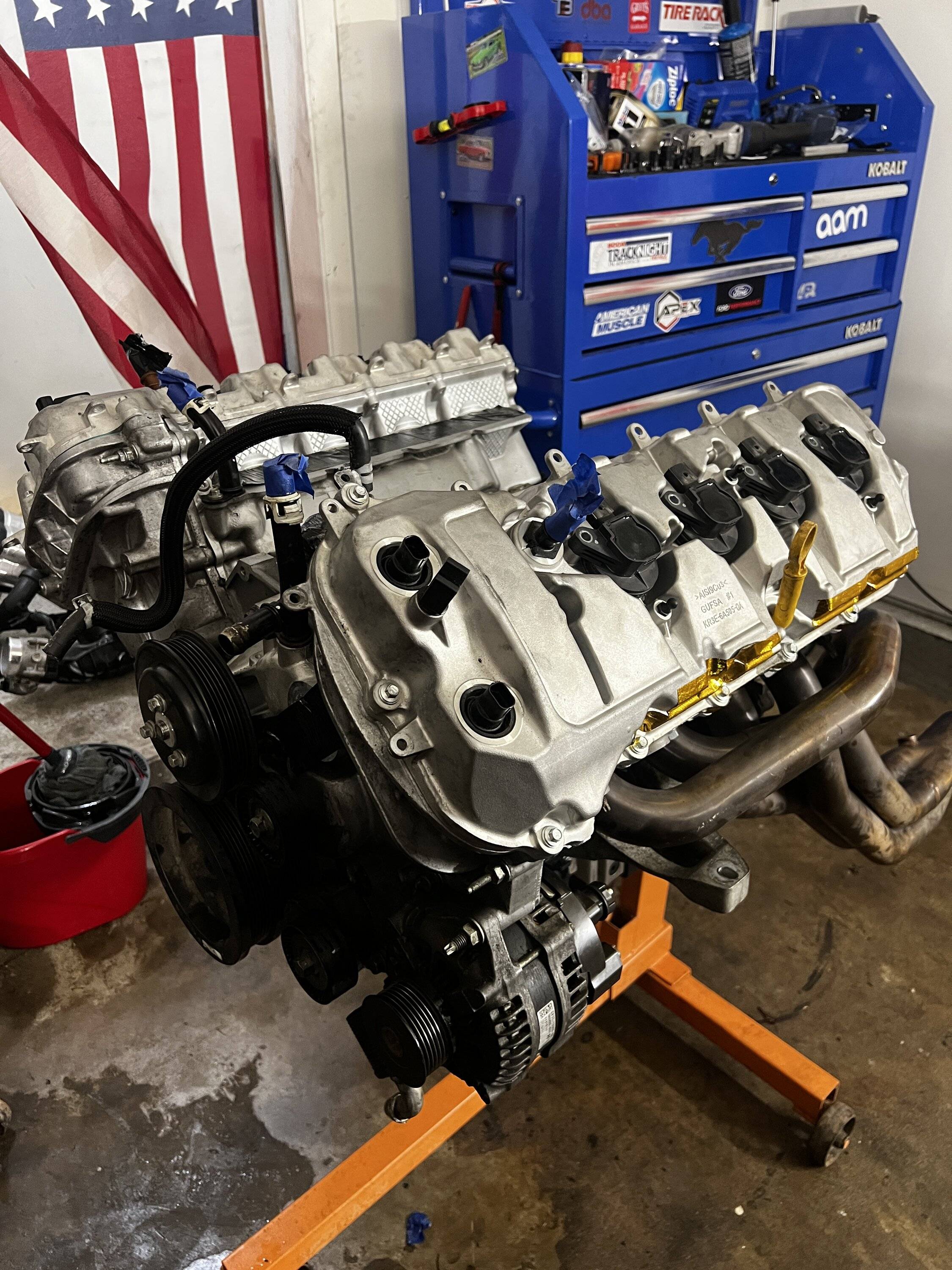

It’s all good! I worked on the car myself, i took my time with everything as well. Took me about 3 weeks to complete the long block and that’s just because i was taking my time. The car had 9k miles and I’ve taken it to autocross and private track days, road trips up north and south so i am not sure how this could have happened, no signs previously to lead up to this, it just came out of nowhere. I haven’t driven the car any differently. Now building this motor a new part that i mentioned were Apex Torque head studs, I’ve never heard of anyone using these and i couldn’t find much info, at the time arp head studs were out of stock everywhere. So if this whole problem was because of that, i would be surprised.
Now again when the car intentionally overheated, i let it cool down and limped it home which was about an hour away with numerous stops, oil looked perfect. Then only turned on to get on the trailer and off the trailer once the car was back in SC. Drained the oil and boom! Chocky milk.

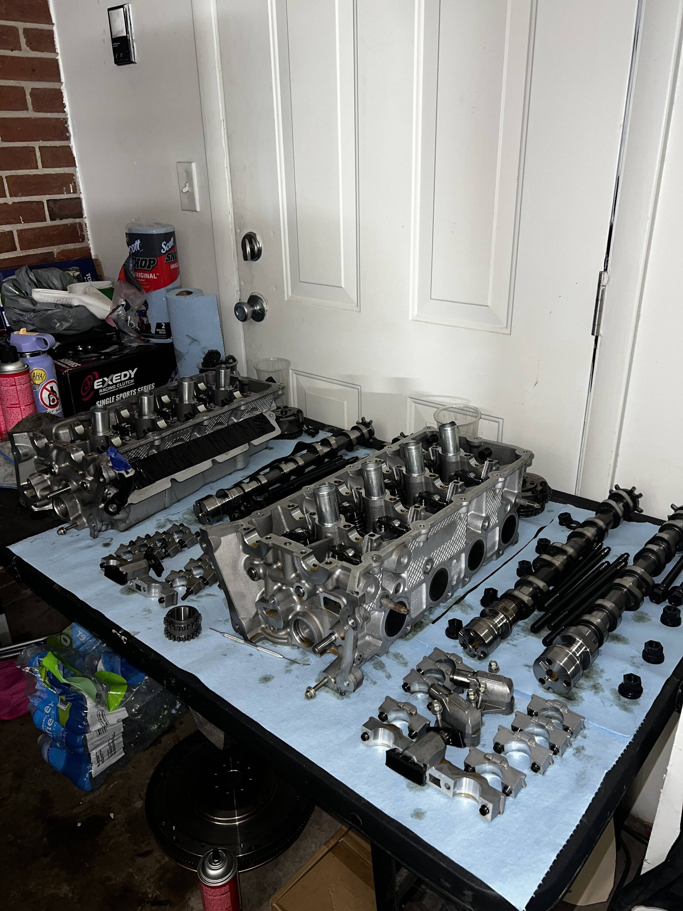

So Sunday i took the motor out within 3 hours! I kinda didn’t have any motivation on working on it at the same time. Now i had to leave back for New York and the motor was sitting for a couple days and i will get into that later.

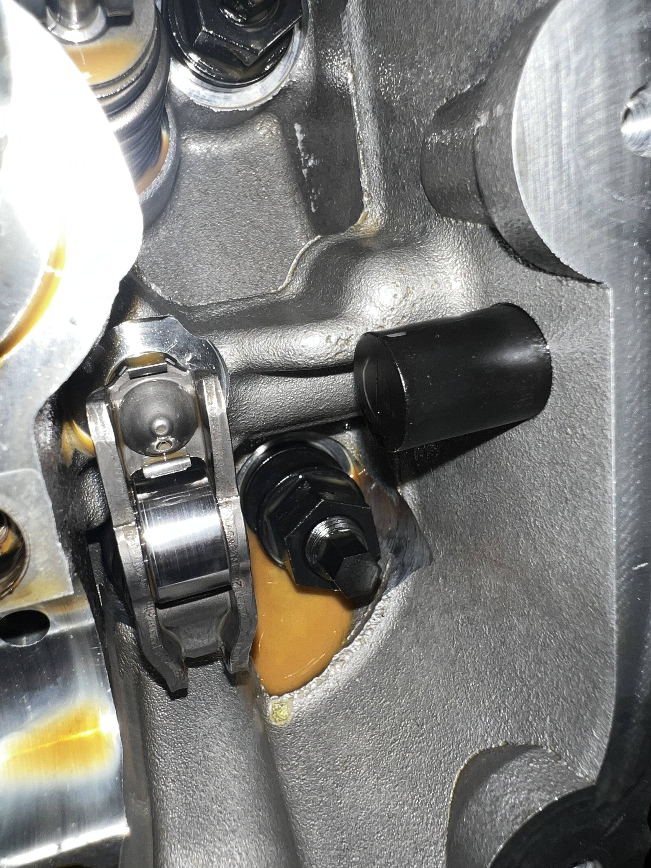

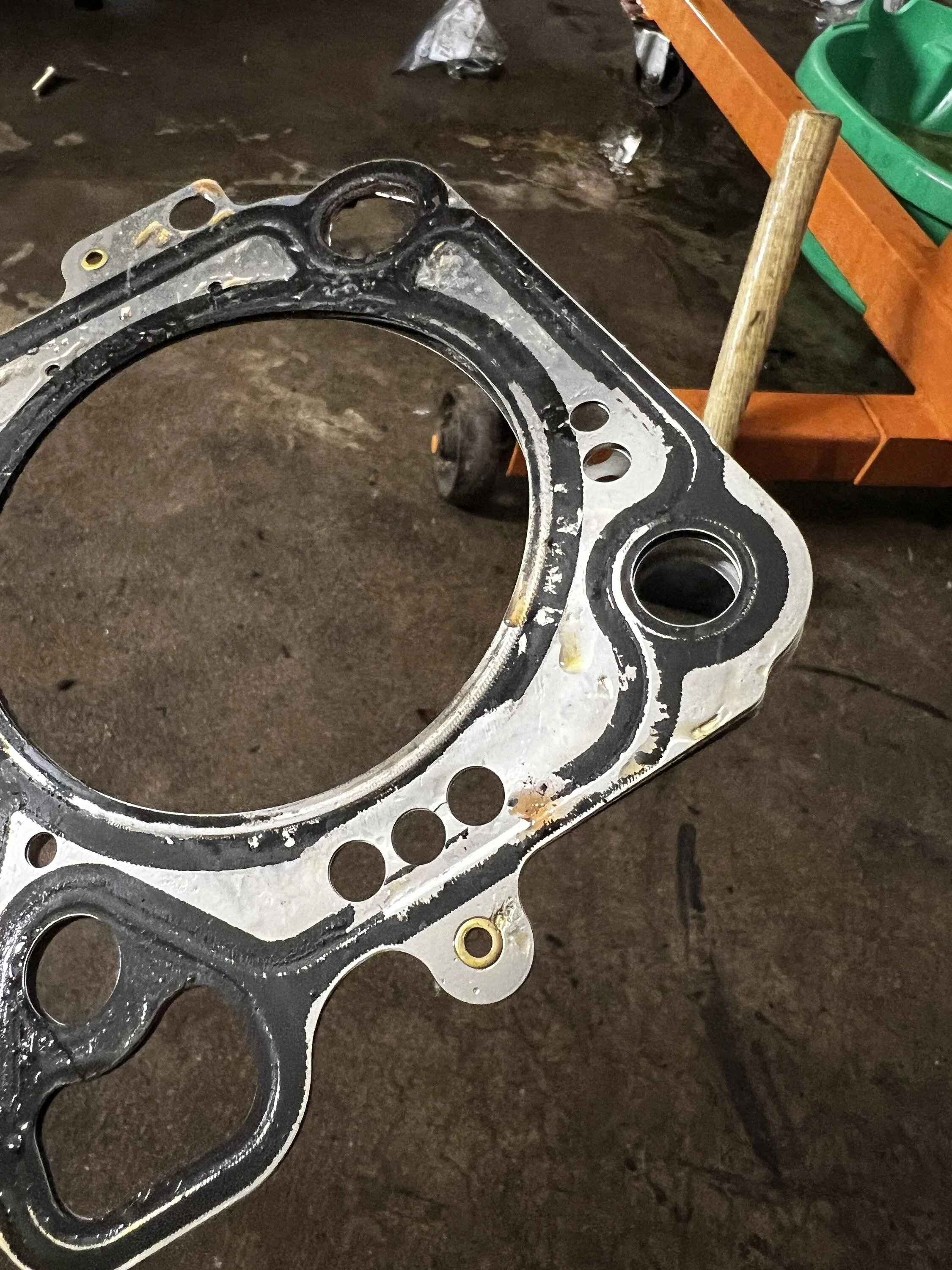

So good news and bad news. Bad news first, so taking all apart and it seems like the head studs backed out, and as i were taking off the other ones, some were loose and some super tight. Now I’m no idiot and honestly i have no idea why it was like that. These are Apex Torque Head studs and i am not using them again.
Now for the good news! Nothing is warped or burned! Took the heads to a machine shop and they are just as good as when i got them. No damage to the bearings or anything at all. Everything measures out perfect. And crazy how every other bolt and nut is tight and to spec other then the head studs, just disappointing.

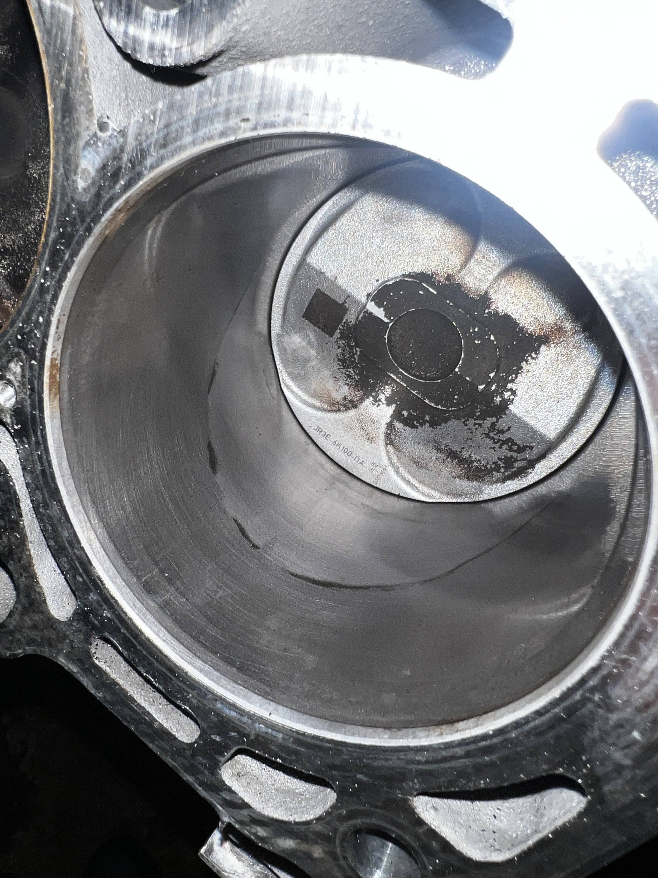

Now i do have one area of concern, since i said before, the motor was sitting on the stand for about 3 days and what i saw was a pool of coolant/oil mixed on top of the piston when i took the head off. I cleaned up the coolant/oil mixture like it was nothing serious but it left this line. Should i be concerned? The surface is still super smooth and I’m not sure if i can rub it off or not, i tried some brake clean and a rag but nothing. Is the cylinder fine and good to go still?

Try rubbing with tooth paste.

Also OP, I wouldn't worry too much about the staining if you can't feel it on your finger. It's also probably wise to try and clean up the bottom end as best of you can of the old contaminated oil, it tends to be hard on bearings.
