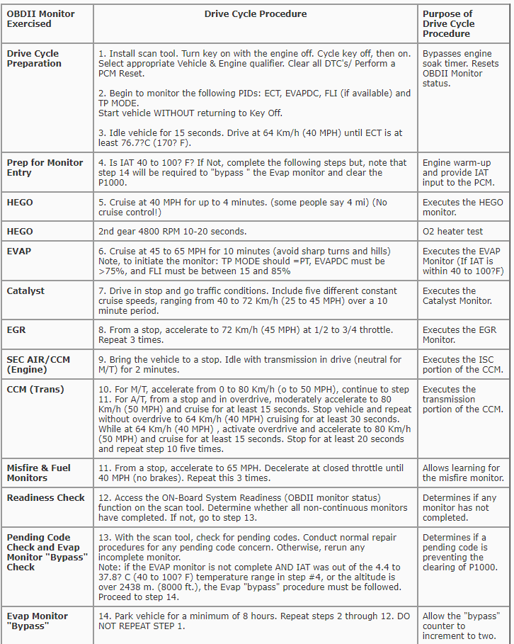

Someone posted one time, and I can't find it, the exact parameters to get the readiness good to go. It was an awful lot of varied driving. So if you are just pounding highway miles, it likely won't become ready for a while.

Ant update to this. Replaced my battery last year and currently in GA with the same failed readiness check. Have driven hundreds of miles since the battery replacement. Ans did another 170 up in the mountains and highways today and still not ready. About to start the arduous task of going through thr drive cycle one by one.
Nope it hasn’t passed still. Luckily cops have been behind me and never pulled me over. I keep the emissions papers in case. Maybe we can have a drive cycle meetup lol
