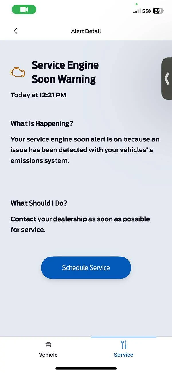

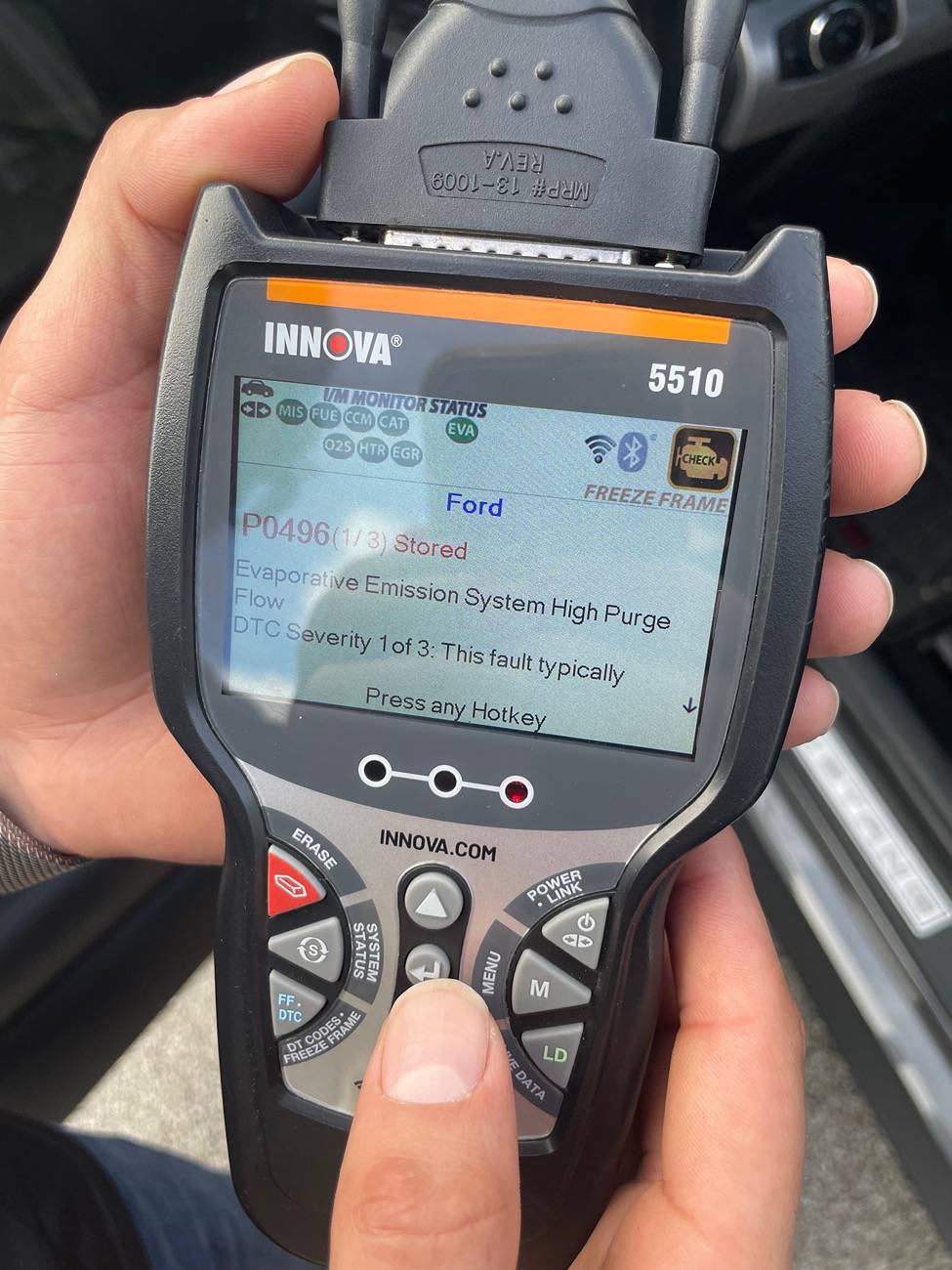

Any idea what could be causing this on a stock car other than a catback and drop in filter with 12k miles? Taking to dealer tomorrow just curious.

Evaporative purge valve would be a likely suspect. Usually a $50 - $150 part. They fail fairly often especially if one tends to top off the gas tank.
