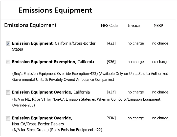

GT Pony
Mar 13, 2015
77
9,402
4,839
Pacific NW
Here's the scoop on available emissions configurations on 2015 Mustangs. To not have CA emissions the car would have to qualify as described below.
