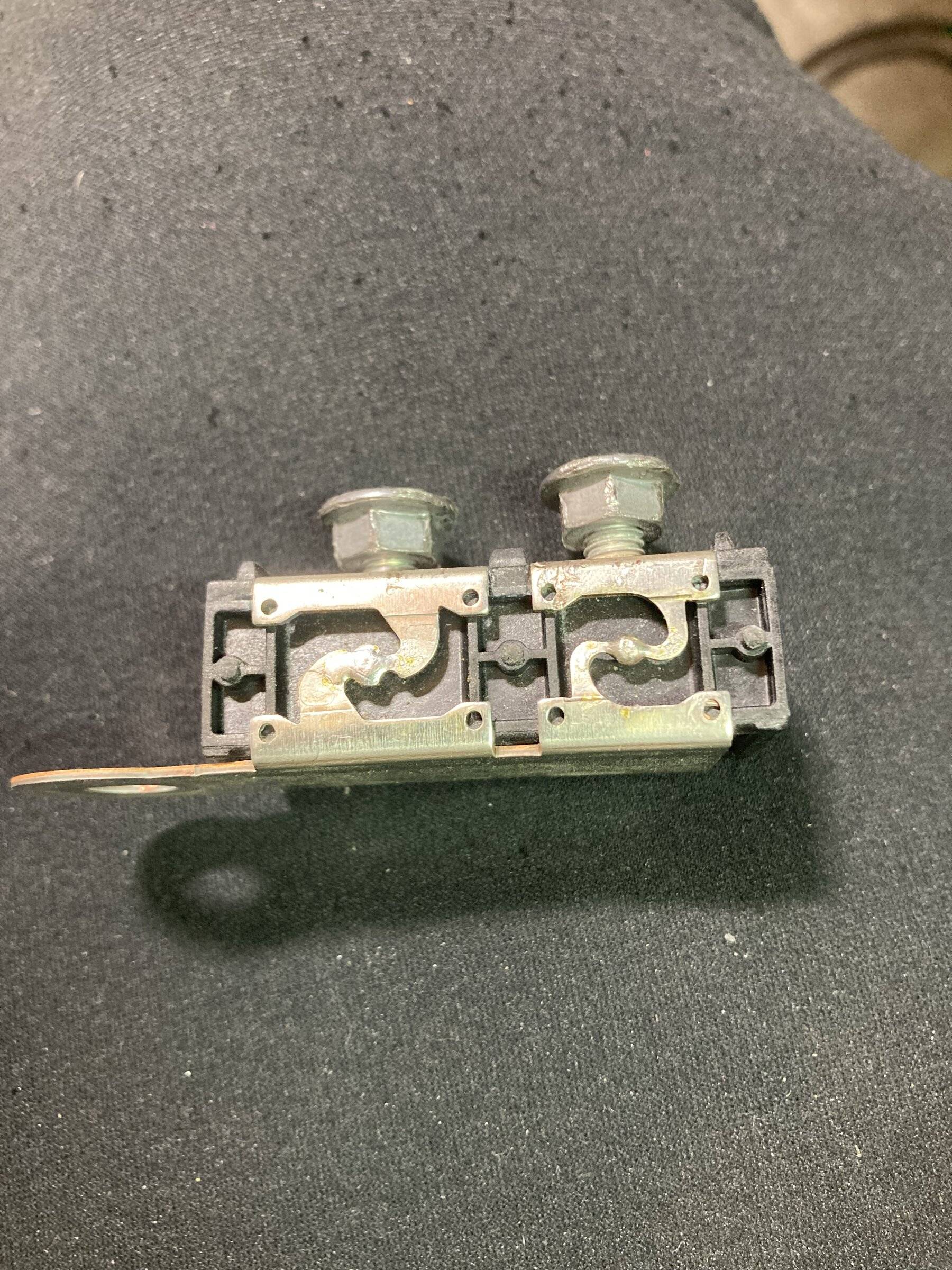

Fuse looks good, can it still be bad?

Check continuity between bottom plate and top threaded studs to be sure it's good.
