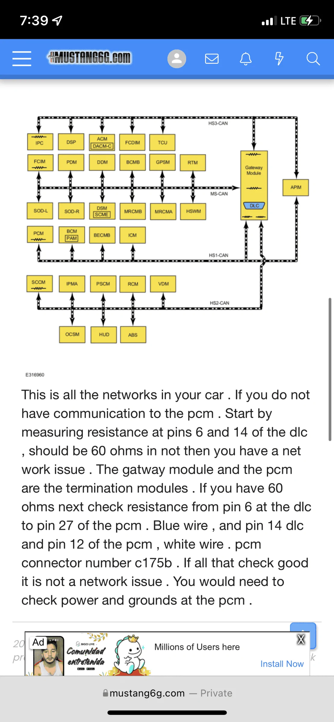

Might have found the culprit with the help of fmc_smt.
I have no connection between the blue wire and pin 14.

SOLVED - replaced fusebox with the harness connected to it and car fired right up. looks like alternator is overcharing a bit too and we are thinking it has to do with the way the boost leash is wired
