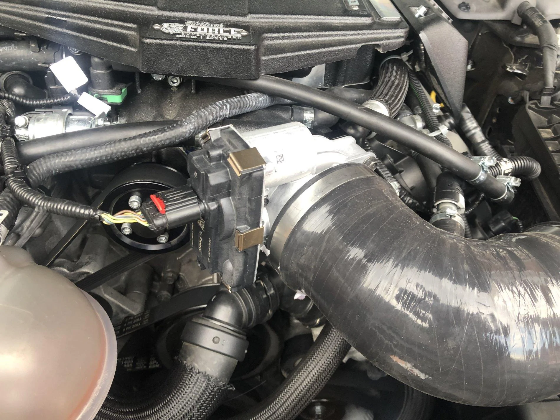

I have the GT350 TB on mine and tuned with no issues by Palm beach dyno
Car drives fine. No surging etc.
Just be aware the TB does touch the underside of the bonnet insulation.
Did you have to use an adapter?
Yeh there’s an adaptor needed as the bolt pattern is different. The Edelbrock CAI comes with the adaptor bit I didn’t know this and ordered one from Jegs.
https://www.jegs.com/i/JEGS/555/513060/10002/-1
I have the injectors that come with the kit.
But also have a JMS BAP. Currently at 640whp
Injectors are the same as 13/14 GT500.
