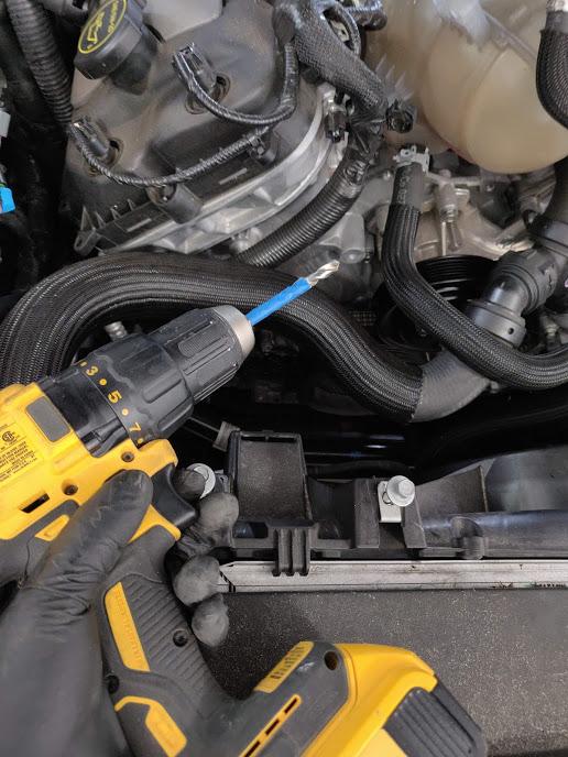

Thanks! Guess I have to get a 90* drill. Was hoping I wouldn’t have to but that’s not the case. Does the tap come with the kit or do I need that as well?
Thanks again!
Yes, but and tap both come with it. OH, and you’ll need to get a fuel line removal tool for the connection at the firewall if you don’t already have one.

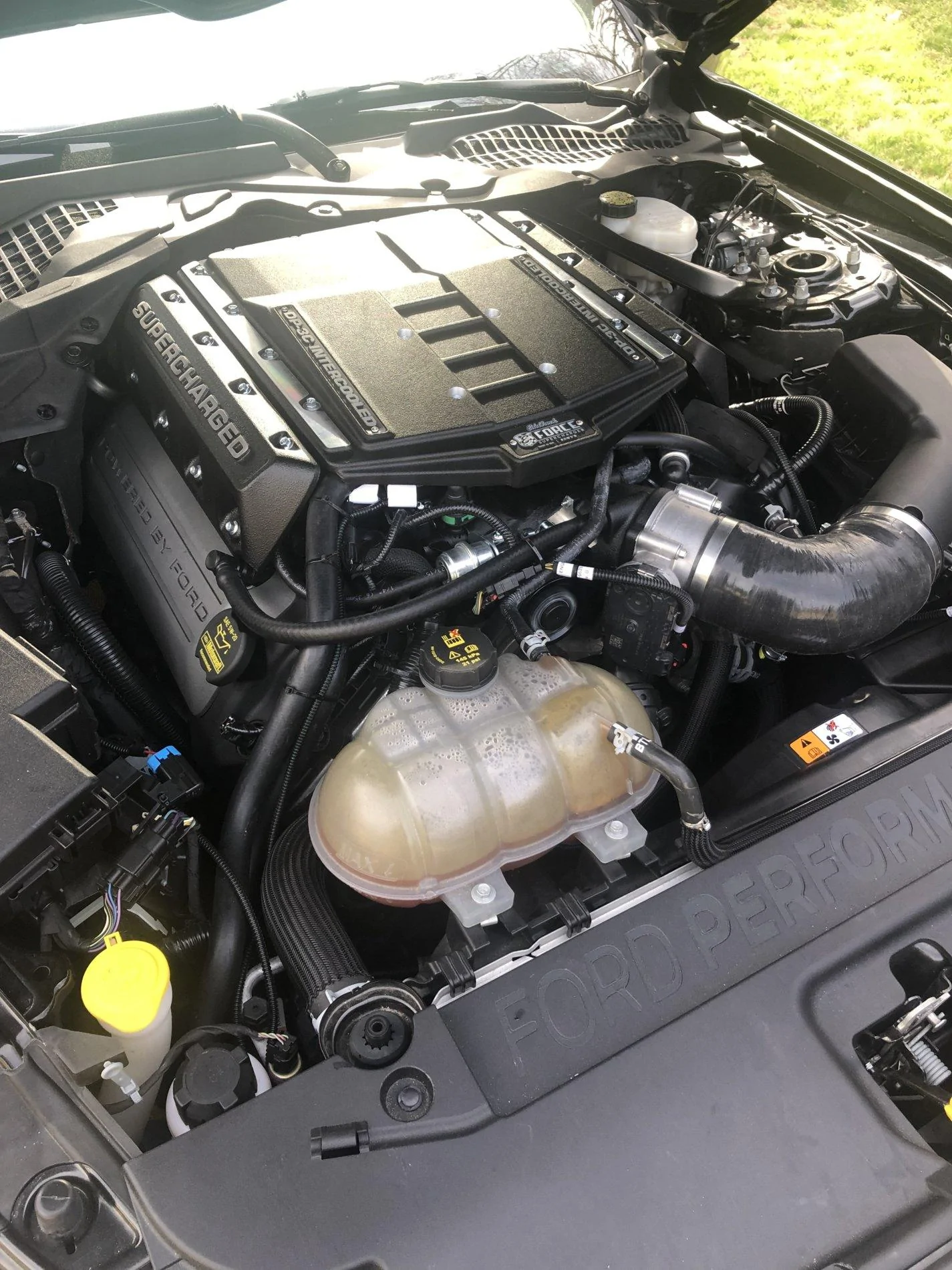

Ok, got mine in last week and installed this weekend. All works fine but I have a couple of questions? Did anyone do anything with the connectors taken off of the back of the stock intake? By my count there were 4 connectors to unhook. I looked all over my instructions and did not seem them referred to again. Next, I have zero oil pressure by the gauges. I have oil and the car runs fine but somewhere in the wiring, my oil sensor stopped working. Could one of those disconnected harnesses from the factory intake be causing this problem. I would call Tech Support but they are closed for the weekend. Otherwise, this thing is phenomenal!

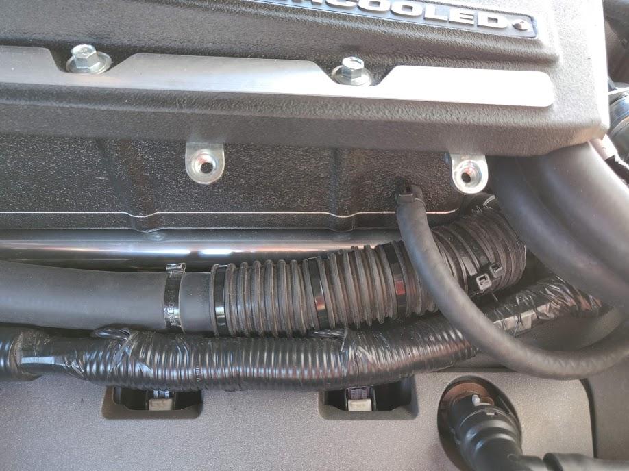

On my base, I only have the normal reading next to the oil pressure. Most of my install gremlins are squared away, the only thing left i don't like about my install is that the passenger side heater hose is touching the fuel rail. Is your's like that? I think it's because the length of the hose is not long enough to give it the slack it needs. It was bound to rub a hole in it. I had to cut up a vacuum hose and slip it on there to give it some protection.
Thanks again!
My dewalt drill fit with no problem. I actually bought the 90 degree attachment, but ended up not needing it.
Thanks. I think I’ll buy the same and be prepared and return if not needed.

I bought a 90 degree adapter, didn't use it. My DeWalt drill fit as well. Yes the fuel clip removal tool is necessary. Luckily I had one from my N2O days. I agree that the water hoses are stretched in this application. I will watch for any wear or pad them like above. Coolant leak is not with the new radiator, looks like I got some air in the system when refilling the factory radiator and it may have burped some coolant out. Hope thats all! The no oil pressure was tune related. Revision tune now has oil pressure.

Well, when the tensioner broke, a piece flew of and landed in the radiator. Took about a day for the temps and pressure build up enough to produce a coolant leak. Checked all hoses and could find nothing. Removed the radiator to replace and found the missing piece of the tensioner casting. Luckily my son had an extra Fluidine performance radiator for the mustang so it is now installed and working well, no leaks. Working with Lund on the tune. Engine does not seem to free rev as easily and seems to be flat until around 3200 rpm, then watch out!
