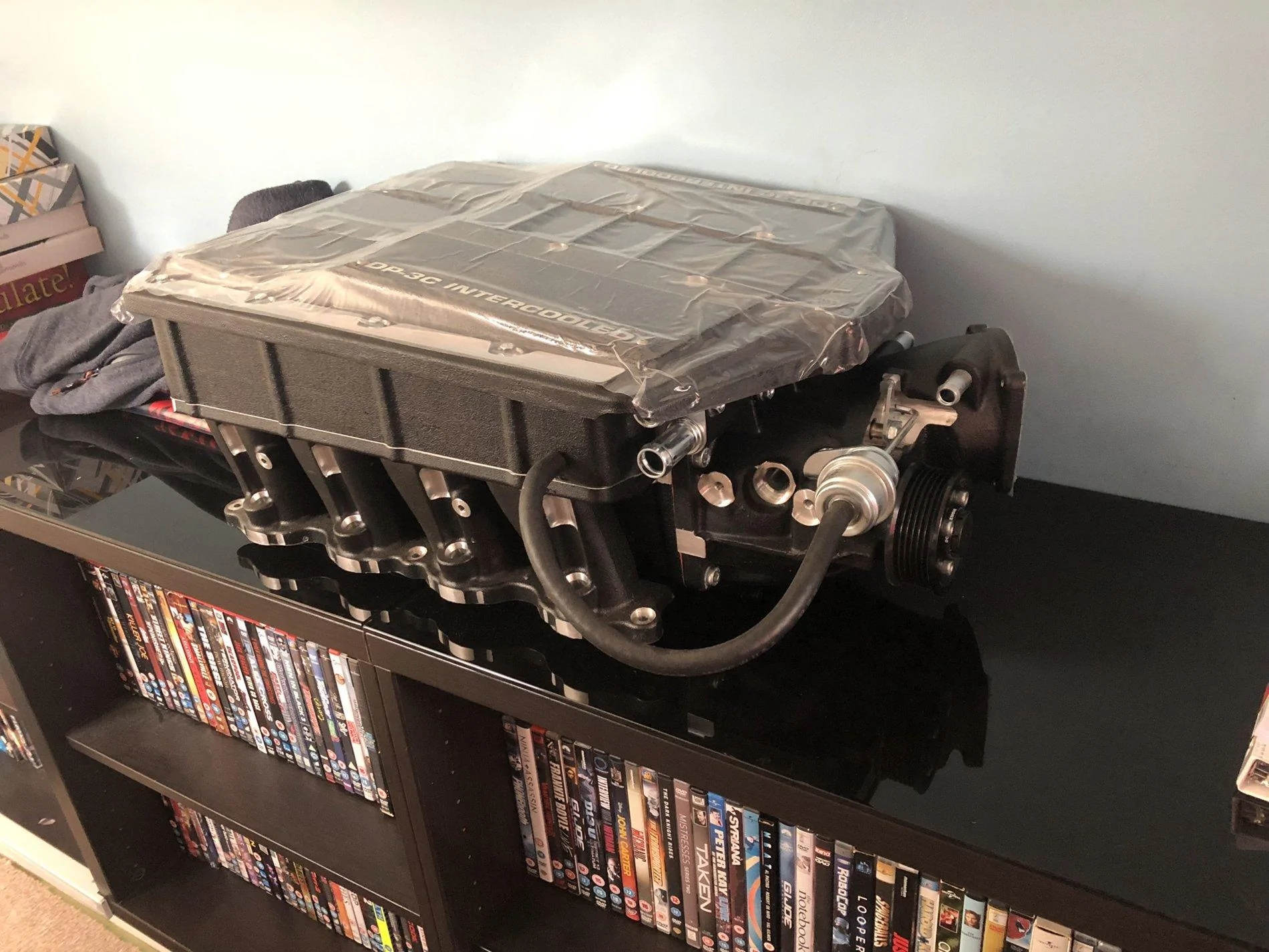

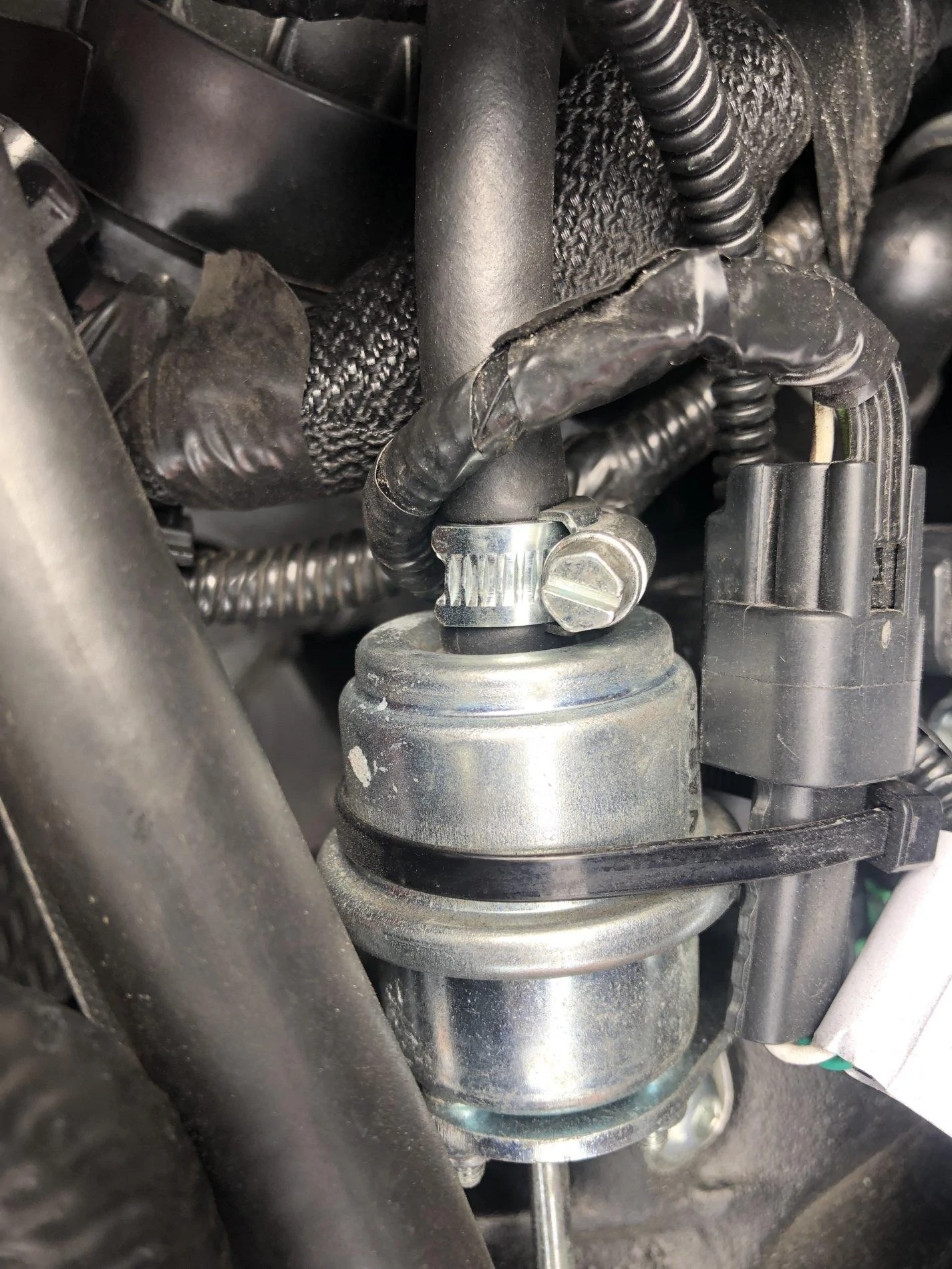

Just want to add to this, In the pic below to vacuum line from the body to the actuator was just fitted as in the pics (arrived out the box like this) and i over looked this completely. When building up throttle it felt like it was holding back and then it would just go like feck.
I've just added hose clamps to both ends of this and it is a different car to drive. so much smoother and the power builds as you would expect from a supercharger. Before it was like driving a big turbo 80's car where there was nothing for ages then a huge explosion of power.

can you post a pic of what you did to resolve?
thanks

Used two 12mm hose clamps/jubilee clips. One at each end.

@CraigJ I think mine came with a zip tie holding the line on the runner side, nothing on the valve side. I did the same thing as you while I was trying to diagnose my run issues (I spent most of my 6 week troubleshooting thinking I had messed something up, looking for leaks, etc).

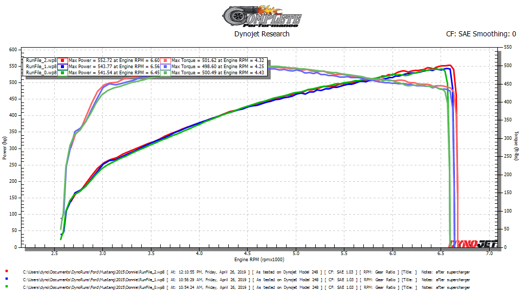

Dyno went very well 4/26 552/501 at the wheel. Tune is very conservative. Pulls like a freight train. Timing is capped at 18 degrees incase I get a bad tank of gas. I absolutely love this kit. The ease of the install and looks great. I could go to the extreme on the tune but; why? I left some HP on the table by not running it out to 7200K. I know Edelebrock should be proud of these kits.
EB e-force: 2300 DW95 injectors:
VMP BAP: Stock TB and Air Box. Filter EB sends in kit. Lund Racing Tune.
The best look installed system on the market! View attachment 360228

How much hp do u think u left on the table? Looks like with that setup there should be a good 100hp or so?
I would say conservatively 40-80. I don’t know what I was thinking!! Didn’t really think about till I got home. I will go back soon because not knowing will drive me crazy..lol
It was still climbing.

Mine ran 554whp on the stock Edelbrock tune. 620WHP on a custom tune.
Not really sure what you have paid Lund for?
