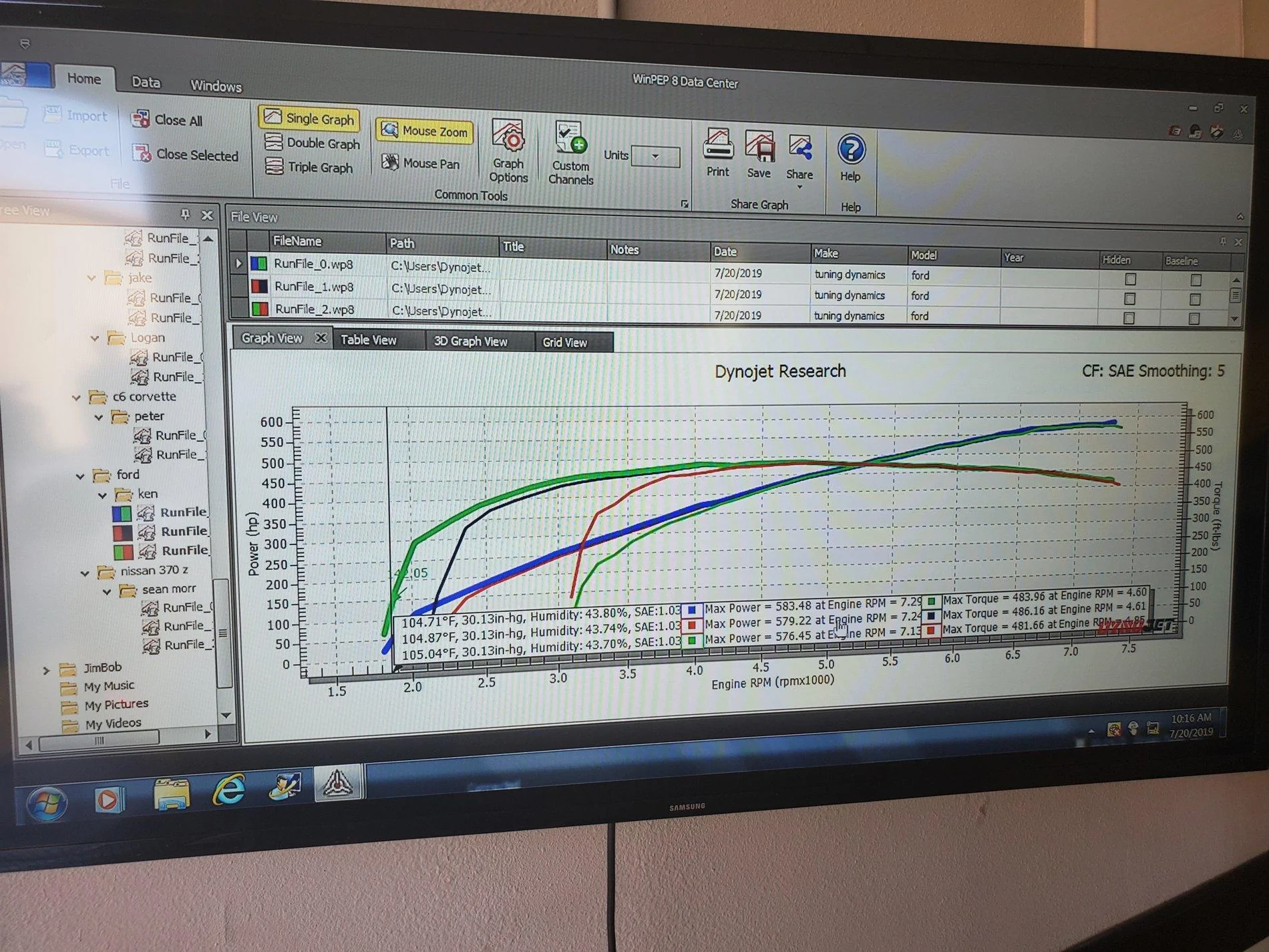

1st dyno since the install. Not what I was hoping for but it is July in Florida. Note the temps. Was hoping for 600 to 620 RWHP but I'm not disappointed, it still runs like a bat out of hell!
I’m right there at 583 WHP and it can still break the rear wheels loose in 4th. It’s the torque that makes the difference!
ugstang17
Oct 26, 2018
1,321
693
unknown
none
^^^ Its just a number. Take it to the track on a pair of DR's and see what it will do. That is where the real truth resides. As a good tuner friend of mine says, "If you want a big HP number go find a dyno that will produce one". We all get caught up in the number, but he's right. If the number can't be backed up by a stellar pass at the track it has no meaning. So go bust one off.
