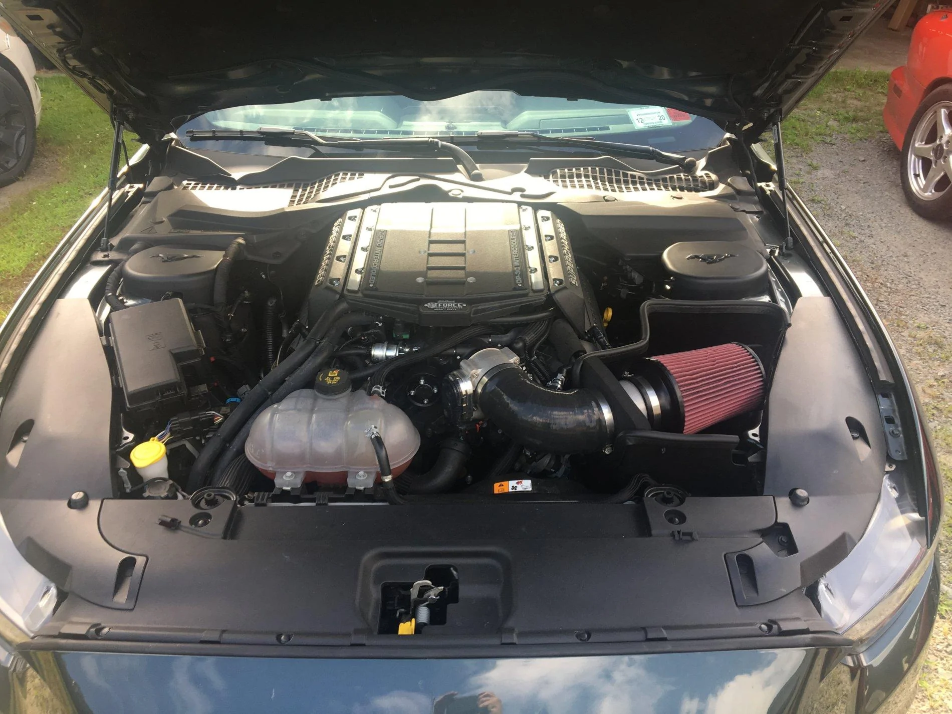

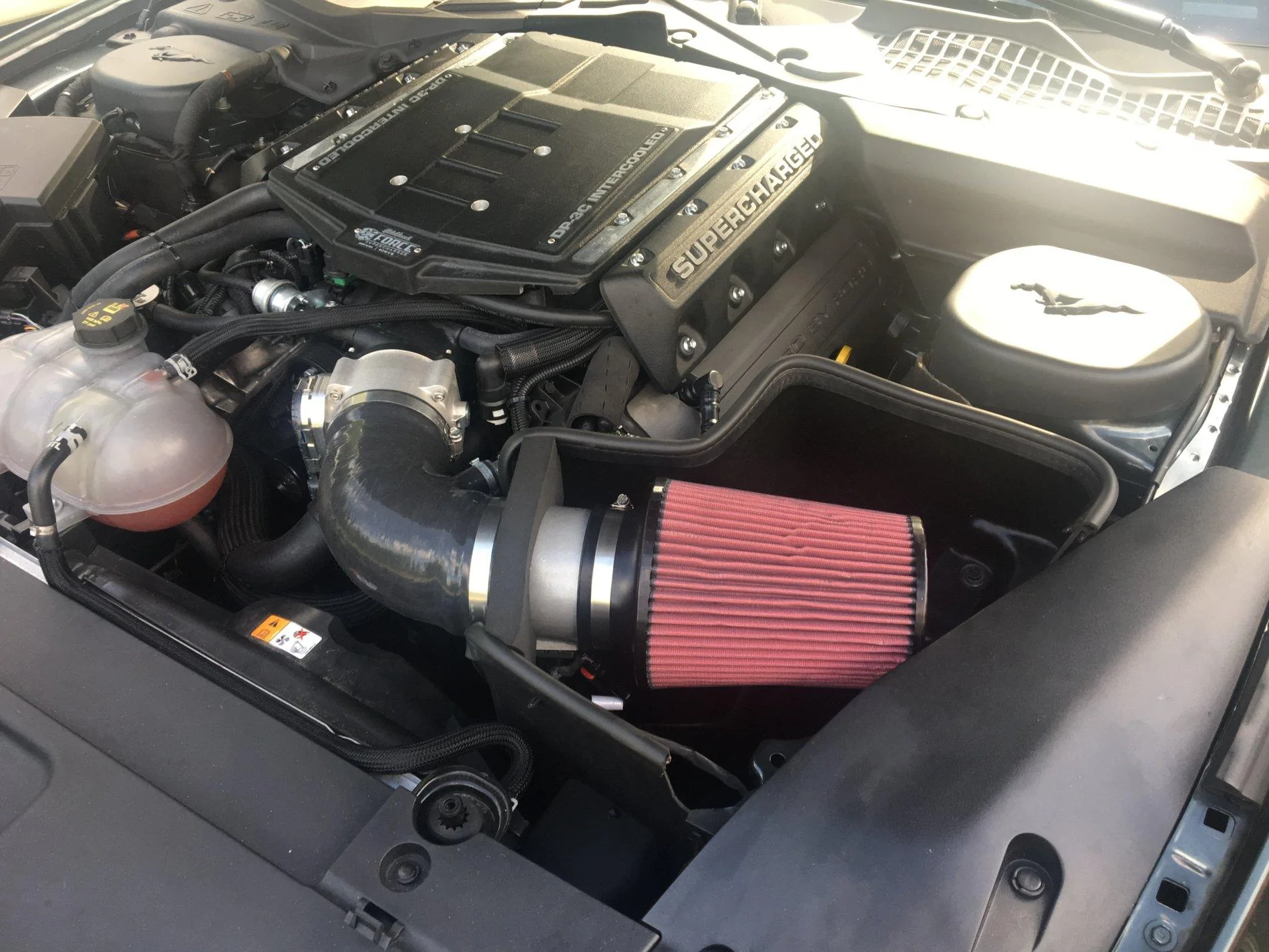

Here’s photos of the intake setup. I just stretched the Edelbrock coupler over the MAF and throttle body. Not ideal but it does work, hopefully the flow is worth it. The heat shield is from a JLT kit a buddy used the intake for a coyote swapped car.

Looks good!
Pseudo stage 2 for sure!! I like it!
How are the intake temps?
Nothing a little KY couldn’t fix to slide the tube over the TB and MAF!

I’m noticing IAT’s about 5-7 degrees warmer then when I had the stock air box. Hopefully the increase flow makes up for that. I would have liked the upgraded Edelbrock sealed Cold air but they were still in the $850 range when I put mine together.
I’ve only pulled it to 6500rpm so far and I’m already extremely happy with the gains. I’m sure most of that is in the tune. Honestly wasn’t real thrilled with the edelbrock calibration. Had no power below 3k rpm, even with the 3.73’s I was downshifting constantly to get the rpms up at every hill. The Edelbrock calibration really woke up at 3k rpm but certainly didn’t feel like 680 hp or whatever they advertise. On the other hand my 1st 2500-6500rpm pull with the intake and fuel changes as well as the PBD tune shocked me. The change was 10x’s what I was expecting when I went WOT.
I have the Steeda closed cold air. I was thinking of getting the stage 1 kit or the the Tuner kit and run a GT350 or BBK TB with the steeda intake and getting a Lund tune.
