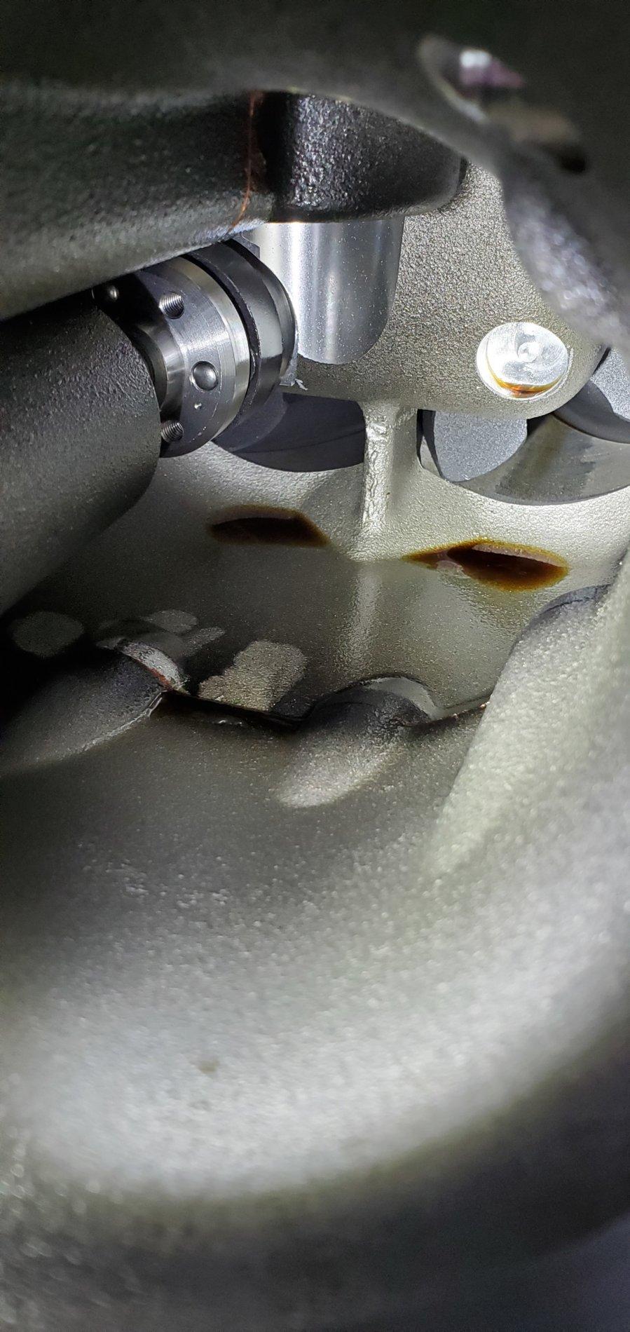

Also I just took the TB off to clean it and I noticed this
Yuck. I can't remember, are you running a catch can? Mine could be doing the same thing with the JLT I suppose...haven't taken the TB off since the dyno tune.
Yeah I do have a UPR can and the PCV lines on both the clean and dirty sides are squeaky clean and dry. No idea where its coming from.
