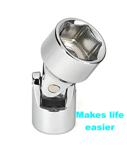

You need one of these, the kind that have the swivel built into the socket. I used the smallest 1/4 swivel I had, the normal kind that still need a socket, and spent like 2 hours tightening those bolt bc I could only get like 1/4 turn at time before having to re-seat the socket. If you get that small one in the pic it will be much quicker
what size is this?

what size is this?
10mm. if you could find it in 1/4 that would be ideal.
Out of interest, if you were to swap the bolts for socket head cap screws, would it be easier (or even possible) with a ball-end Allen key?
possibly. its not really the bolt head size that's difficult, its the clearance above it and to the sides. you'll need an angle extension either way.

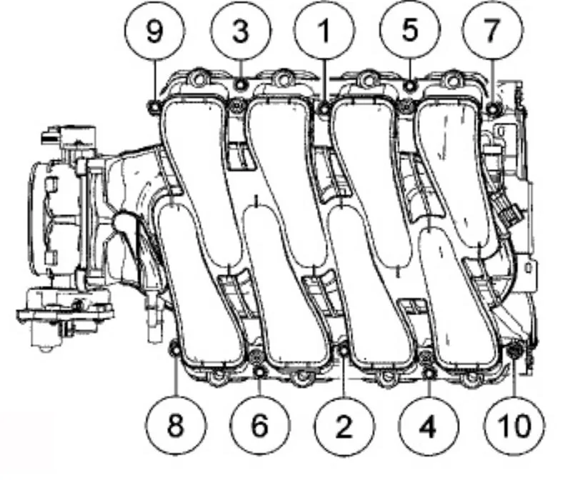

Can you do us a favour and get a pic of the area that causes issues?
Whilst I have a fairly extensive tool kit, I don’t want to find that I’m stuck without the right tool for the job.

1.2.7,10 are the hardest. 1 and 2 because of the interior location, 7 and 10 because of the crossover line between the fuel rails that hangs over them. I personally did it with the “you’ll hate yourself” swivel. It was a PITA, but I’ve done worse. Honestly for me getting the stock manifold off with the connectors at the back was the hardest part, and you’ve obviously already done that.
Thanks for that.
Yup, those IMRC connectors SUCK!
I just took the fuel rail off the intake took maybe 3 minutes total to get out. Pull it way way forward and the connectors come off in a jiffy.
