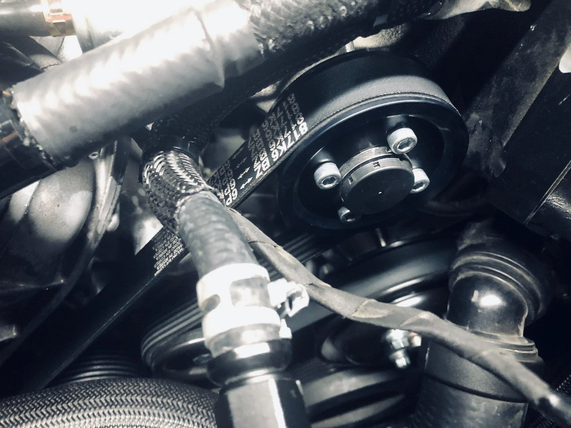

Played with belts, def go off their effective lengths in mm and not inches
817K6 fit the 3” pulley
827K6 fit the 3.25”(820K6 does not)
