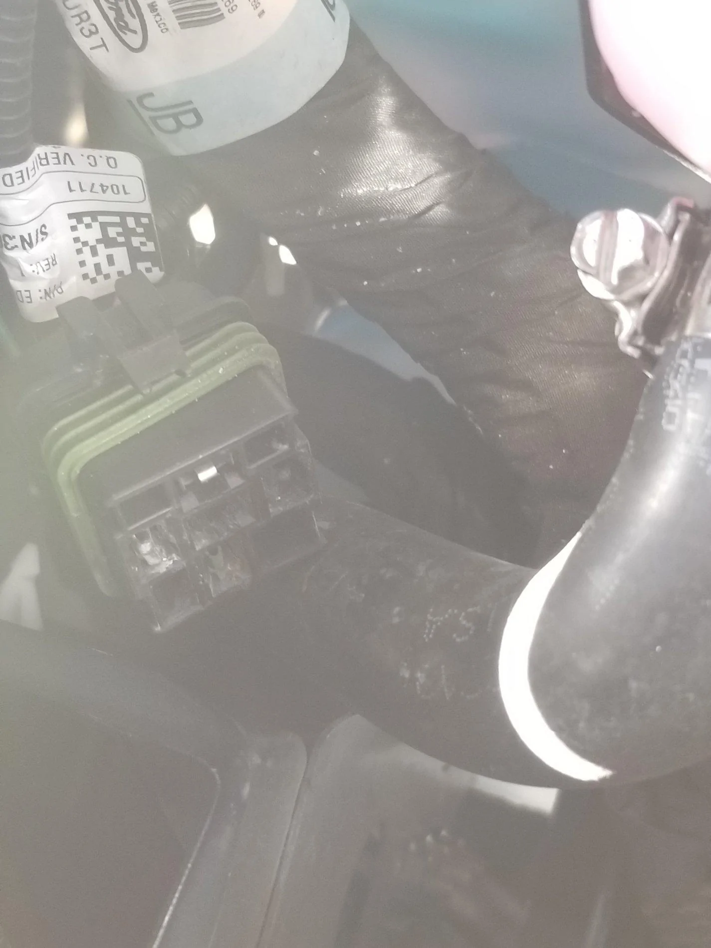

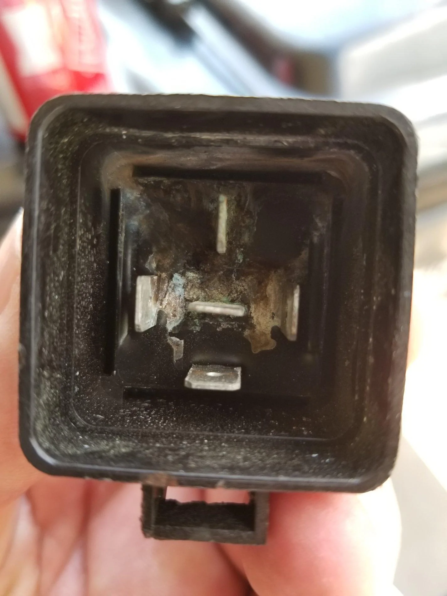

Jeff T.
Jun 11, 2019
Broken Arrow, Ok.
Jeff
2018 mustang gt
Here is my intercooler pumps behaviors:
- Open driver door = pump turns on for a minute or two, will turn off if I do not start engine
- Turn on ACC or engine = pumps will run and stay on as long as there is fluid in the system, if the reservoir is empty, pumps shuts off after 1-2 seconds of running dry
- Turn engine off = pump stays running for a minute or so after engine has been shut off
If your pump is not turning on when you turn engine on, then you need to double check your connection, mine is plugged into the EVAP solenoid. That harness goes to a relay that connects to a stud on the fuse box and a ground behind the bumper. Your pump should not be waiting for operating temp to turn on, it must be running 100% of the time the engine is running, no and if or buts about it. If it's not then that is the reason your IATs get so high, the coolant in the intercooler brick is sitting still soaking in all that heat.
Found it, relay for the intercooler is jacked up...
Thanks everyone for your help
