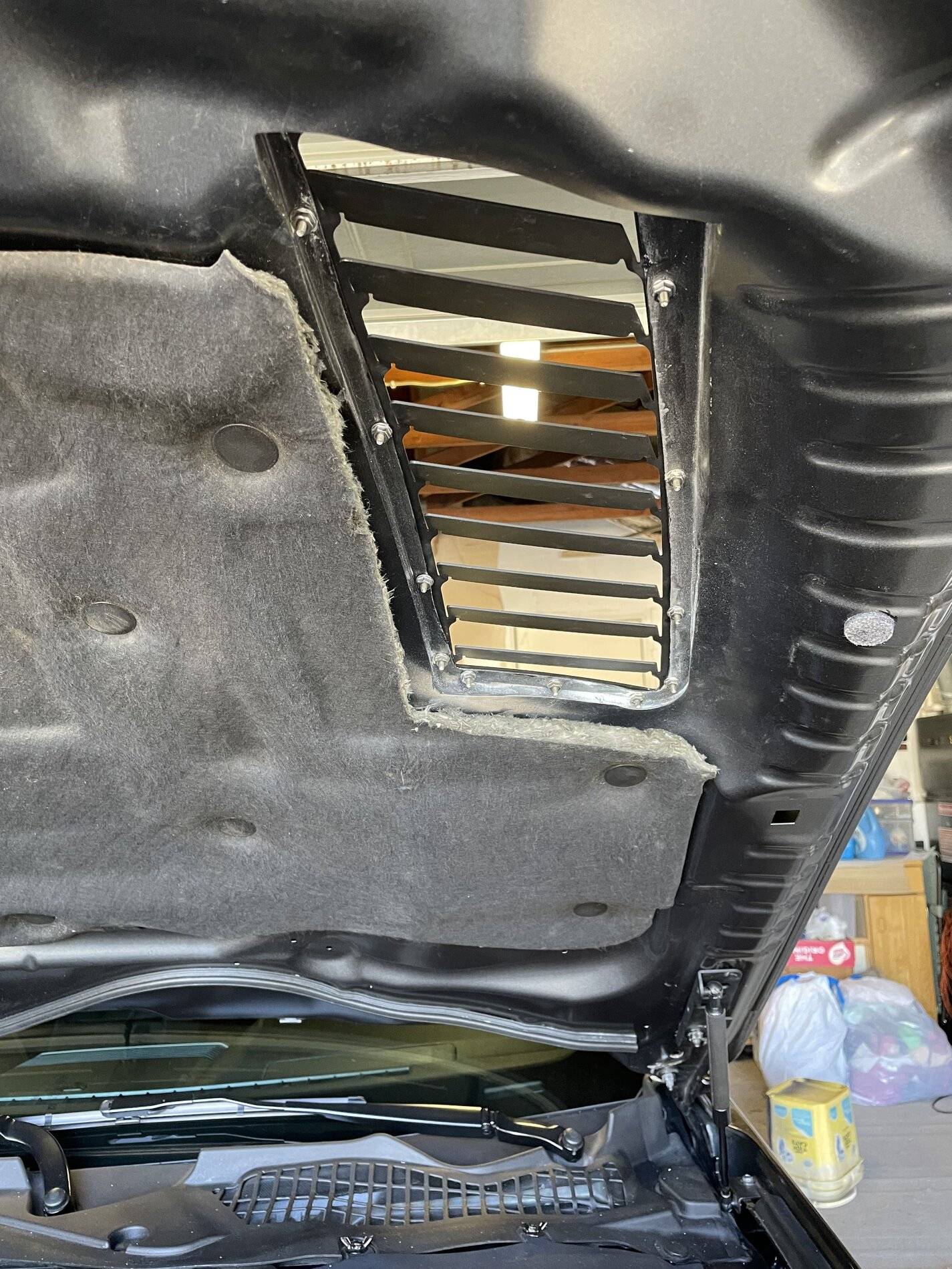

Working to lower underhood heat buildup, especially right above the Airraid box. Verus Engineering heat extractors installed, just trimmed the insulator pad today. Need my edging to clean it up, but of course I can't find it in my garage.... LOL

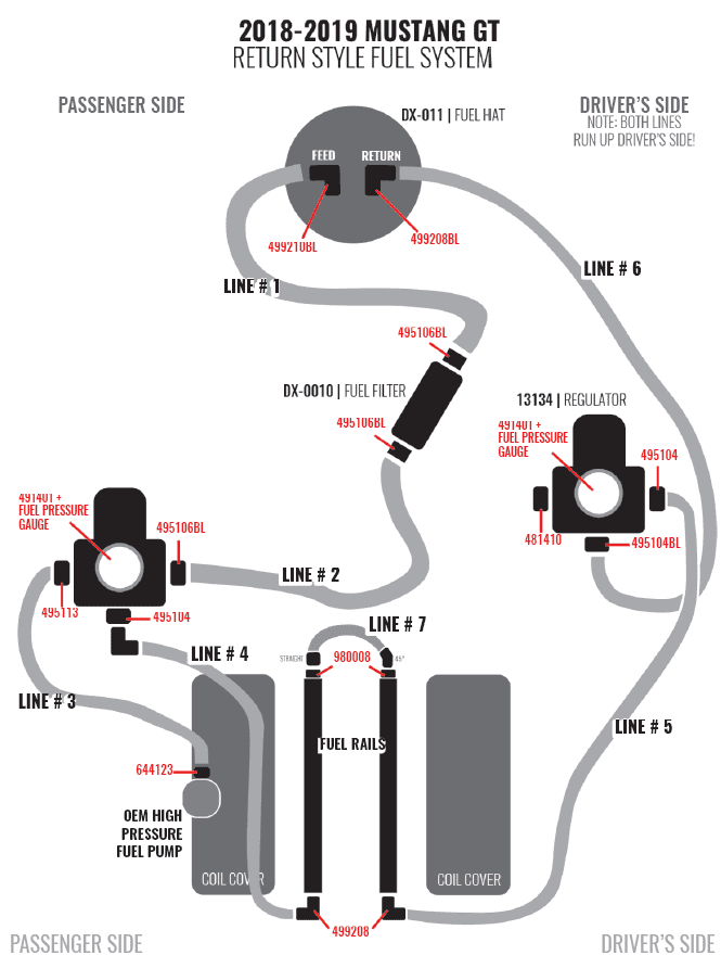

Those of you with fuel systems, do you have a diagram of how the fuel lines are routed? Are you feeding into the HPFP anf the rails from a Y or something else?

There are multiple configurations for the fuel lines, you can do single or dual regulator as well. Pump - Line- filter- regulator- y block to rail - hi pressure tee off of rail this kind of configuration must run 58 PSI base pressure. Anyhow your tuner will let you know how they like for it to be set up and/or you tell them what you bought.
Here is Lethal's Return setup with dual regulators.
I don't particularly like this setup but it does work and it prevents needing to run a dual return/yblock situation.
