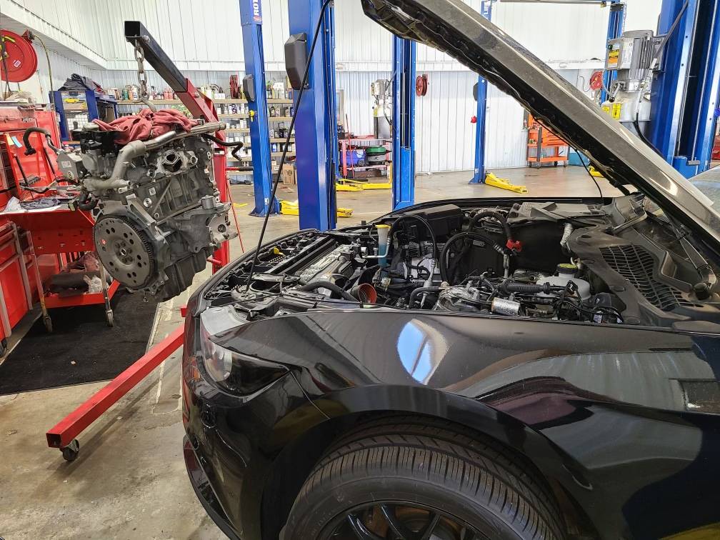

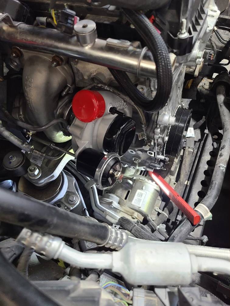

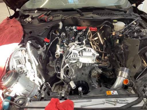

Update on the built motor: engine has been fully assembled and put back into the car. Nx2 turbo and tune plus wastegate has been installed and I believe we are now waiting on the intake manifold and the rest of the bolt ons to be installed. I’ll keep y’all posted
