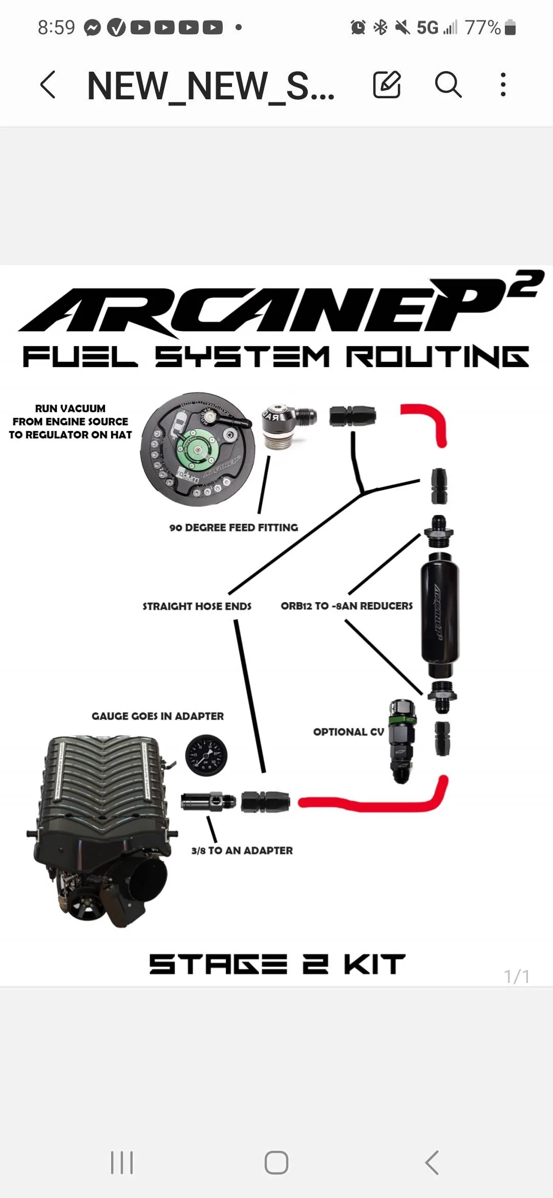

The only down side for me when I went e85 on a boosted car was the increase in powwre
Do you know this kit well?
I have the Stage 2 partially installed on the car right now.

When I look that kit up, it only shows available as a dead head set up. So does that mean it comes with a feed line but no return line? Or is it similar to the Sai Li kit where you use your oe line to feed & the line provided is for return? If you don't mind explaining to my noob self

It's a dead head system. I know guys with this system that run mid to low 9's on full weight cars. North of 850whp on ethanol. It supports way more than that.

Ok cool, thank you! Did you remove your old line or just installed the new one alongside of it?
