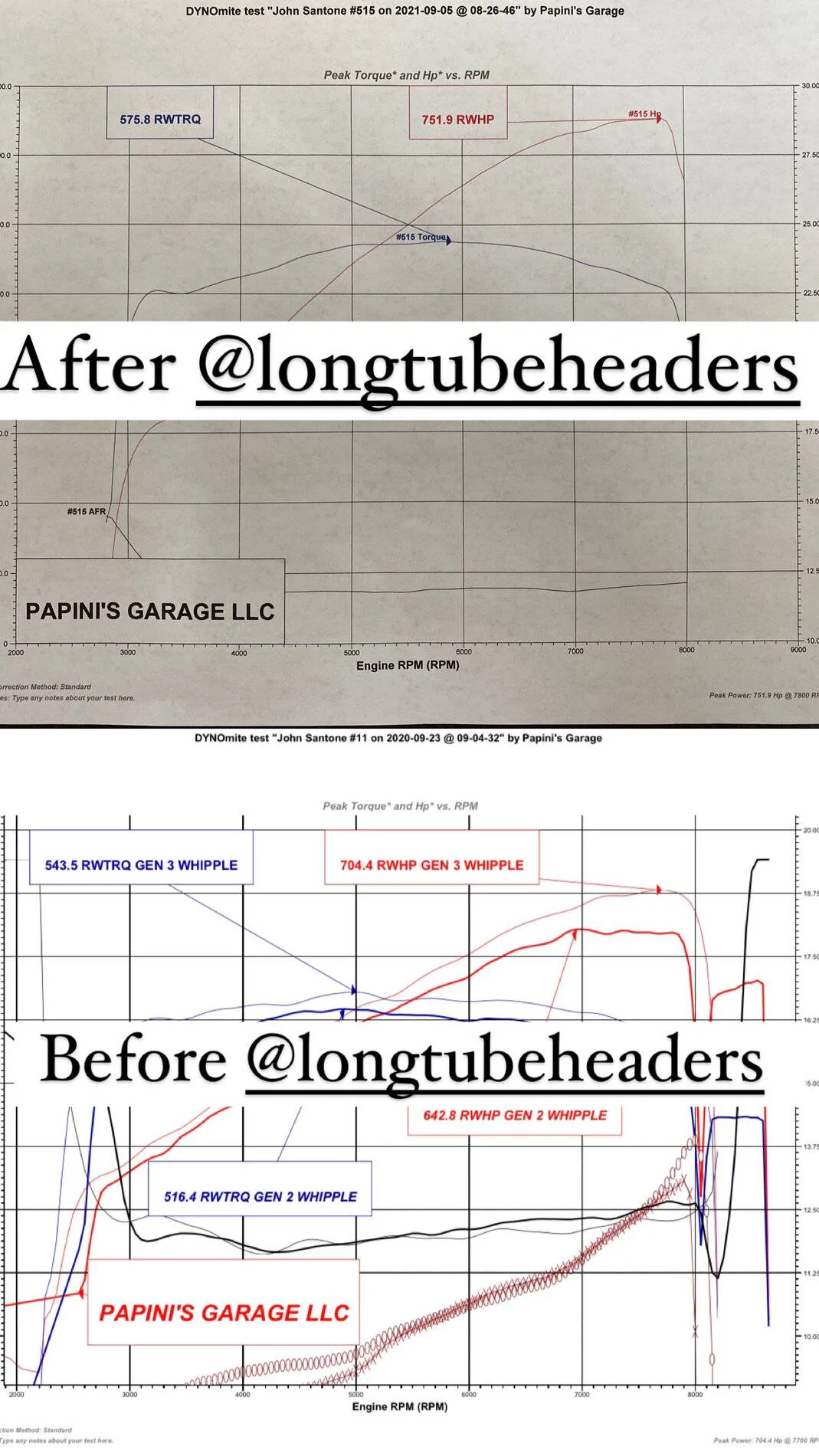

So this was my difference. Close to 50hp and 30tq. No other changes besides the longtubes. But I was going from stock manifolds and cats, so you might not see that much change.
