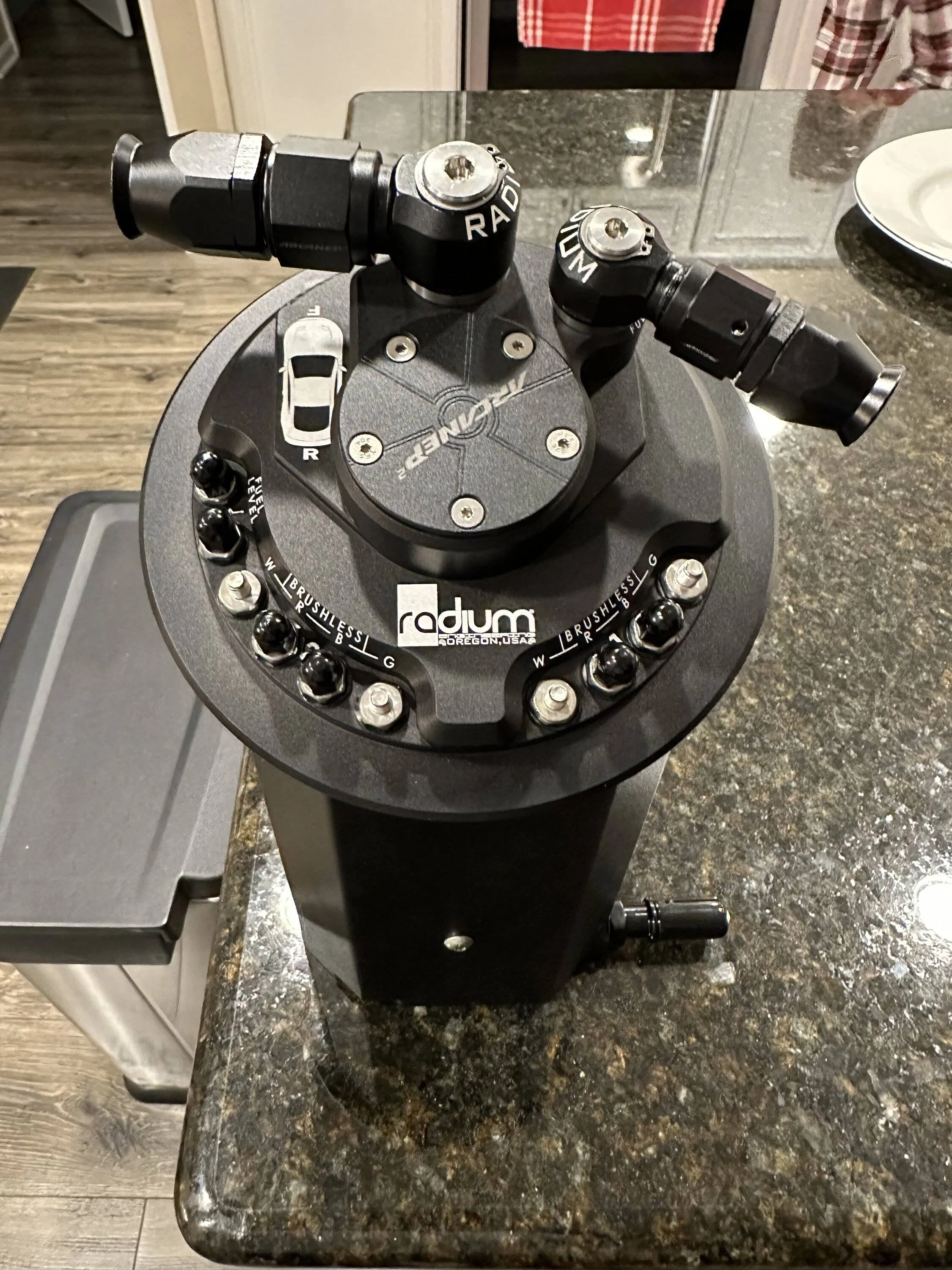

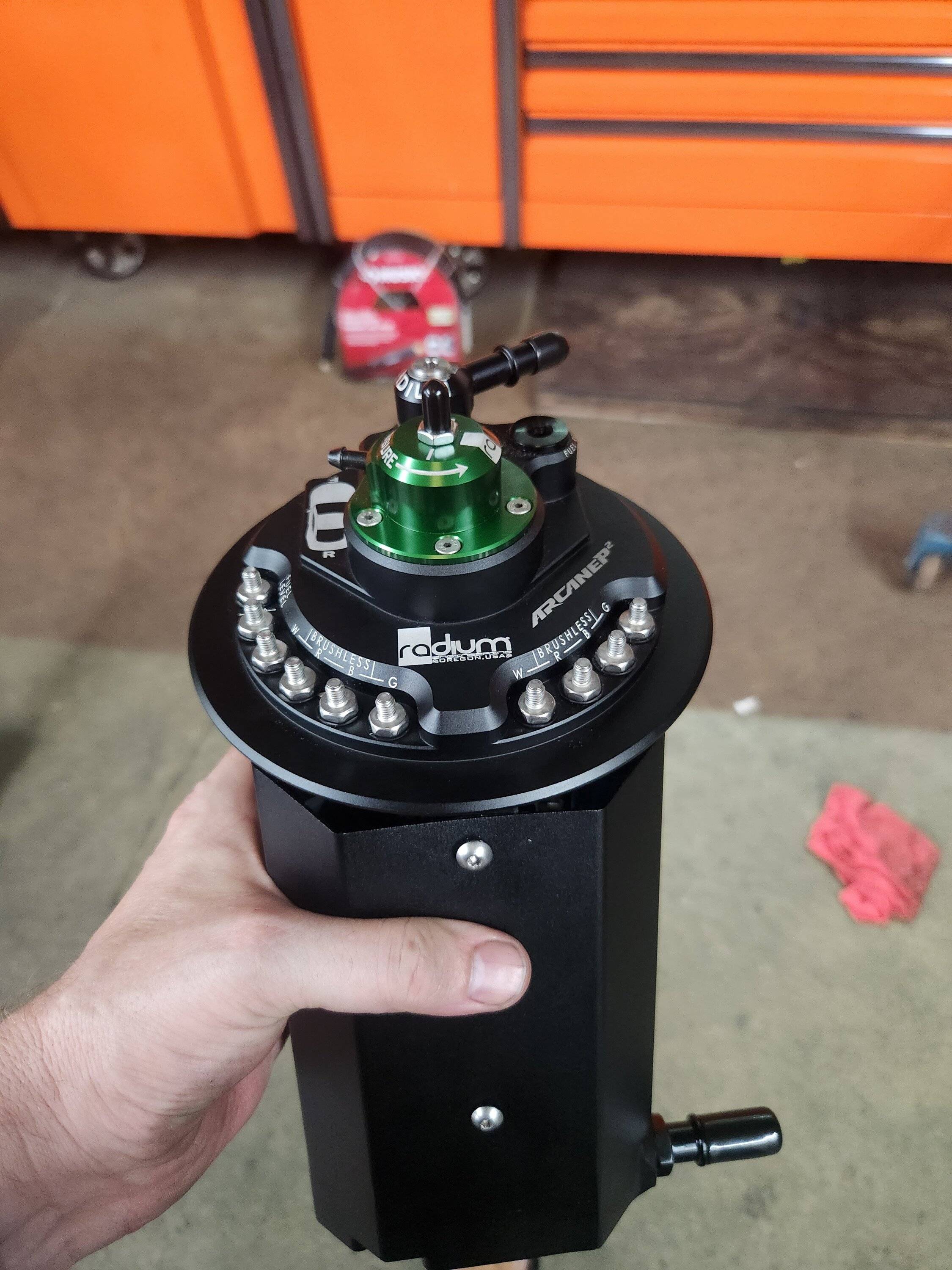

The bucket and fuel hat look bad ass!
That's with the regulator removed for the stage 3 set-up, I believe. I think it looks even better with the integrated regulator still installed.
