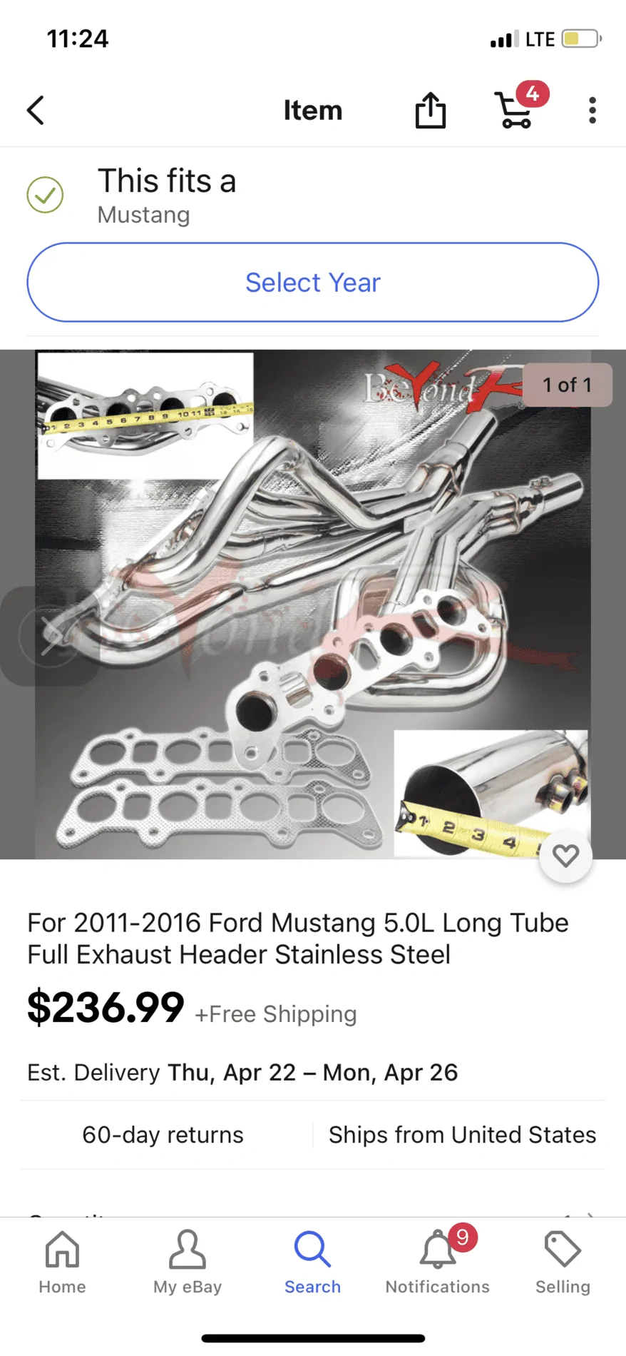

Catless LT vs catless stock header is not going to make enough difference to feel maybe 30-40hp. Everyone compares catless LT to stock headers with the cats. Now that might be up to 80hp but not catless to catless.
Buy a set on eBay for $200 and get the exact same power gain as a $1000 set. The quality will not be as good sure but the engine doesn’t care. Same power 1/5 the price. eBay headers and wrap =$250
No matter where you get them I would get them fast because you just don’t know what is going to happen
