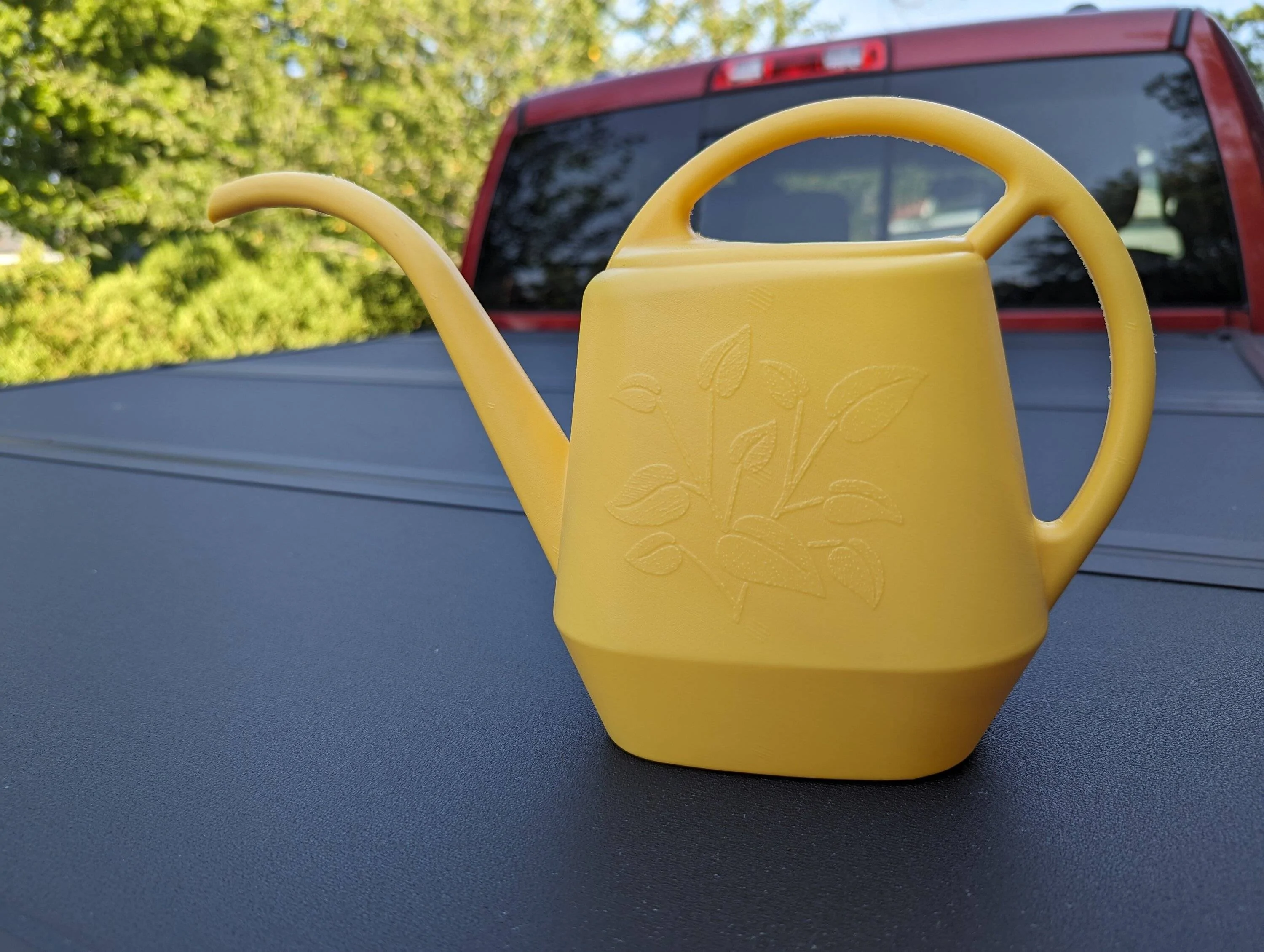

This little container is easy to control and fits in the narrow opening of my tester.
