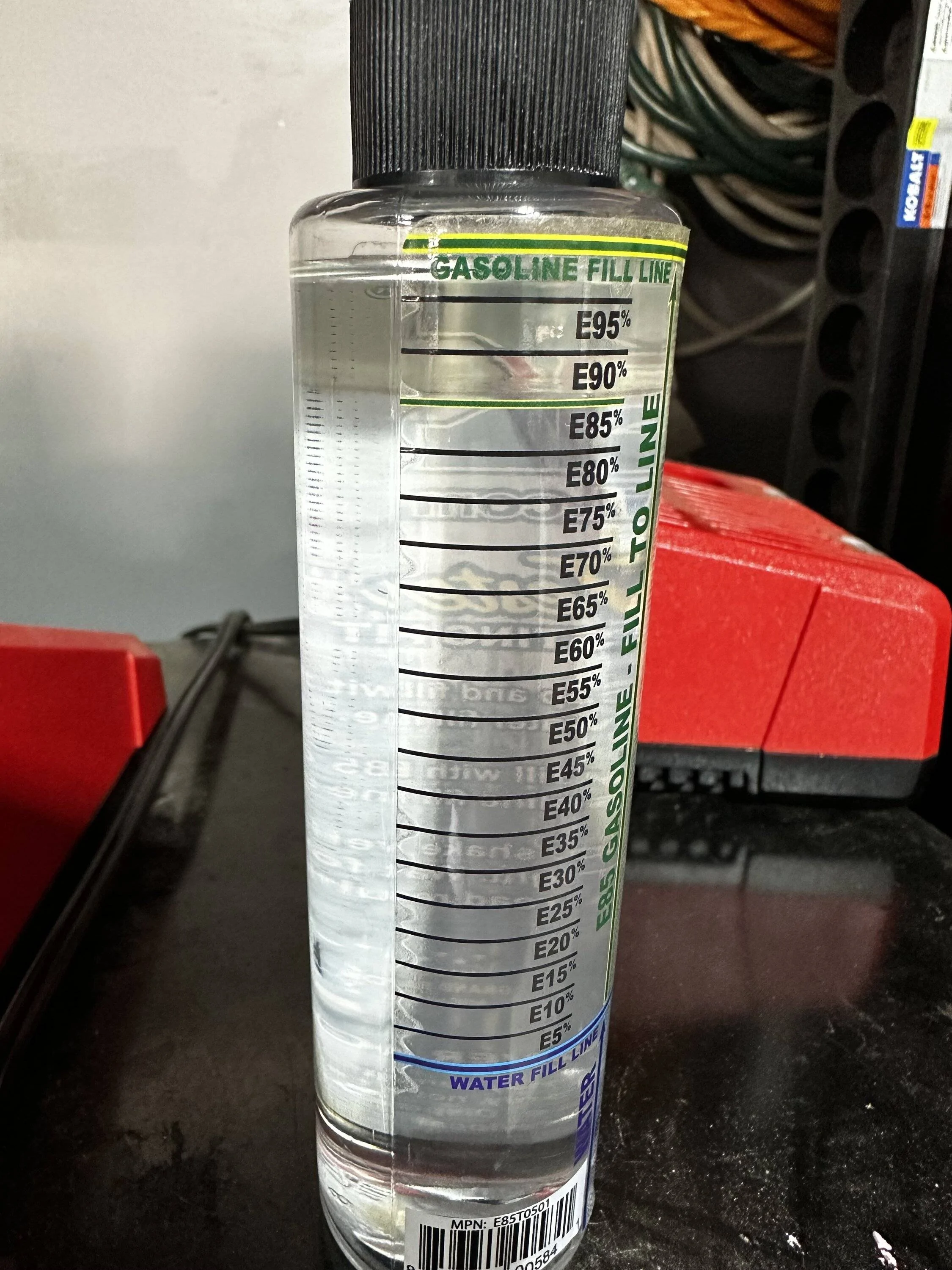

I wondering for those of you who test regularly what is your at the pump procedure? I have one of the small bottles I fill to the line with water but am still trying to figure out how to discretely and with out spilling fuel all over me and the ground add a little to the bottle to get it right to the fill line in order to get an accurate test result. Forget about modulating the pump handle, most here are all on or all off. Do you bring a cup or something to put .25 worth in to test before committing to a tank full? A eye dropper? A post I saw online recently of a guy getting a tank full of E15 from an E85 pump has me wanting to test more often.

How many ml syringe? I would typically bring the testing bottle already filled to the proper level with water. A giraffe bottle for the fuel is a good idea, just need to know how much fuel is needed. I was thinking a 10ml syringe woukd do it but looking at this test bottle I think it’s a good bit more than 10ml. Do you use single use syringes or do they hold up to fuel and can be reused?

I mean, I can't tell how many ml of gas your tester needs. I reuse syringes.
