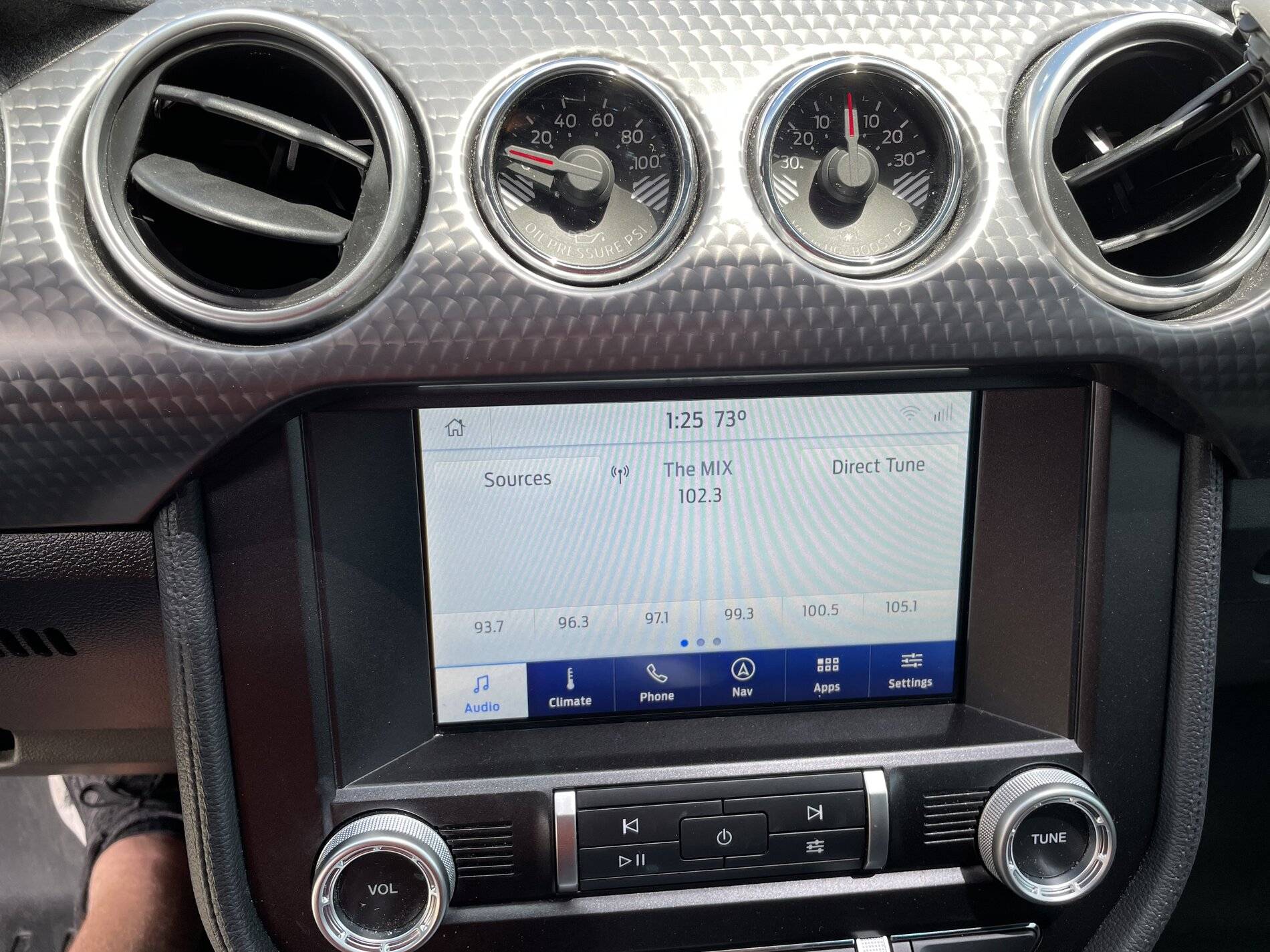

I have a 2021 Mustang GT Auto PP1 with a Roush supercharger. Since it has the analog vacuum guage, he Ford folks thought it unnecessary to enable the digital vacuum guage which is perfectly placed in front of your eyes. I replaced the analog vac guage with a vac/boost guage. I'm trying to use Forscan to turn on the digital vac guage and hopefully vac/boost.
I have an OBDlink EX cable. I can connect, It sees the IPC, I can read the module and it says vacuum guage disabled. If I try to enable it and and write it, it goes to 73% and stops saying service procedure interrupted and reverts back to disabled. So have a bought boat anchor software?

I have the same. Its on a bad angle for viewing. My 13 GT 500 had it right in the same place the 301A has the digital gauge display. Its the perfect spot. Cant understand why they couldnt even leave the vacuum guage enabled? It costs zero.
