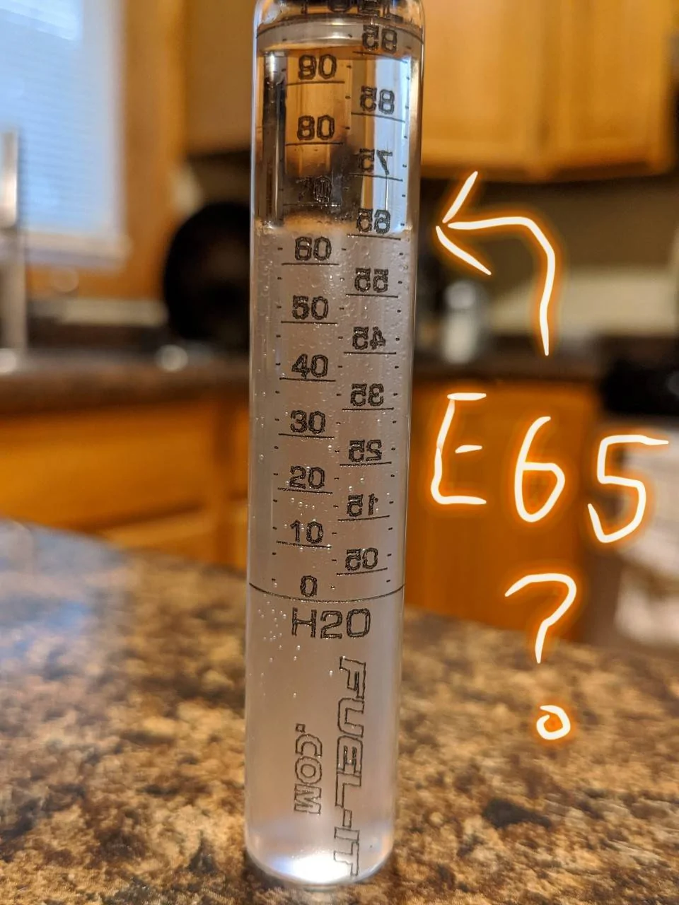

Speaking of ethanol content...
My nguage has been reading in the 90 to 91 percent range for the last 4 tanks. On my last fill up, I brought a small gas can to take some home to test. A manual test of the fuel revealed that it is actually e65. This particular tank was giving an nguage reading of 90.
So my question is, am I going to damage anything by running the car with e65 when the tune seems to think its got e90? I'm worried about running too rich and messing something up. IE, getting too much fuel down the cylinder walls over many thousands of miles in the future?
Also, does anyone else find that the nguage won't post the learned alcohol flag unless they actually drive? I've let the car idle for 30 minutes and it would not learn after a full up, even with some deliberate slow revs. Only after driving for 5 minutes or so will it learn.

Honestly, you really don't need to care about alc learn %. It doesn't matter. Just get it out of your mind. The car still has adaptive learning. Look at your measured AFR and lambda actual at cruise, idle and WOT. You should be able to see if something is off. Sometimes it just doesn't learn to correct %, but it's just an inferred value anyways. You don't have an ethanol sensor.

Are your running the stock air box? If not that might be part of why its not dialing in the correct alcohol %. My jlt is usually pretty spot on but thats not always the case. Sometimes randomly its way off. The flex tune ramps up timing slower and will adjust like stated above so you should be alright. Personally i just stick with my e85r or e54r tune so im not waiting around for it to learn constantly. I only switch to flex if I have to run 91 for some reason.
