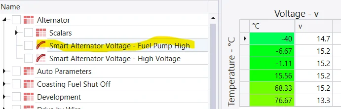

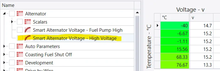

In either case, I'd happily take you up on your offer to adjust the fuel pump voltage (presumably through the FPDM) versus adding another piece of electronics to the car.
Here's the short version:
This is the max voltage it will send to the pump. Stock is 12 ot 12.5. This will also prevent BAPs from using their full potential.
This is the max system voltage:
This is the command voltage at "high fuel flow":
These should be modified as you see fit with your own thresholds to get the behavior you want:
As always, it should be logged to make sure it's doing as intended. Some tuners run 15.2 volts all the time, which I believe shortens battery life. I haven't found a reason yet not to change this to where it only increases voltage during high fuel demand situations.
